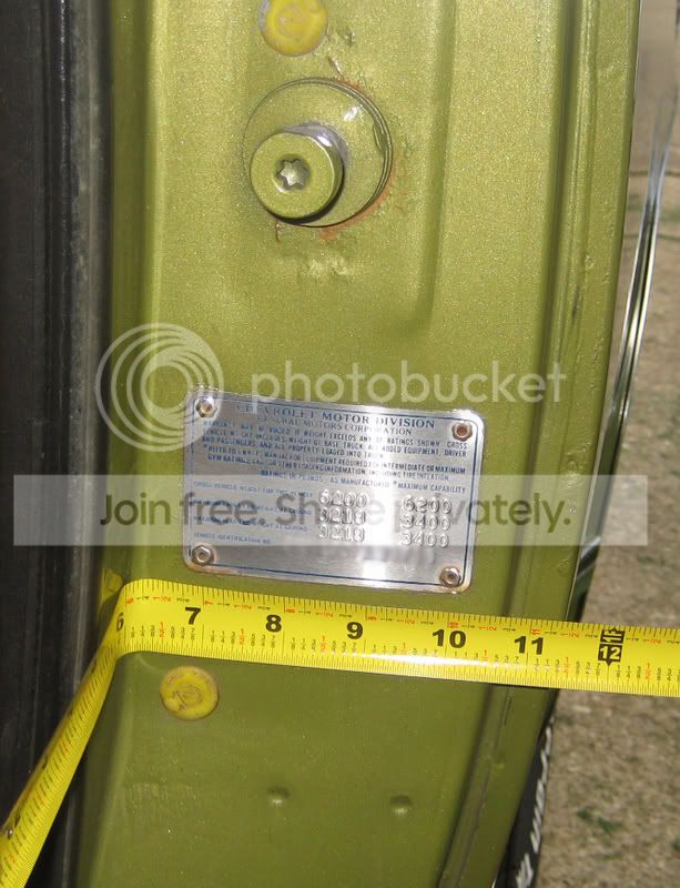

Here's what the vin plate looks like on my '73. A '74 plate should look just like this.
the vin plate was in the same place as my 85. He probably found one without a title and used his old title. I didnt pay much attention to anything once i saw that it was not full convertible. Thanks for the confirmation guys.
