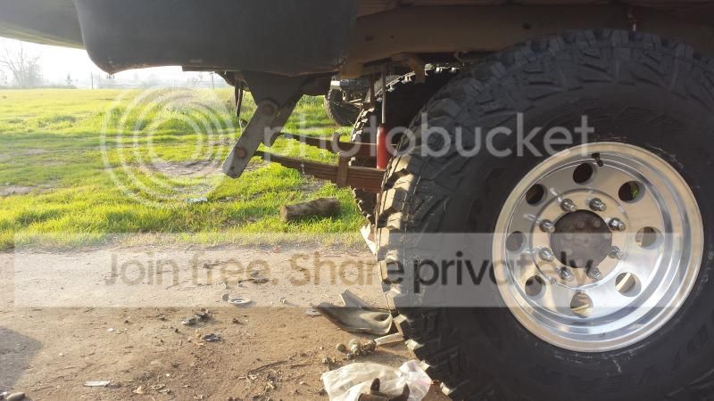

Just to help everyone out:
Shackle angle seems good, I wouldn't bother moving the shackle hangers

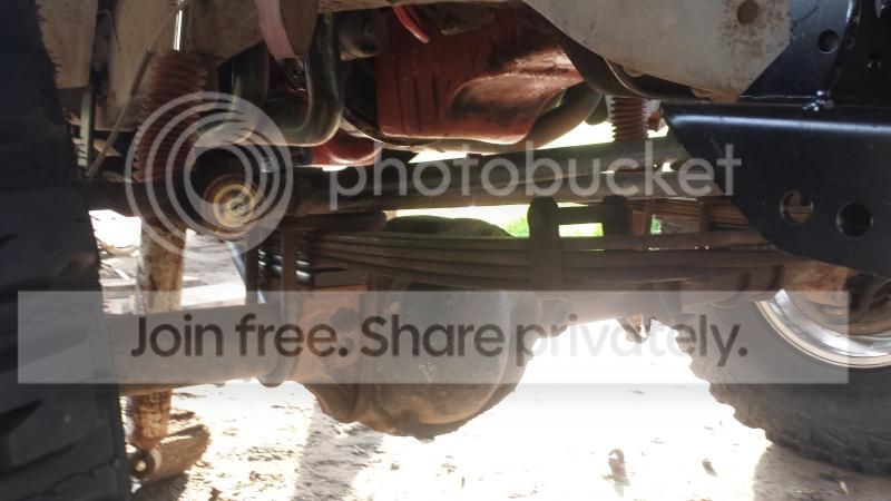

so had everything installed an works good flexes good and ride a lot nicer than with the 6 inch lift springs.
guess my next question is to run bump stops or not?
my stops would be really close to the spring because they or so close to being straight already.
