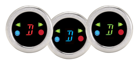

There is a wrinkle in that the factory gear indicator apparently doesn't play nice with these dashes. Since I kinda like knowing what gear it's in, I'm now looking at Dakota Digital indicators. So much for doing my homework. :doah: 'Sokay, I'm tired of replacing the string in the sliding indicator.
And their sending unit.. all these sending units! This poor truck is gonna have all kinds of electric stuff on it 'fore I'm through... :doah: [She's old enough to have a mechanical oil pressure gauge, and of course the mechanical speedo, you see.]
-- A
I like the bottom one over the oval one. although the cool part about the oval one is if you don't want to use the LED Blinker kit I sent you, it has built in turn signal indicators, High beam and parking brake indicators.
Let me know if I can do anything else for you. I will see if I can get them cheaper for you rather than paying full price again.
