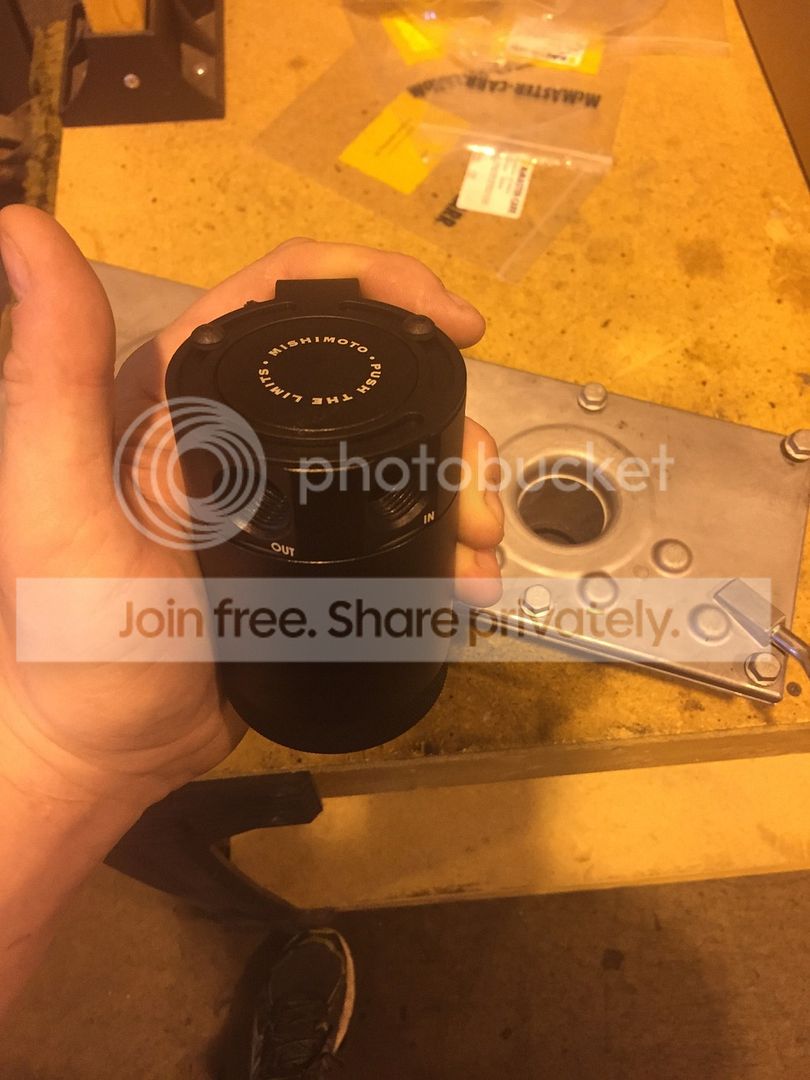

I was getting a lot of oil from my PCV system into my intake manifold so I tried disconnecting it and adding a breather in the valve cover that still did not work so well. So i pulled the intake and cleaned everything up really well.
I am adding a LS6 Valley cover that has the PCV valve in it to allow me to draw out the crankcase fumes where there is less oil splashing around. I will route the PCV line thru this catch can
This should catch any oil mist that happens to make it thru. I will run the line to a port between the throttle body and the inlet to my supercharger which is a region that should have vacuum under most engine operating conditions.

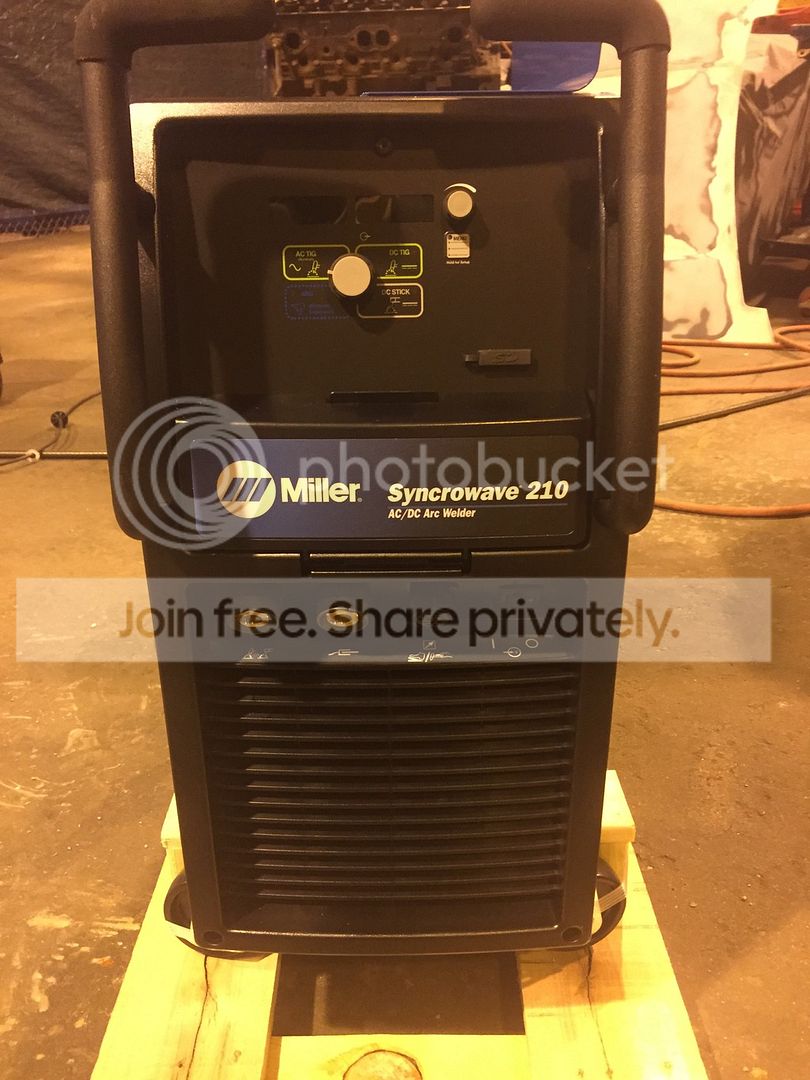

I also just picked this up, which means I will be able to weld some fittings to the valve covers to run beaters off of for the fresh air intake to the crankcase

I really hope the TIG works well when I get it back. I plugged it in and it would not even strike an arc, contacted miller and they had me send it in for service, nothing like a brand new TIG that is dead out of the box :frown1:

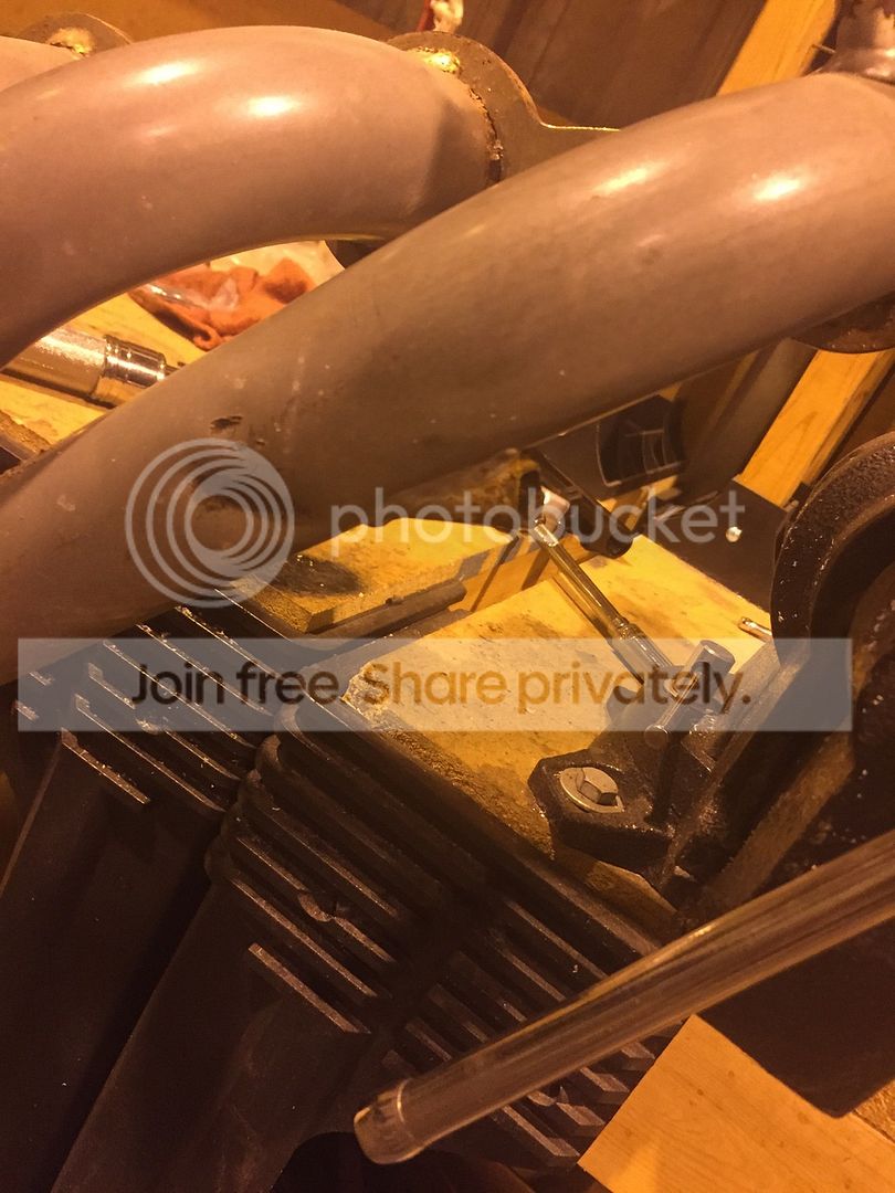

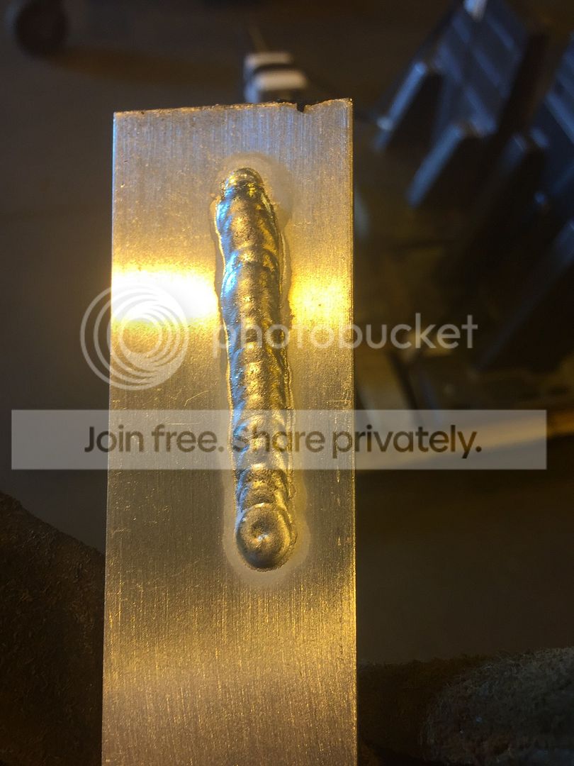

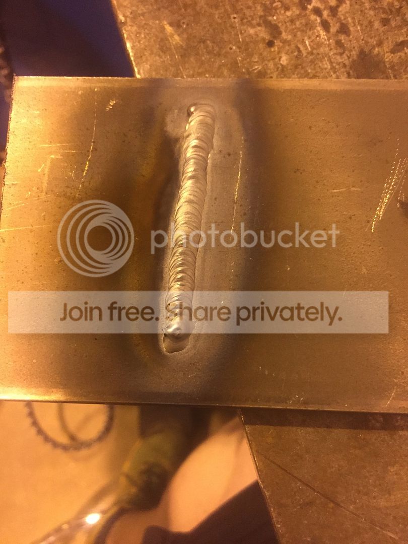

Got the new TIG and started practicing

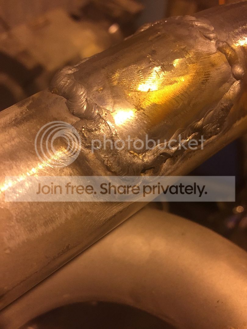

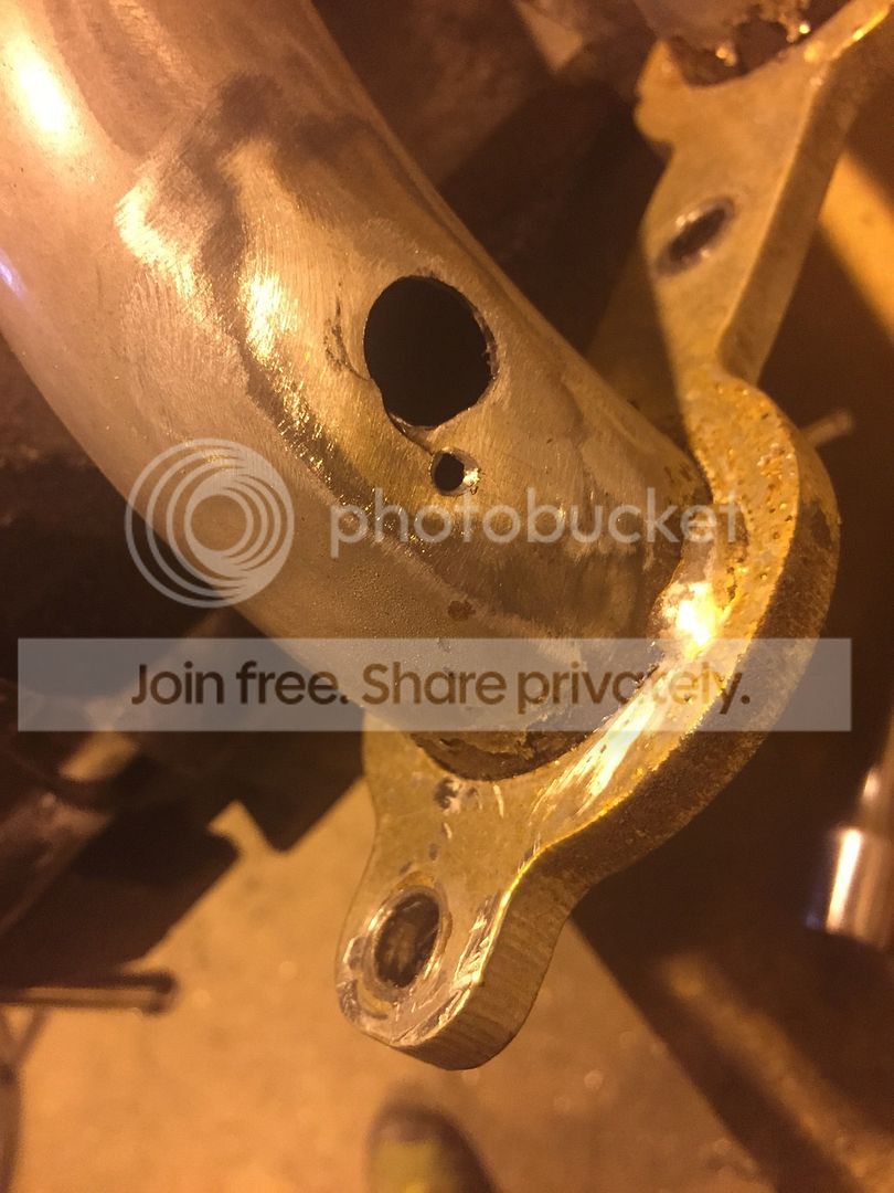

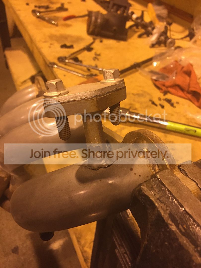

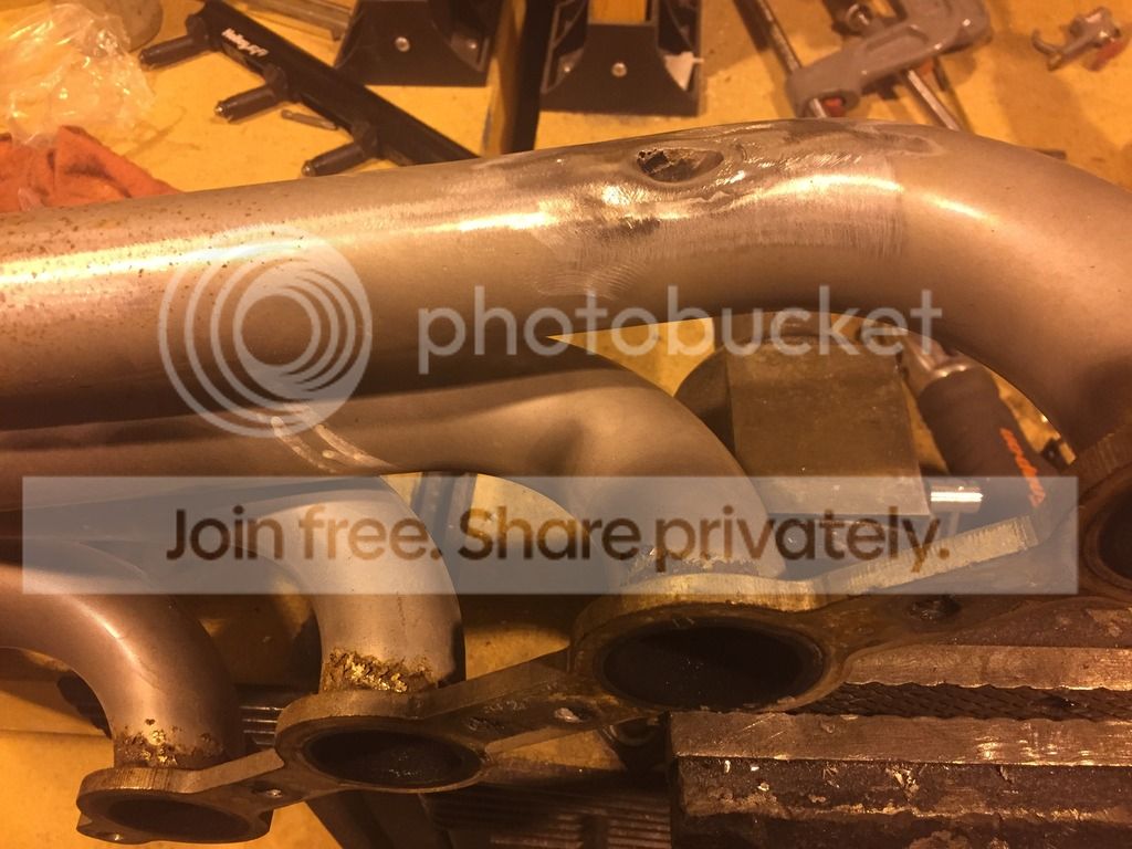

the 1st thing I had to TIG on my truck was the hedders. They are out of a F-body so they have EGR ports on then that were blocked off. Well one of the flanges on the port broke off and caused a lot of noise. So I pulled the hedder to fix the hole and decided to cut the other one off and weld it up too as it had a crack on it and would have failed soon.
I made sure to drill the end of the crack so it would not propagate further.
Here is the patch that I welded on the lower EGR port

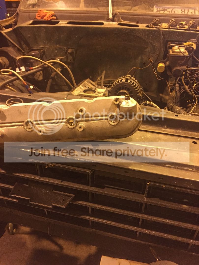

As part of redoing the PCV system to better handle boost I am adding a breather to each valve cover for clean air to be drawn into the crank case. Rather then just use slip on hose I wanted to Use AN lins so I welded -6 AN Fittings to each valve cover

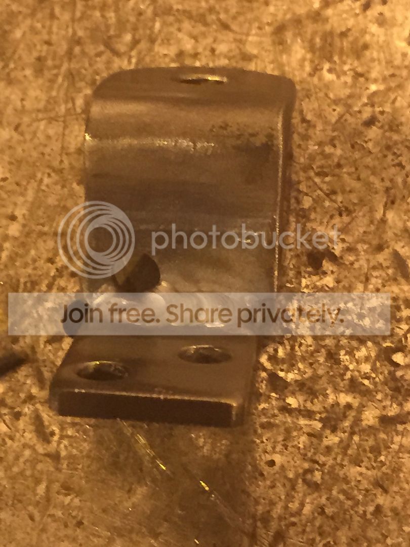

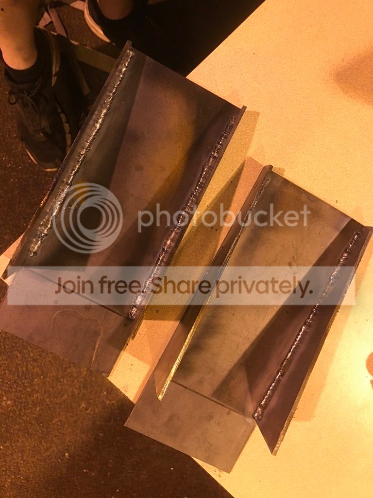

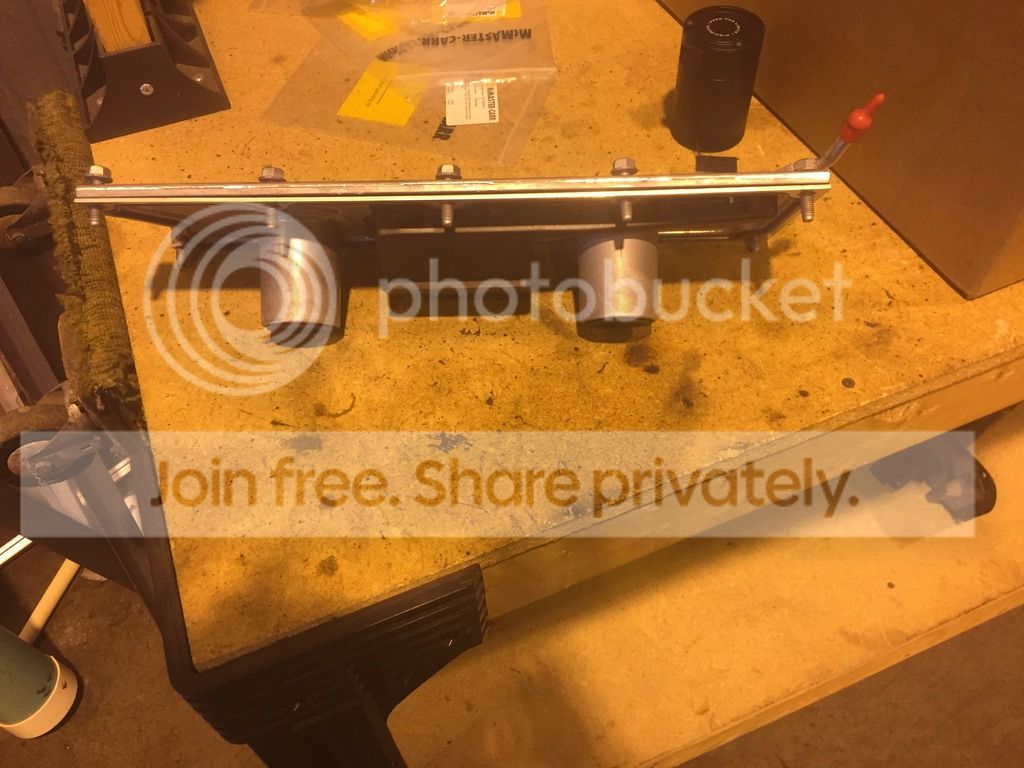

I decided to upgrade to aftermarket fuel rails. well the Brackets they came with work on cars or on the trucks with stock injectors. Well I am running the tall body 60lb/hr injectors so neither of the brackets worked for me. So I took the two types of brackets and made a set that worked for my application

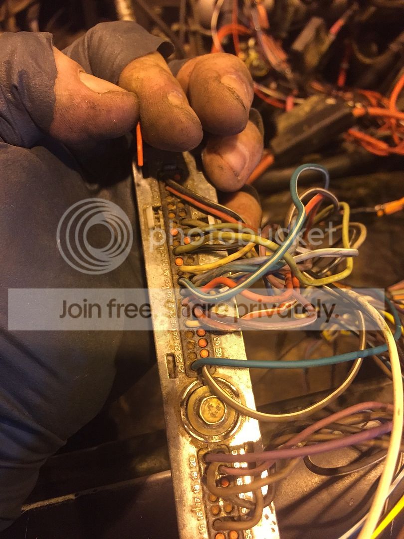

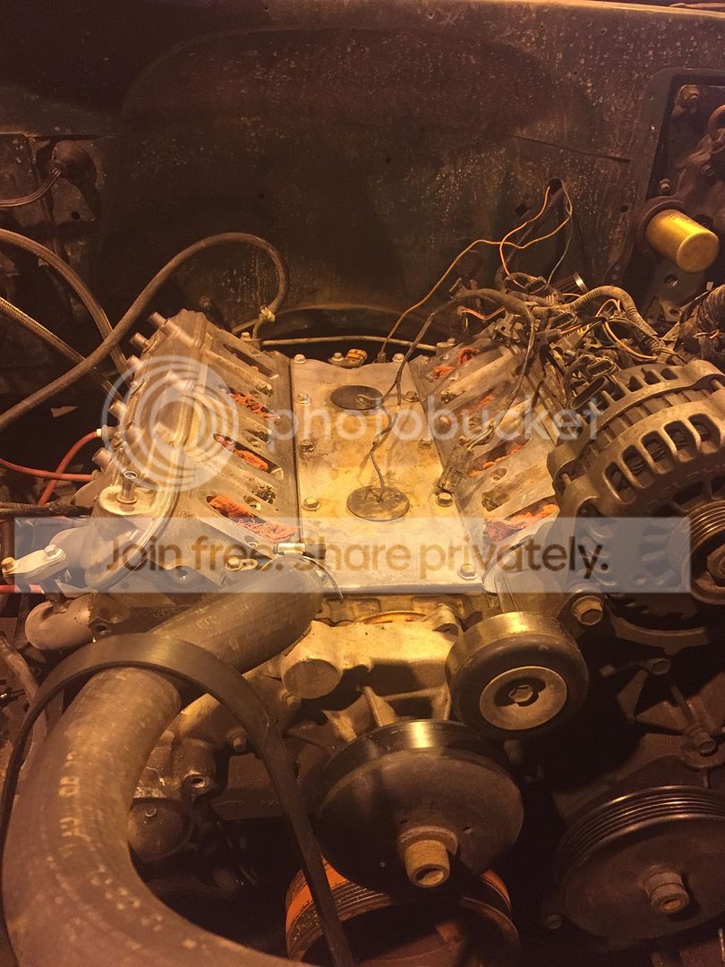

I also took the opportunity to redo some of the wiring in the engine bay, I have learned a lot about wiring in the years after I did the swap and now have access to a lot more wring items.

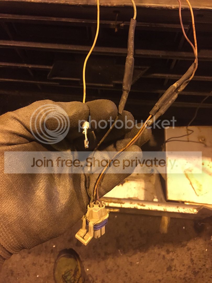

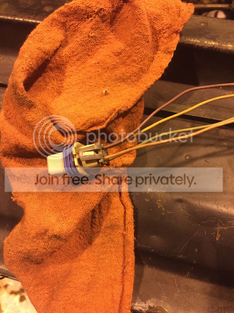

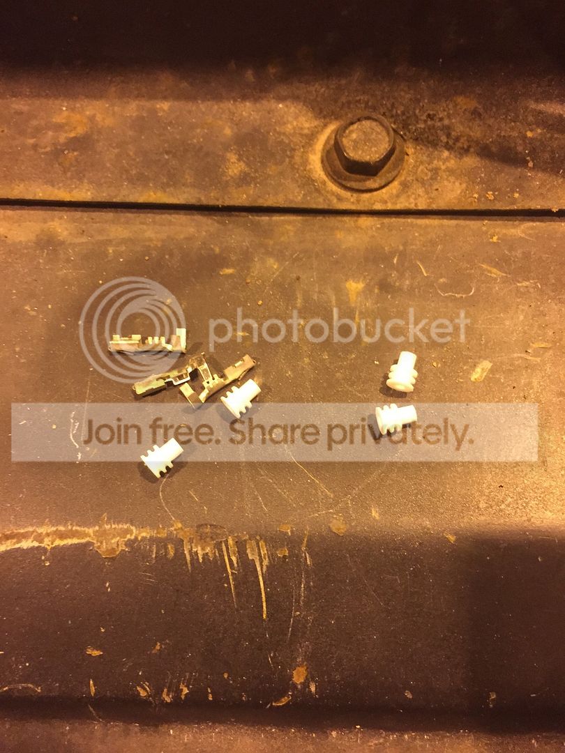

One of my O2 sensors had the wires cooked a while back and I had repaired it with a splice, well that is not the best way to do it and I had some length to take out anyways. I cut down the wires and put new cable seals and terminals on the wires
Here it is all done :D
As part of the rewiring I decided to shorten a lot of the ECM wires that were to long, and also added cavity plugs to the spot were I removed unused wires. Most people overlook this detail on a LS swap but its important as on this style connecter when you put a pin in you puncture the seal and have to have a plug in the hole otherwise the connector wont seal out water and dirt.
After I completed the wiring I put is all back together and only ran into a few small issues. I had intended to convert to a flow thru fuel rail system rather then a return less rail. Well with the tall injectors and aftermarket rails I ran into a clearance issue with my blower, this made it so I had to stay with a return less style rail setup, I am hoping this wont affect my fueling to much.

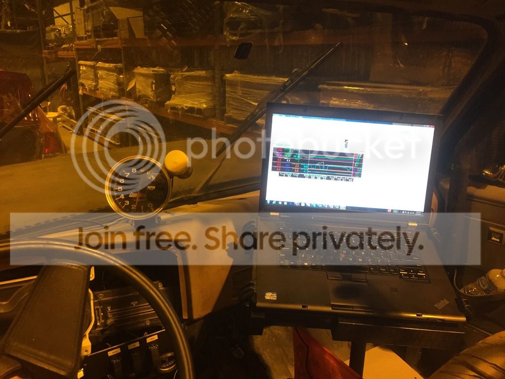

After all that The truck was ready to do some tuning on it so I installed a RAM laptop mount and hit the road

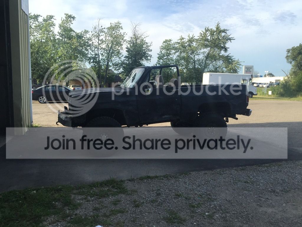

Well figured its time for an update, after sitting for a while i pulled the truck out and finally fixed the clutch slave cylinder and swapped to the 12 bolt hummer rims i bought a few years ago.
I discovered the best thing to do when dealing with hummer rims is run tap thru the nuts and a die on the studs it makes assembly and sealing of them so much easier

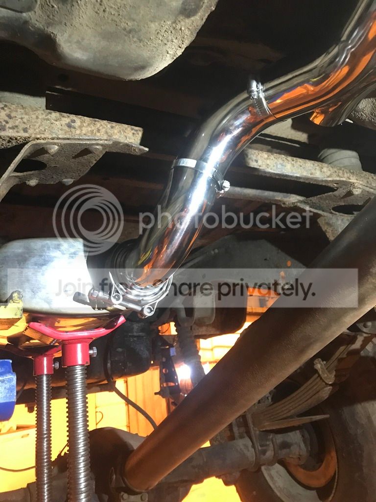

Well the exhaust that i had on the truck was a pair of flowmaster 40's they were rusting, and just did not give me the sound I was looking for. The rest of the exhaust was in poor shape and rotting away.

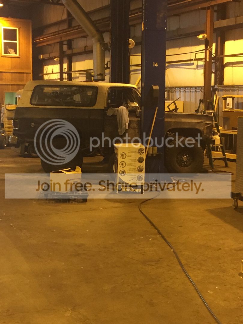

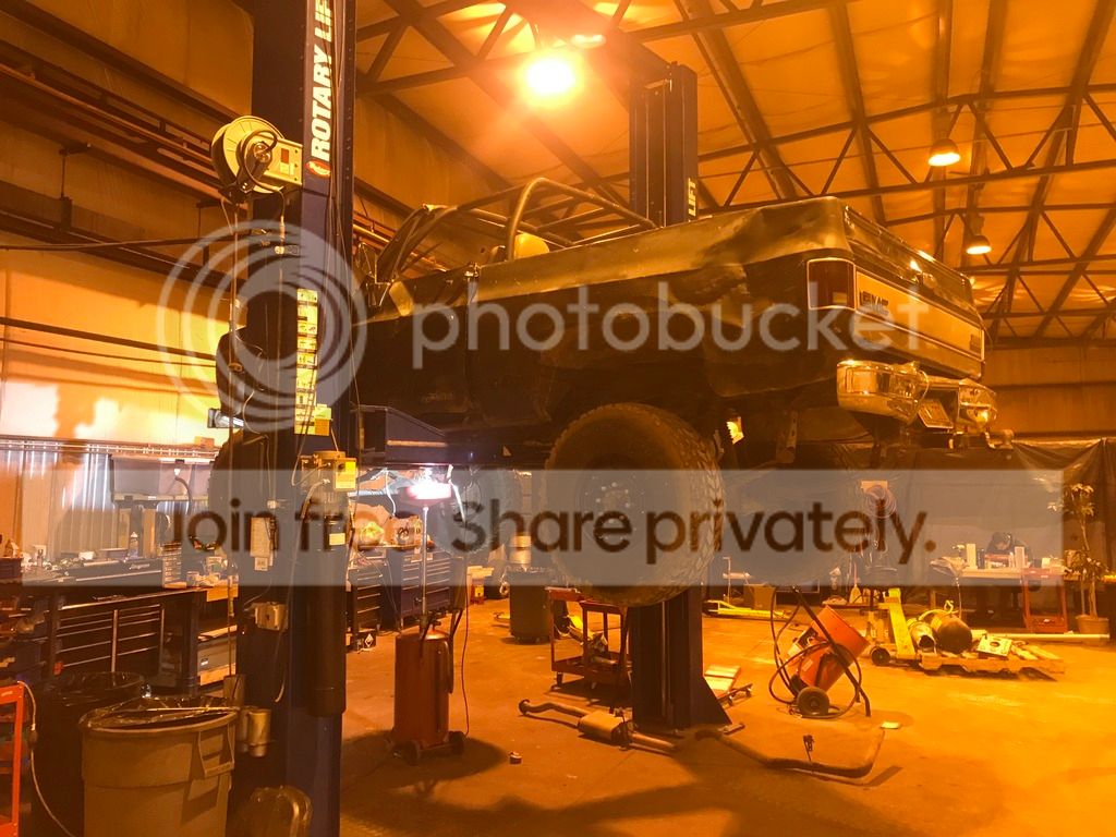

So i hauled the truck to work to give it some TLC in prep for a wheeling trip in Aug
Drained all the fluids (diff's tcase trans engine)

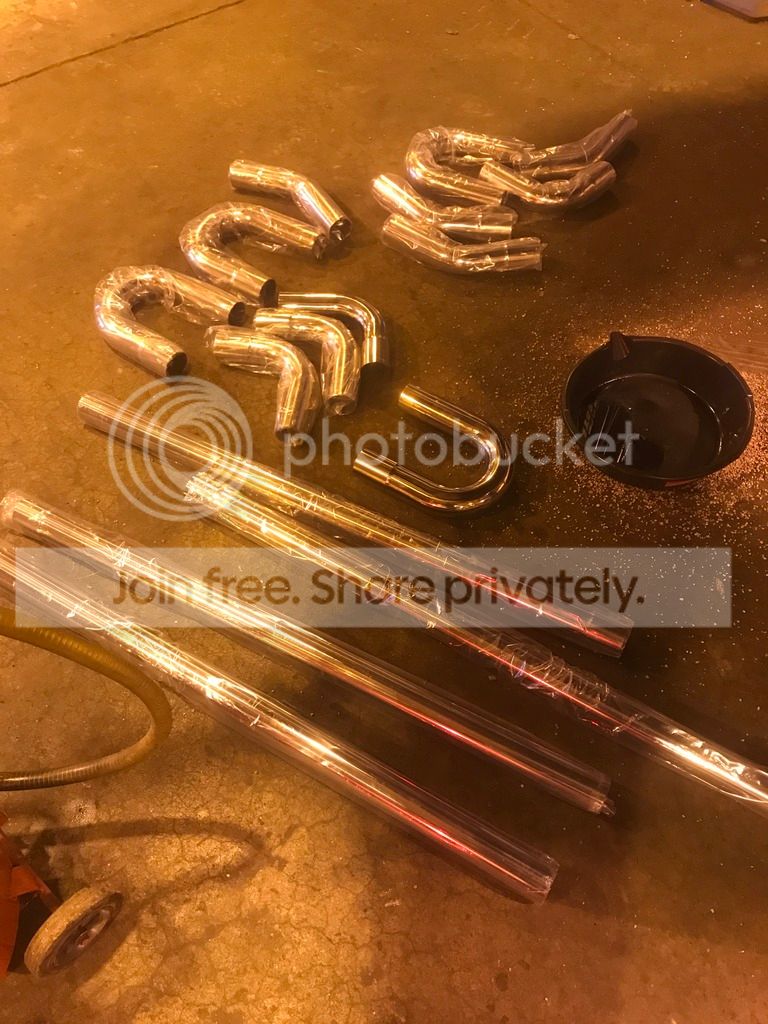

I shopped around a bit for exhaust kits and settled on this one from summit. I did not need the polished stainless but this kit was cheaper then all the other 304 stainless kits i found. Its only 18 gauge vs most others are 16 gauge.
As part of the exhaust redo I am adding this to the system, hoping it will give me a better sound and maybe a little more power :)
I went with a set of magnaflow stainless mufflers they were a "used Item" on amazon so only $30 each, the box's they came were trashed but the mufflers were just fine.
I added V Band clamps to the mufflers to make servicing the exhaust in the future a little easier

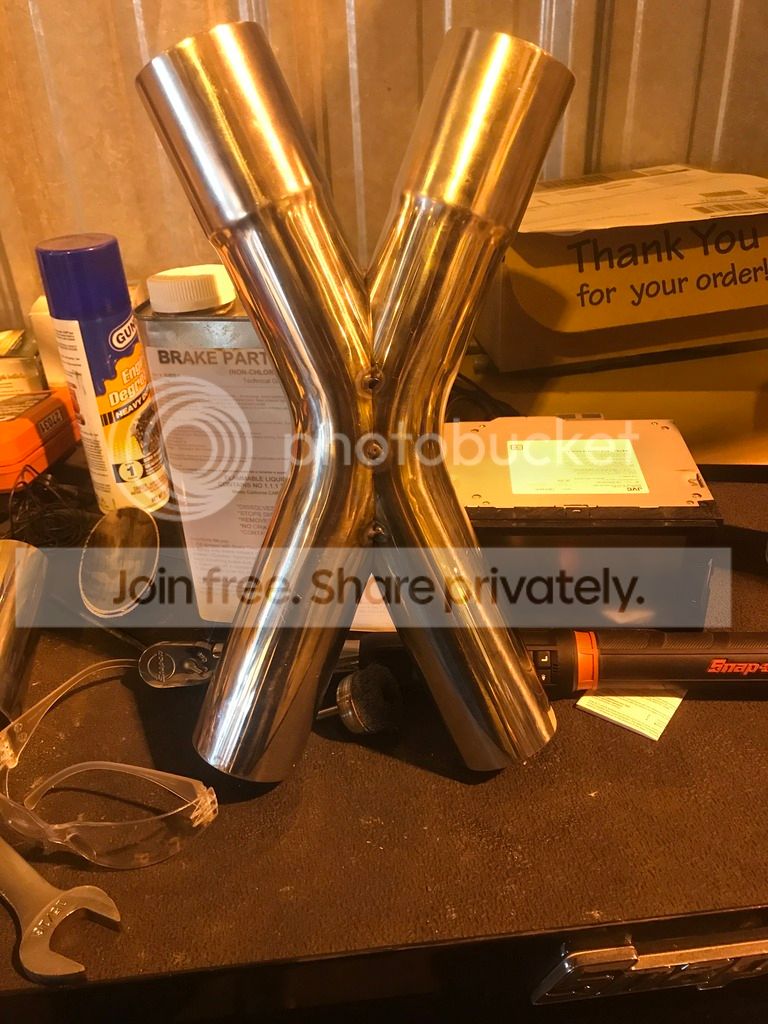

Adding the xpipe was a pain it really complicated the routing of the tube and used up a lot of my U bends lol
I have the front half of the exhaust done and am doing the final welding on it, I still have to do the rear but had to go to China for work for a few weeks so that delayed things a bit.

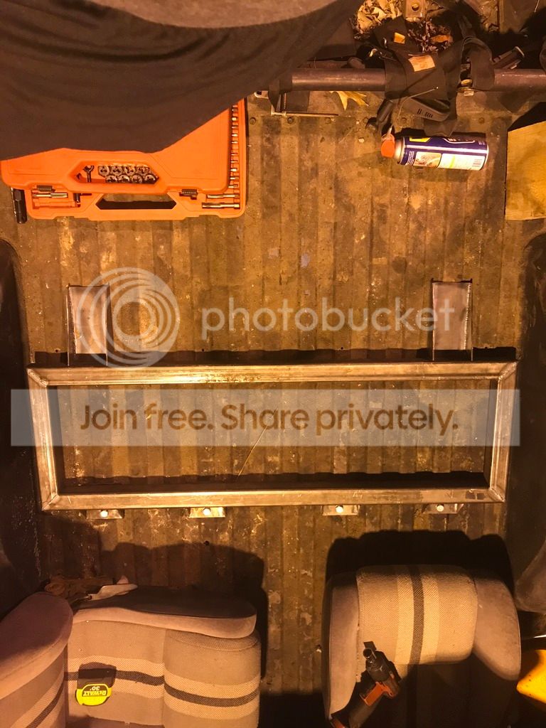

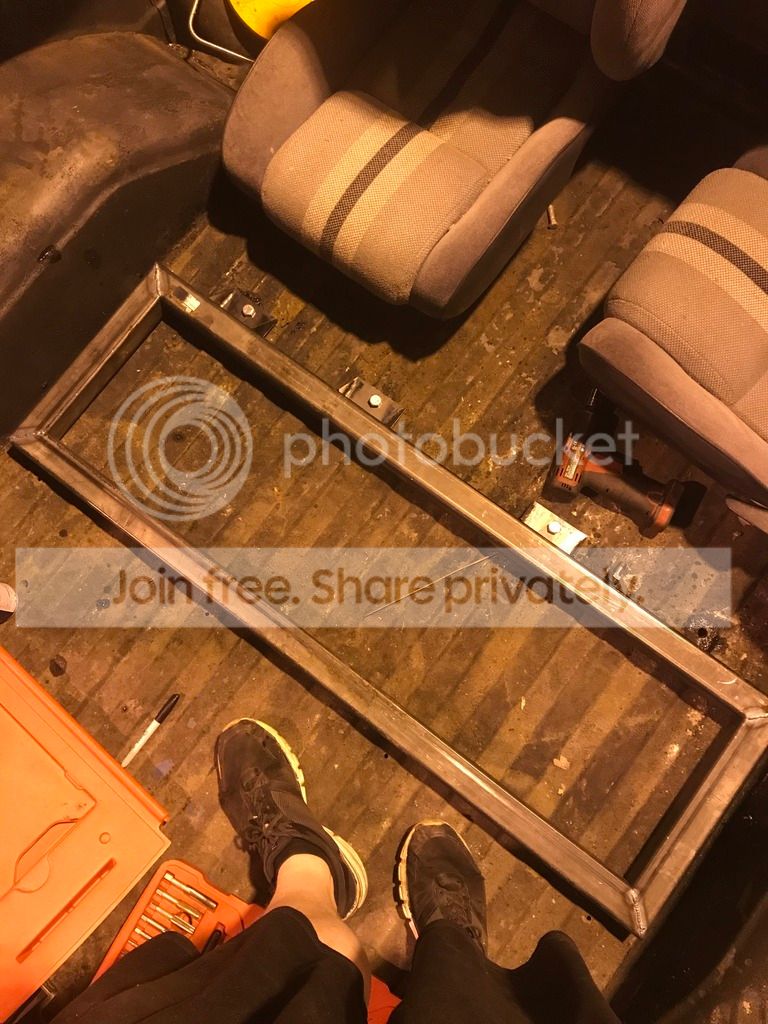

I also wanted to finally add some back seats that are bolted down and safe, something i never had before on this truck. I had a spare set of fiero seats in good shape so I decided to use them.
I welded some square tube into a frame that the seats will bolt to. I then used all the factory bolt holes in the rear floor for mounting points
