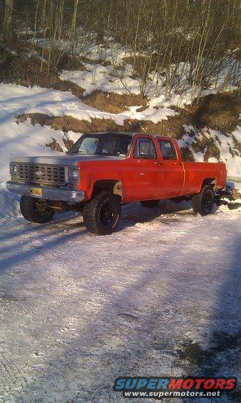

Thanks fellas for the info. I do believe the Dana 60 became available in 77 now that someone mentioned it. Heres a pic of her so far, 4" lift, 33's and half painted Orange................
