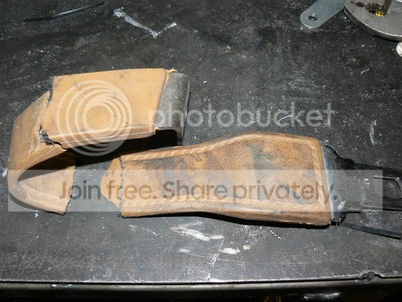

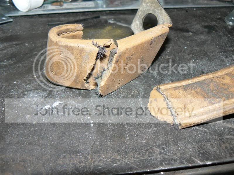

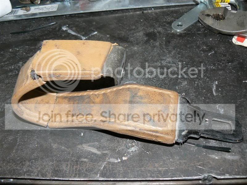

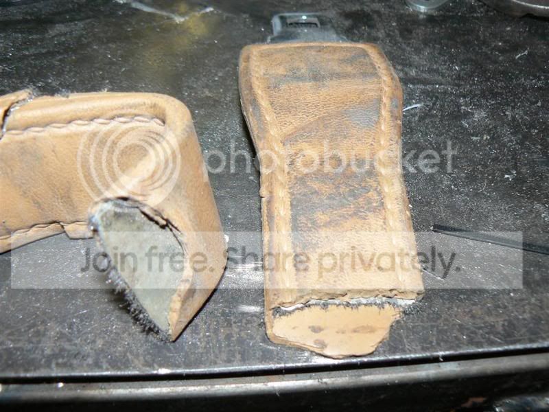

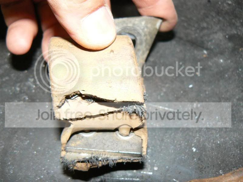

The seat has lap belts only - The clip is bolted to the floor. Questionable design. There is hard plastic that sits over the flat steel. Just by chance I noted some flexibility when I was redoing my interior. The metal broke and was being held in position by the plastic.

Here are pictures of the rear seatbelt I was talking about:
This is the way it looked for the most part. There was no indication by looking that the metal was broken in two places. The plastic was not broken when I found it. I just happened to move it and noticed it had a lot of play like a fabric seatbelt. CHECK YOU SEAT BELTS!!!
I pulled the plastic apart to find the severed metal.
These two pics are of the 2nd break. I didn't pull the plastic apart on this one. Just broke one side open to see the damage.
