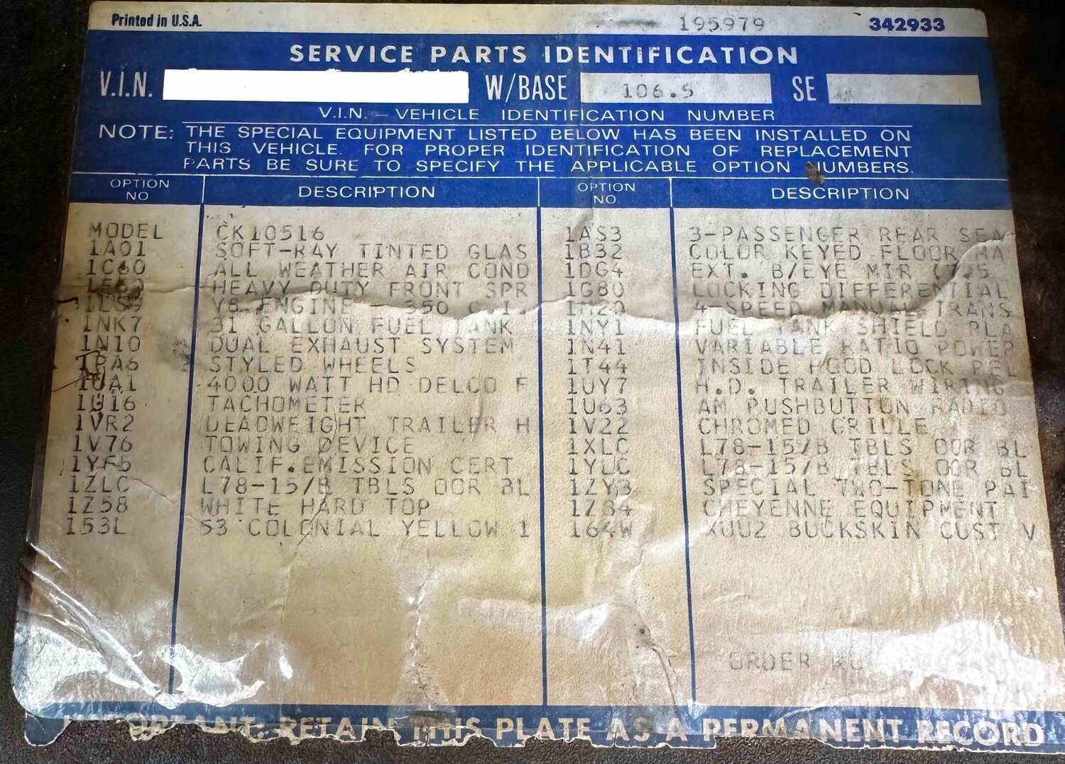

Question for you - what is the main driving force to want to make this change on your truck?
Ya initially wanted to go with an automatic trans but did not specify one with O/D and now you are inquiring about a manual 5-spd.
Are you after the ease of an automatic or the benefit of an overdrive gear regardless of what type of transmission?
And for going forward with advice it might be best if you actually told us what you have - all we know at this point is that it’s a 77 model.
Is it a K5, K10, K20 or a K30 ?
Mostly it may not make a difference but it’s just a good practice to know what you are dealing with at the start - help us help you.
And welcome to CK5 !

I've got a new engine that I'll put in sometime in December, possibly January. I'll use this as a daily driver. I like the idea of keeping it original. I don't want to paint it because the paint is original, at least I think most of it is.
I'll also use to to tow a boat. A 17' boat. Not a big deal. It will also take quite a few 5.5 hour trips. I travel from my home to a fishing location that is 5.5 hours away. The boat won't be towed that distance since it has a home where I fish. At most the boat will be towed 3-5 miles at a time. The 5.5 hour trips is what I'm thinking about the most. Keeping a manual has always been the plan, but I started over thinking the issue. An overdrive, 5th gear would be real nice. I have a friend that is an excellent mechanic that will help wtth the engine and transmission replacement. I think I'll have the transferase rebuilt just to know the condition of the vehicle.
I recently replace all the bearings and seals in the front end including replacing the hubs with Warn hubs. I put new carpet in it and insulated the floor side panels and doors.
