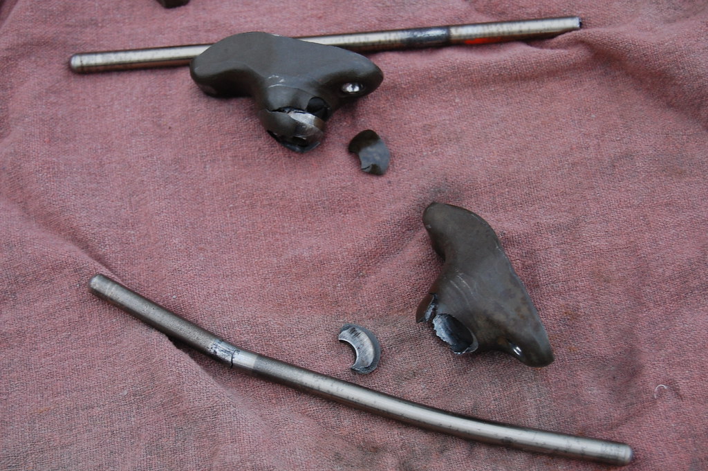

I pulled this out of a 350 recently:
Now, it ran absolutely horrible this way, but it did run and it certainly wasn't locked up.
