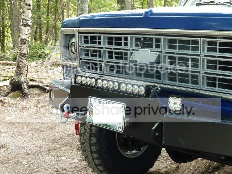

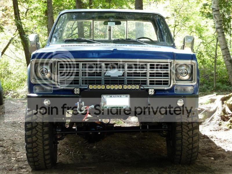

Next is the frenching in o some LED tail lights into the bumper, then getting it coated semi gloss black, like the front.
Still need to mount the hitch, get a tank skid plate made and remount the rear sensor for the adaptive headlights.
Oh and mount the NOS grille I got for it.
Then I might actually drive it for a while before tearing into the suspension front and rear and swapping the entire body to an arizona body.
Then it should be as good as done... but it´ll be a while before that ias all done!
Nice work! The bumper looks great, and will be killer when you smooth it out and Powder Coat.
Thank you!

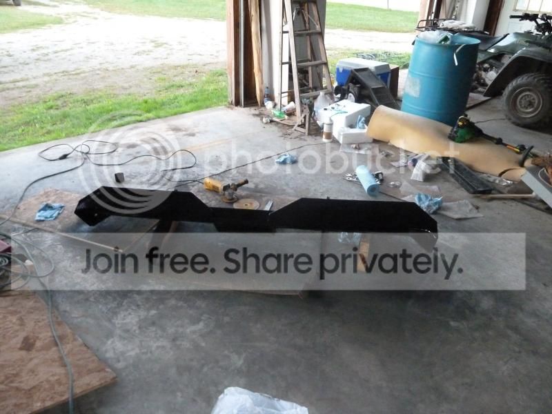

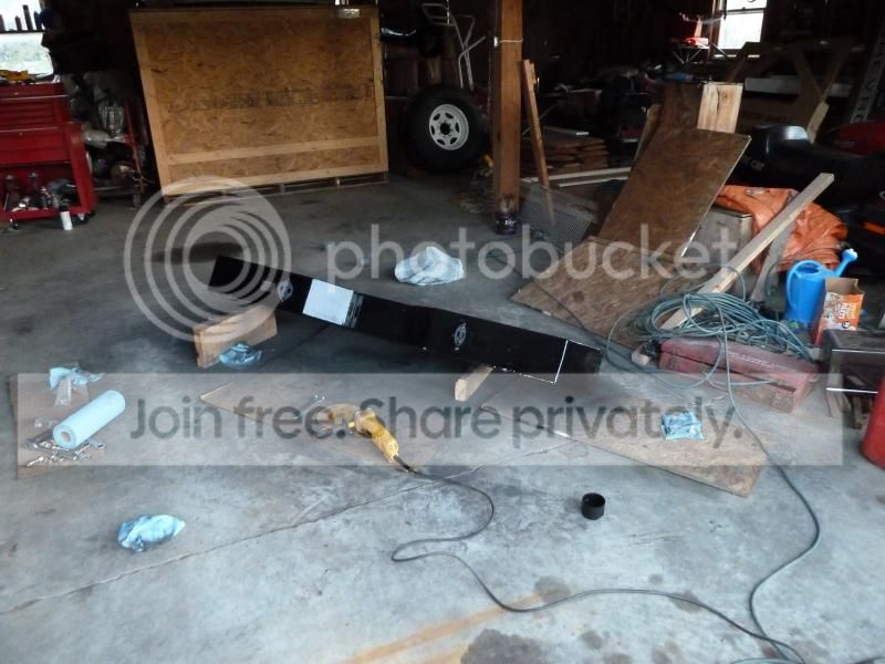

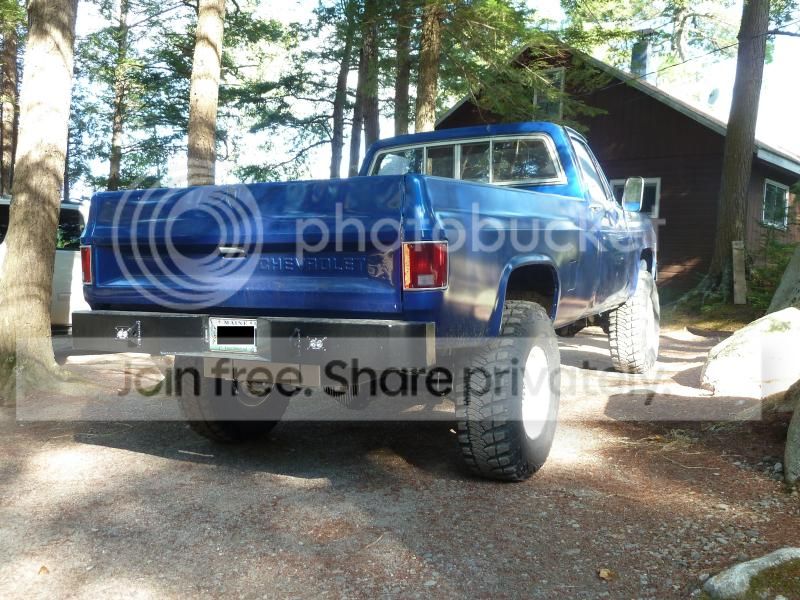

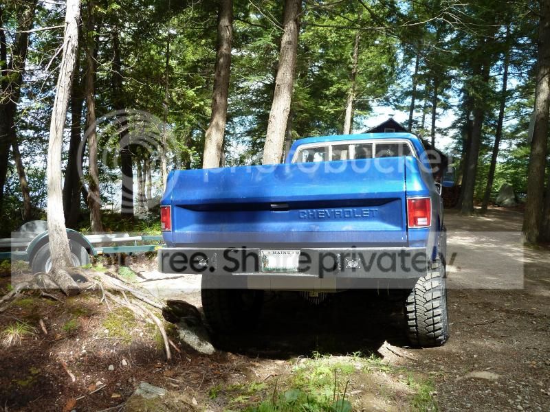

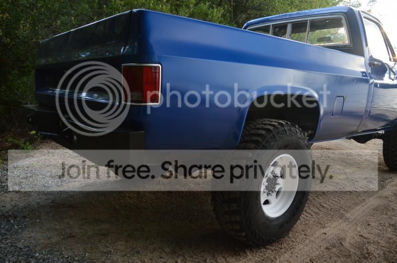

Ok, so here are some more shots of the rear bumper. I just added the work/backup lights for now and spray painted it... it´ll get the LED tail lights, the trailer plug, etc later and when all done the powder coating:
just had to throw this one in! ;)
So more photos.....

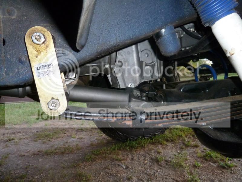

here is a shot of the drive shaft angle with the high pinion D60 and about 4.5"-5" of lift. Worked out perfect...

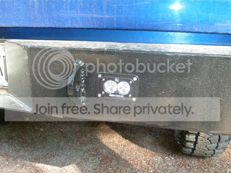

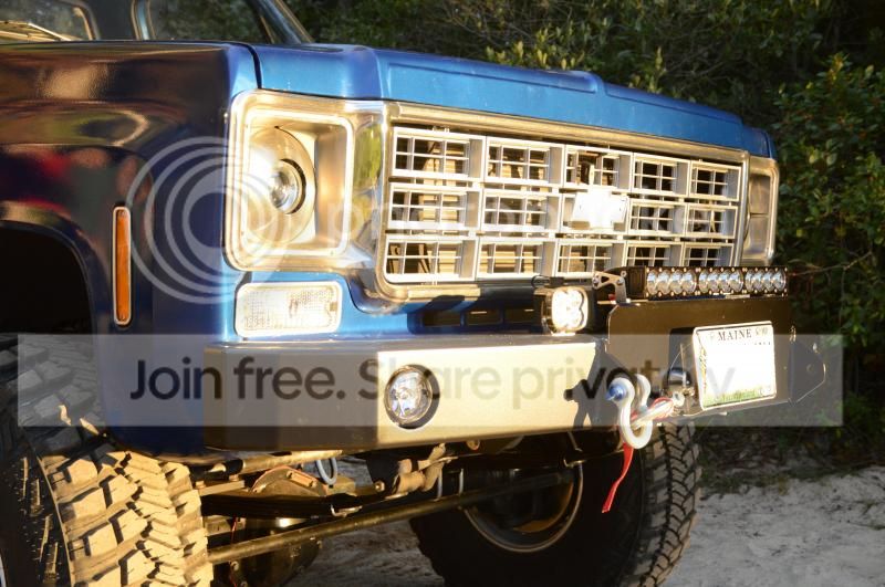

here is a close up on the LED lights on the bumper (off)
and here (on) during the day

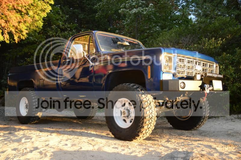

Warn VR10000-s winch... love the light weight synthetic rope!

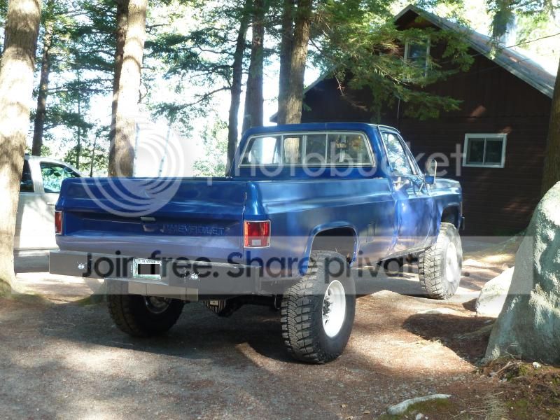

And now some beauty shots on the beach....

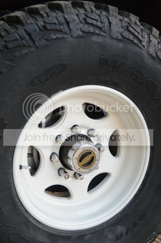

here are the massive F550 brakes

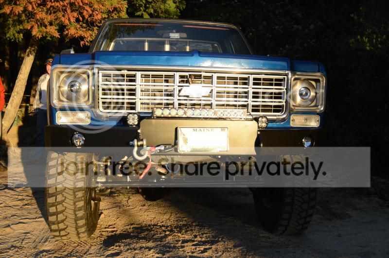

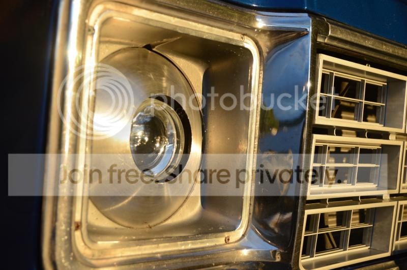

Hella Bi-Xenon headlights
