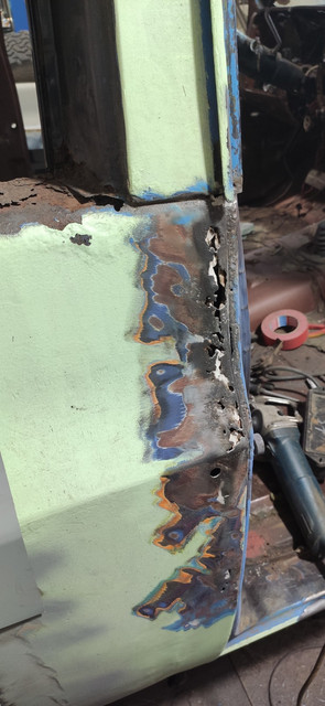

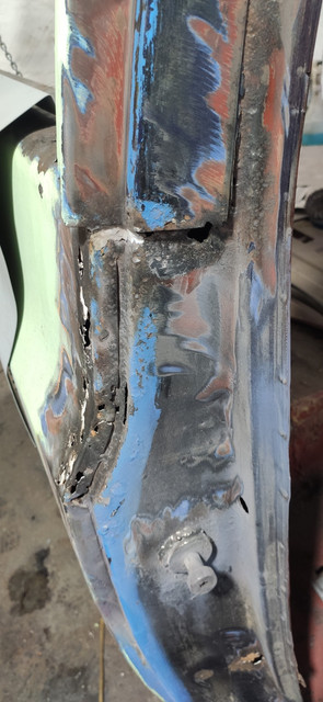

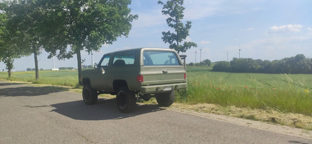

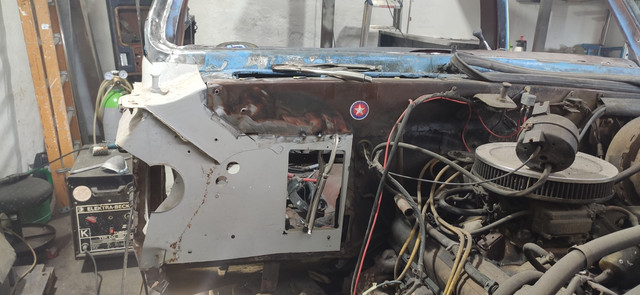

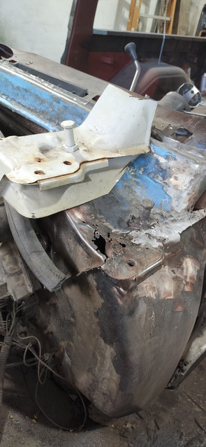

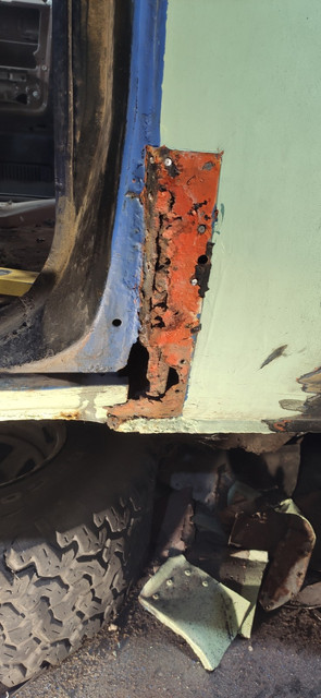

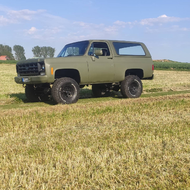

Here are some photos of the Truck, In Germany these Trucks are very rare so we got to choose, Spend a lot of money for a good Truck or wait and the the cheapest shitbox and build it.
I would check that you have tach signal at the back of the tachometer. If you do then the tachometer has died. If not you have a wiring problem somewhere.
Good work on the blazer,it looks great!

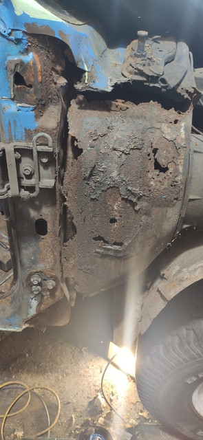

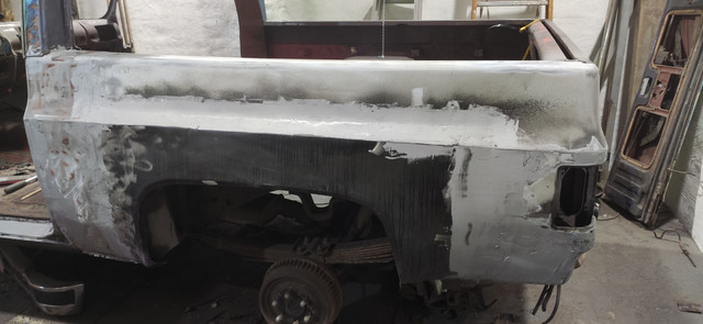

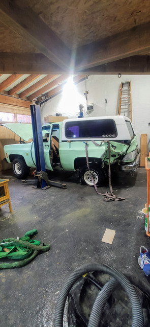

Sucks about the tach, but holy crap dude that's a helluva good job bringing one back from the dead. I thought the rust belt guys had it bad.
Bravo. Well done.

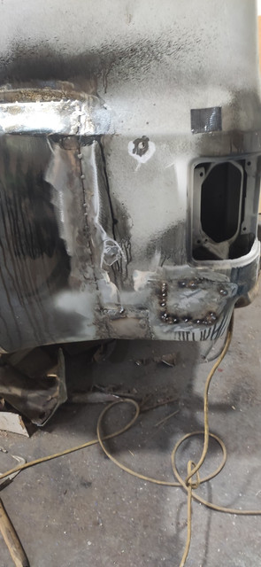

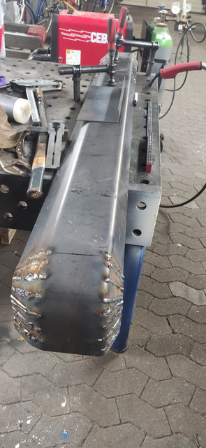

That's a nice job taking care of all that rust, and the crash damage too!

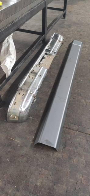

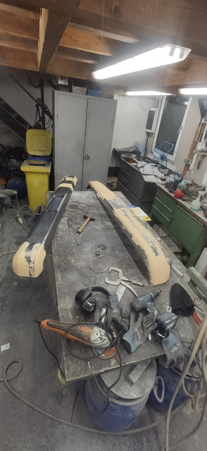

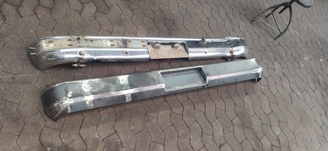

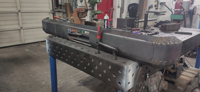

What's the scoop on those bumpers? They look like factory bumpers, but with a smooth face instead.
Hey USSkoval,
The Bumper Job was fun. I hate the look of the original Bumper with the plastic inserts plus the rear one was badly bend. So i build the rear one from scratch and modified front one. I welded pieces of sheet metal into the low spots where the plastic belongs to. And then, again, a lot of bonds Time XD
