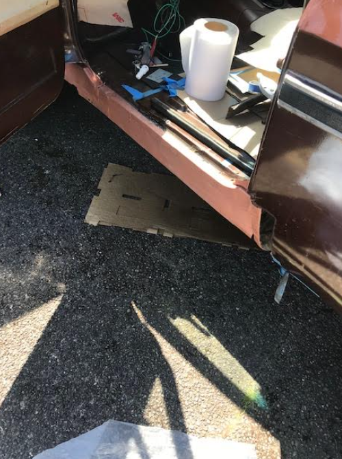

Here is how the rear is aligning. I'm going to need to make a relief cut in the rocker as the fit is not exactly. I think the rocker contour on a 78 do not match to later years.

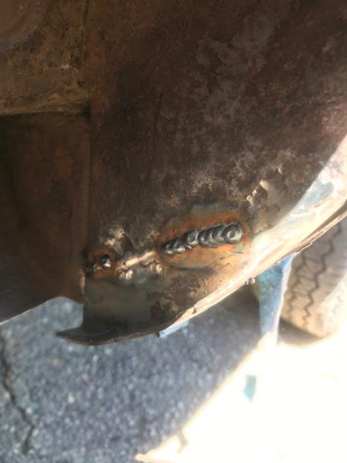

The joint were the cab support and floor support meet. Here it is removed. The front left spot weld on the can support I went about 1/3 deap into the support with the spot weld drill. My concern is that this may be a fatigue point. So I'm going to hit it with the mig to build up some metal.
It still needs to get cleaned up before weld thru primer. I'm using a 3M rust/ paint remover disk on a 3in air tool.

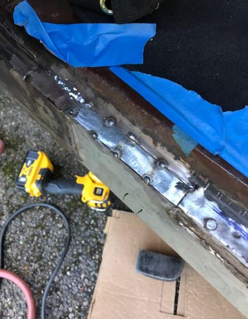

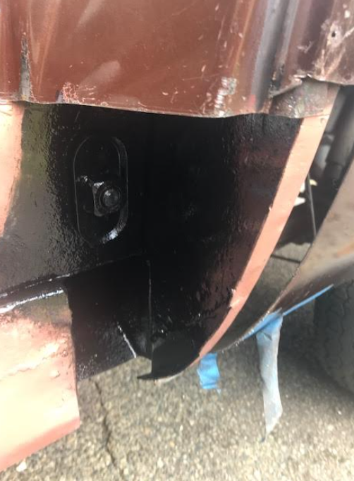

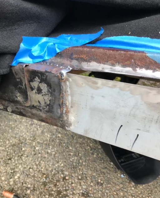

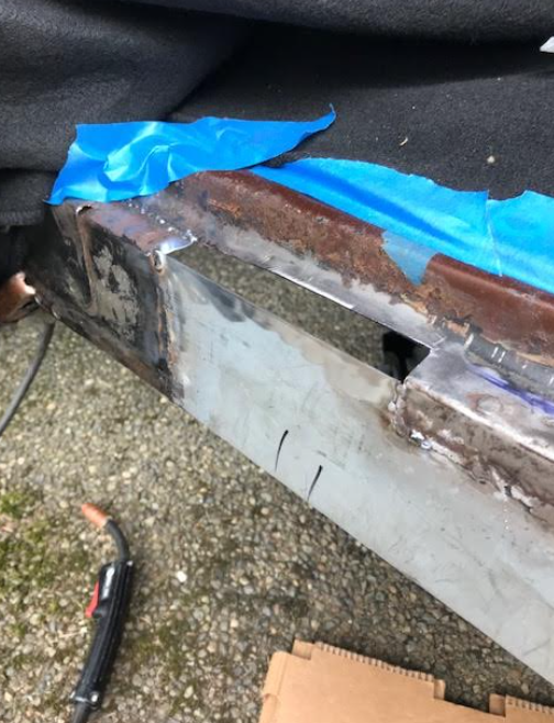

Got the inner rocker and lower B pillar welded in. The A pillar floor support is grafted from a truck and the B pillar is from a rust free K5 sawzall from the junk yard. Some copper weld tru primer and Por15 in the B pillar.

I'm concerned that the por15 may act like a threadlock so I'm going to use a die and chase the thread. May also take a Dremel brush to the thread.
