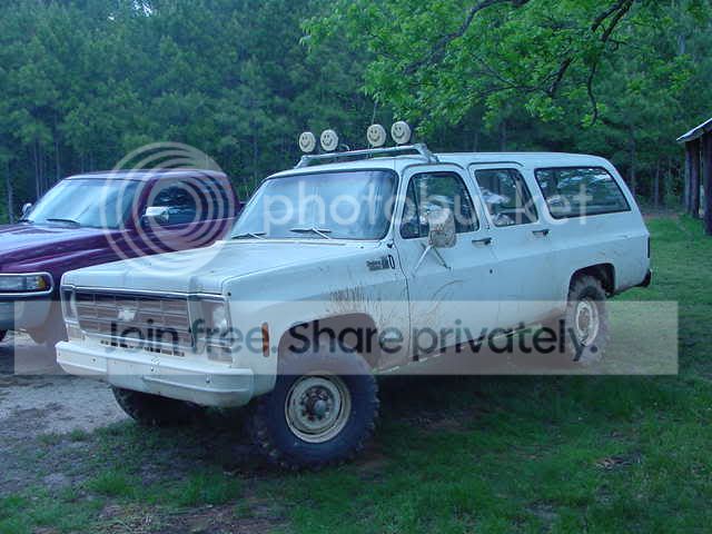

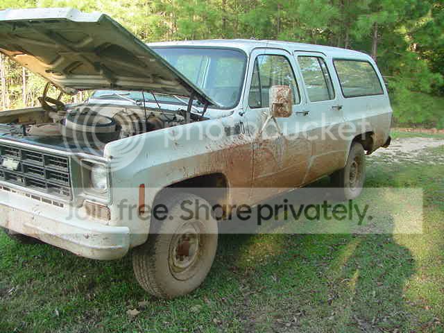

I started out with a 1978 K20 Suburban I bought from a good friend for 1000 bucks, most of the money used to purchase it was from the crapload of graduation invitations I sent out. It was origionally used at a sand factory, and was a government truck before that. Nothing too special, just 350/400/203, corp 10 front, 14ff rear, open carrier at both ends with 3.73 gears. I was completely clueless about anything untill I found ck5, which was luckily soon after I bought the burb.
It wasn't capable of much, but its all about having fun, even if it is poser fun :doah:

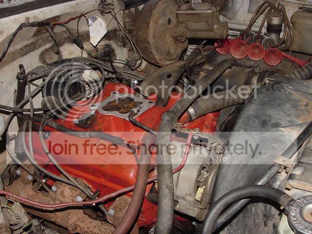

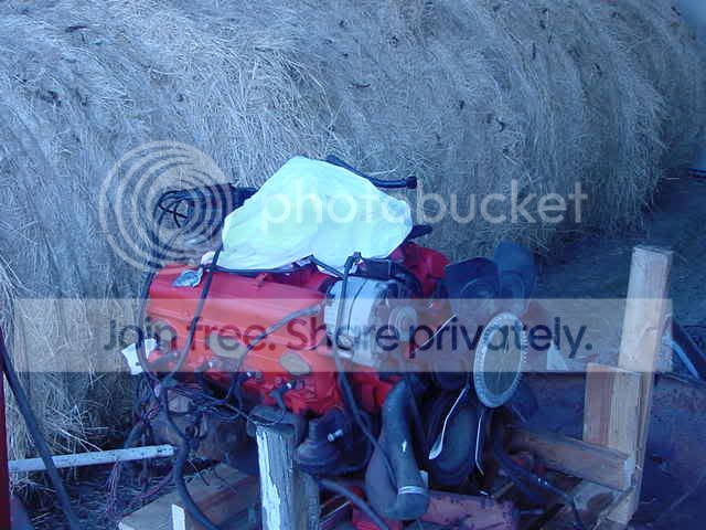

I installed some 20 dollar guages from walmart, which let me know my weak feeling motor was only holding 5 oil psi. I was afraid it might spin a bearing with such low oil pressure, so I bought another motor for it, out of a 73 camaro.. its another 350.
Had some issues with the motor, turned out to be some valve adjustment and rocker stud replacement solved it.

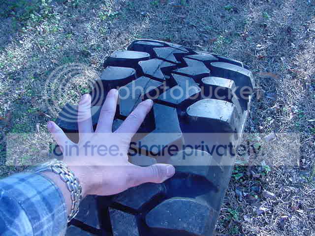

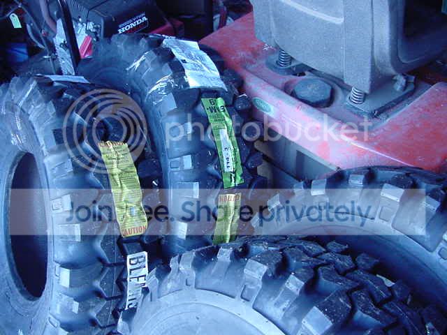

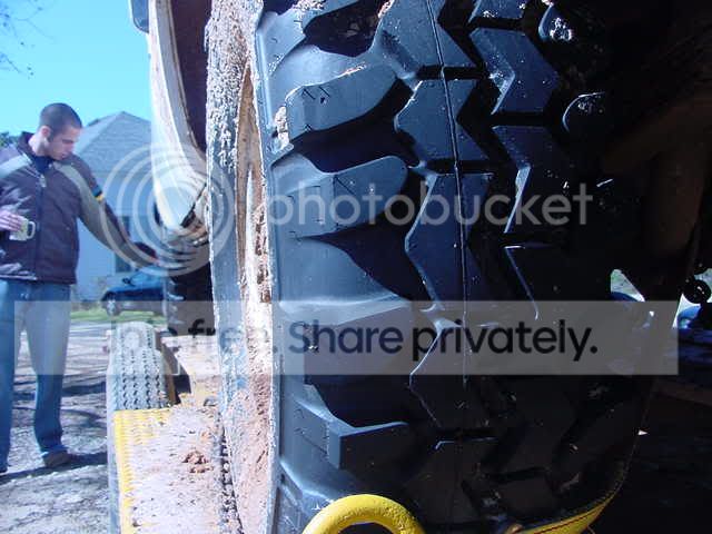

Got me a Christmas present. Before the Interco Blem site was outted to pirate and everybody else, and before the demand was way up, I got some tires very cheap. Four 33x12.50x16.5" TSL's, brand new, misprints on the sidewall to my door for $366

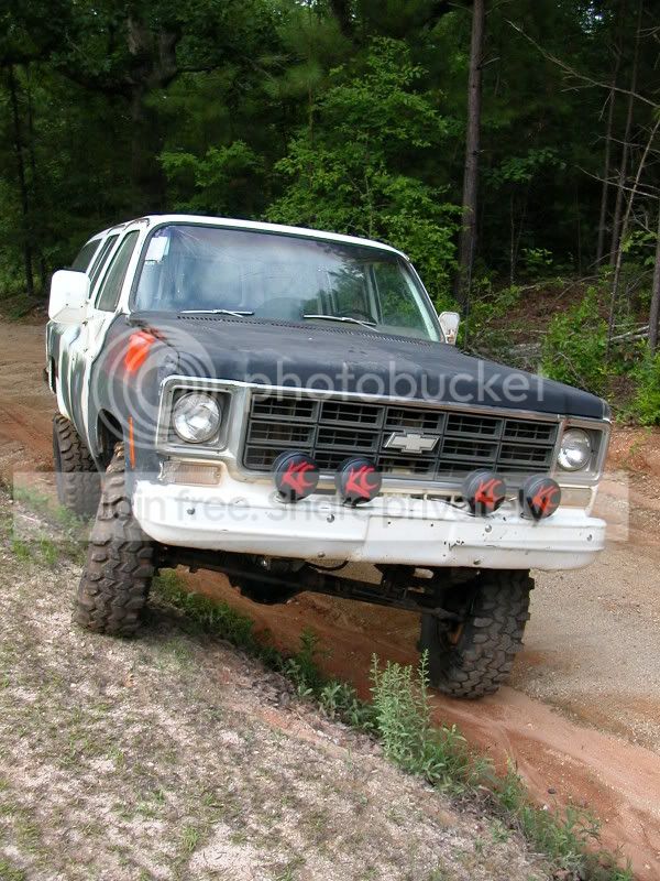

Got some kc's and light bar off of ebay.. the light bar has now been sold to a ck5er, and the lights have been moved to the front bumper.

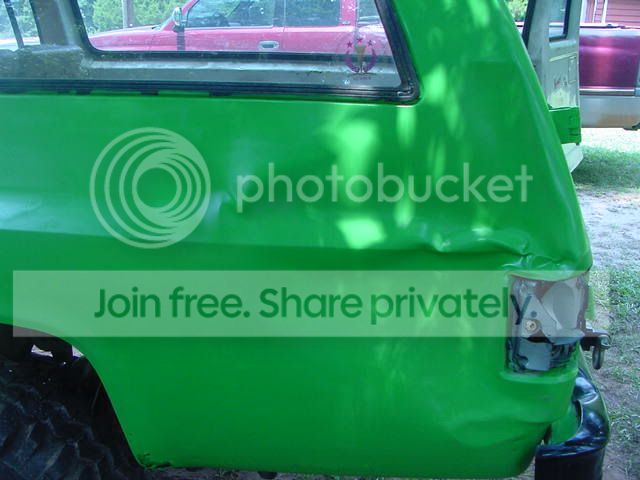

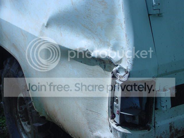

Cut my teeth on my first body damage

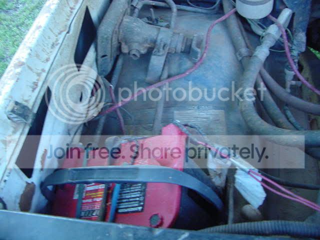

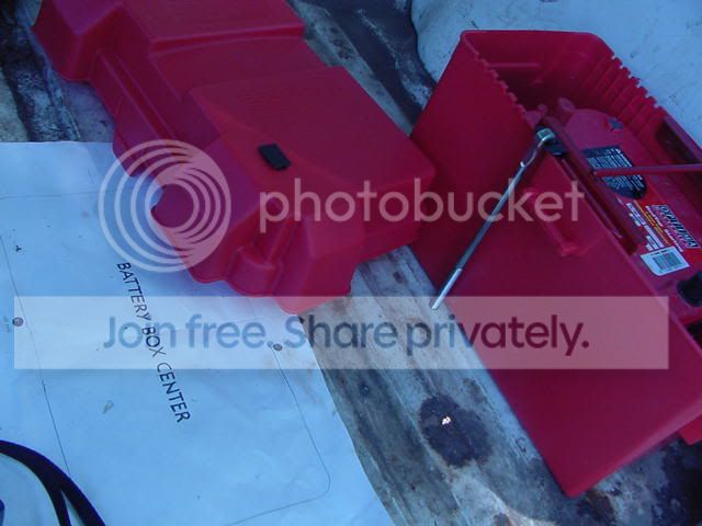

I bought a red top optima, but the battery box was seeing better days
So I moved the battery to the rear of the truck

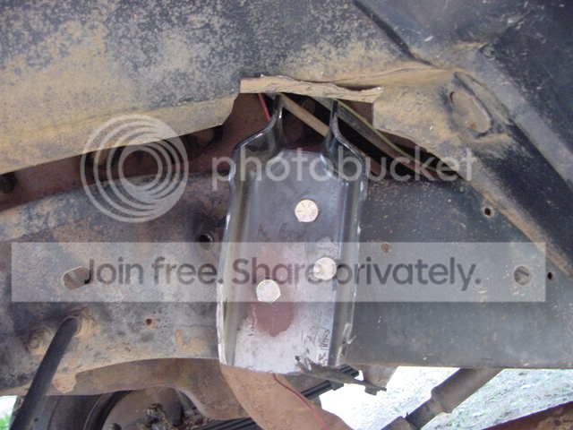

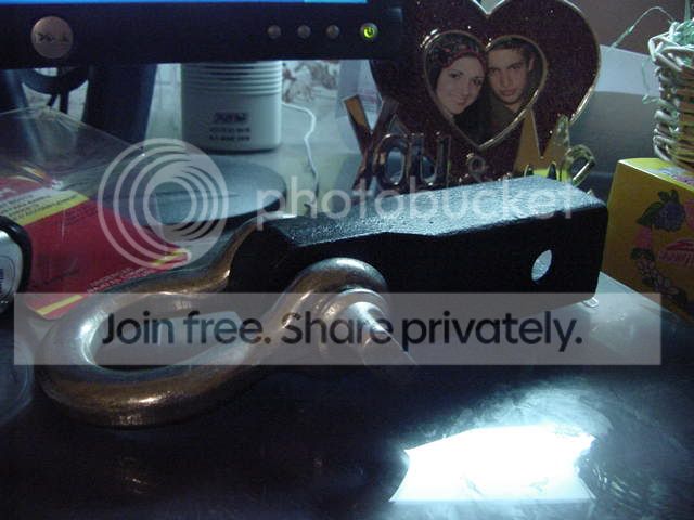

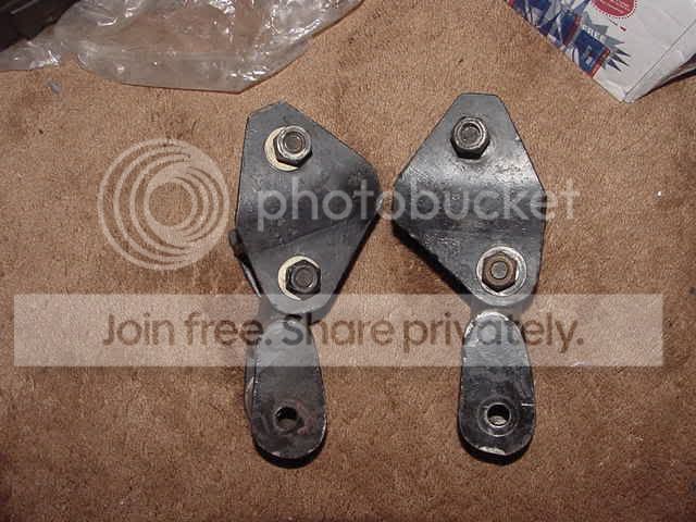

Got a rear reciever shackle off of ebay for 23 bucks shipped

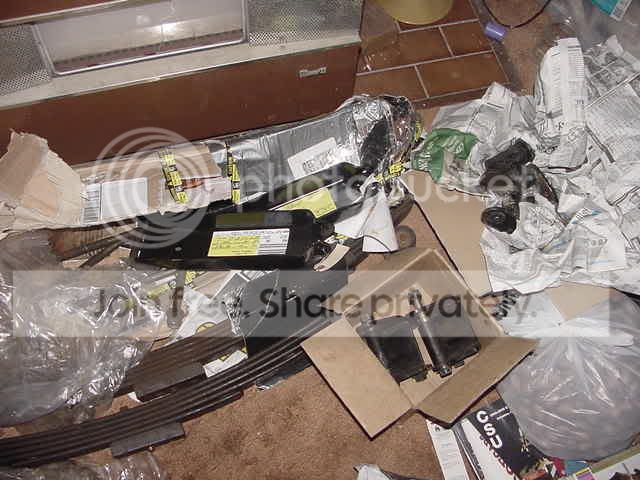

The burb was kinda low, and had no flex.... Even though I hacked the fenders, the little 33's still wanted to rub with no sway bar. I was also having the tie rod rub on the tire when I turned all the way to the right, because the stock wheels have so much backspacing.. thought about different wheels or backspacing.. but then I said, what the heck, might as well do a suspension lift.. so the lift part collection began..
so yeah, the stock suspension just wasn't getting it done too well...
got some 4" front lift springs with 1" zero rates from a ck5er

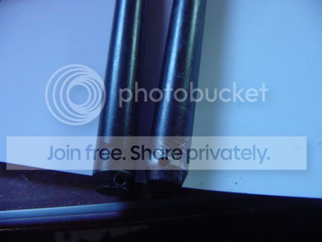

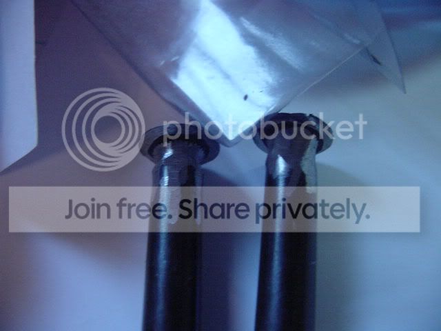

Between waiting on parts I got ADD and made some quick release door hinge pins for my driver side door... Still need to get around to making them for the passenger side door..

the pile was growing.. got some ford shock towers

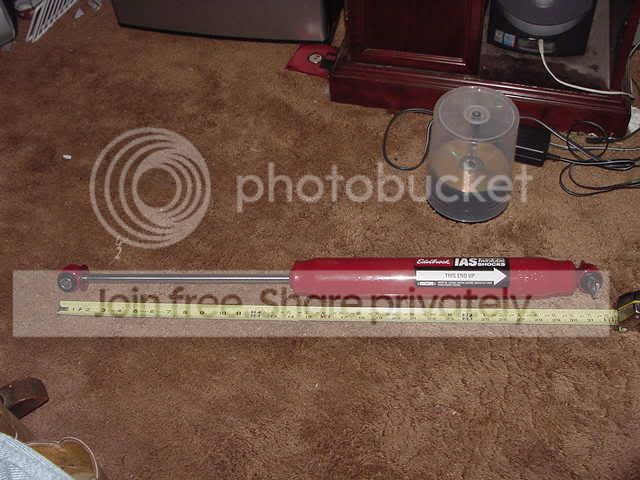

got some 12.5" travel shocks on clearance sell from summit. They weren't origionally made for my application, but with some very basic bushing swapping, they fit like a glove.. thanks pvfjr for finding the incredible deal on these shocks!! they ride VERY nice because they self adjust

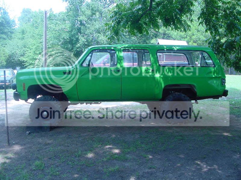

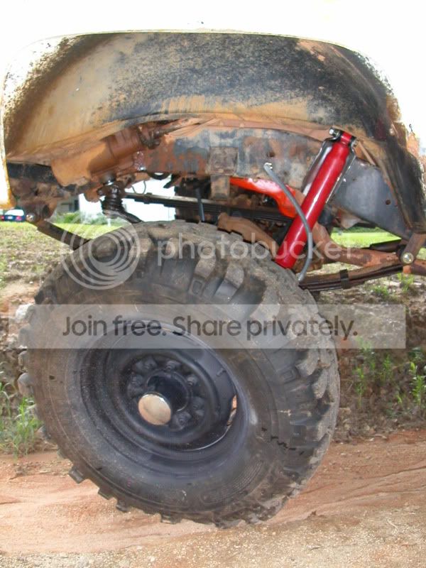

got the california stance going at first...
mounted up some shock towers

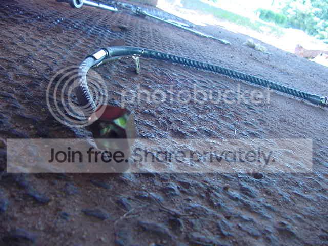

Bought some LONG brake lines and a steering arm from pvfjr

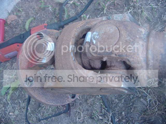

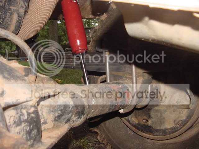

I had to beat my exhaust pipe off my front shaft and take the front shaft off and clearance grind it..

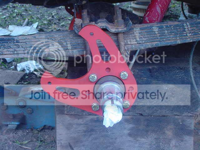

My rear pinion angle was pointing up sooo high. I called Jessee at HAD, and from my measurements he said to go with a 7* shim, run backwards from how people usually run them.. Ordered some from JKW offroad.. They worked out PERFECTLY.. very nice machining..

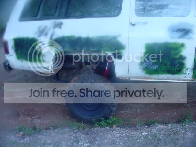

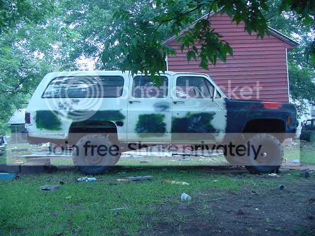

Seriously considered some kinda custom camo paint

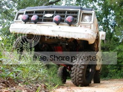

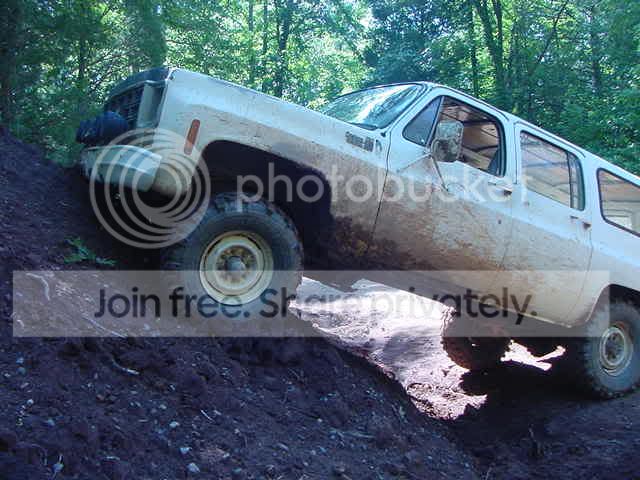

Now that I had a lift on it, I had to go do some quick poser flex...

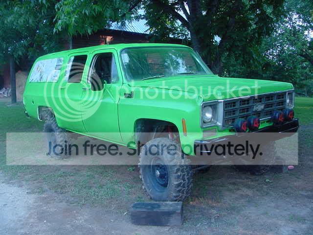

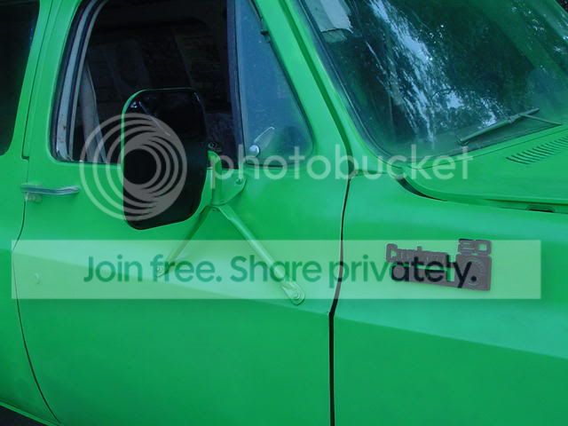

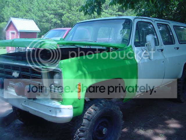

I decided it was time to paint over my crazy testing areas.. Narrowed it down to chevy engine orange, or grabber green.. I told the girl friend she could pick.. she chose green.. I knew it would look good, because boggerless did his truck in it :bow:

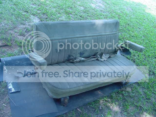

I posted up that I needed a 3rd row seat.. Jimmy (draggbody) said I could have his.. now I just gotta fab up some kinda brackets to hold it down, haven't had time to fool with it yet

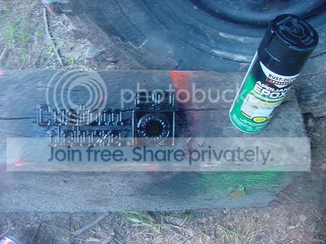

I painted the trim and bumpers with some appliance paint
even painted over the old dent

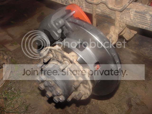

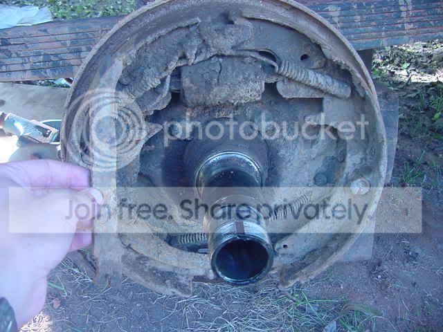

I had some brake issues, so I decided I would replace calipers at all 4 corners, its been needing it... got some new calipers for the front. Got an extra set of rotors. Going to get another set of calipers this week.. Got this from DIY4X
The carrier is laying in my truck right now. Tomorrow Jimmy told me he would be able to lincoln lock my carrier. So within the next week or two the 14ff should be disked, welded, and shaved. One day when I get some extra cash I'll have a RuffStuff Cover for it too...

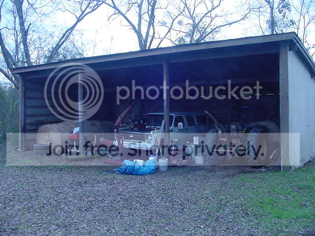

I can't wait to get the burb driveable again.. I'm missing playing around with it.. Here's how she sits right now, just waiting to be worked on..

I can't wait to get the burb driveable again.. I'm missing playing around with it.. Here's how she sits right now just waiting to be put together and wheeled...
Looks good...shes got a saggy butt though
Look at the bottom of the body line... it level, or maybe higher in the rear.. the front fenders on burbs were cut higher, giving it the optical illusion of a saggy butt.. sometimes people dont' realize this, and end up with way to much lift in the rear.. the key is visualizing a line along the bottom of the rocker panels.. at least thats what I tell myself :D

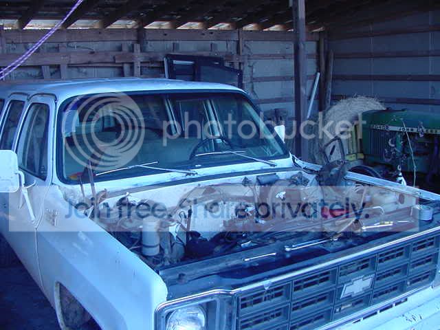

It was a big improvement over this :doah:
