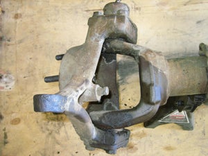

Dana 60 knuckle: Note the lack of balljoints, and the bolted kingpin/trunnion bearing caps in their place
Thanks 6.2 Blazer and Paratrooper307, you were spot on and the front end was a Dana 44.
And thanks to Owenst7 I was easily able to identify a suitable Dana 60.
