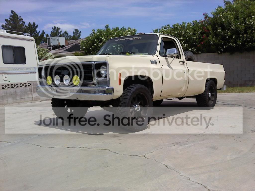

the previous owner named her Betsy. she is a 1979 Chevy standard cab long bed TWO WHEEL DRIVE 3/4 ton truck. the truck has lived in las Vegas since new and has no rust anywhere. the rubber has all but rotted away and i have been replacing cab mounts, door seals, window seals.
she runs a 350 crate motor with some RV cam that was installed a few years before i picked her up but i have added a few things to bump up the performance. like an Edelbrock manifold, edelbrock 600 cfm carb, MSD distributor, MSD 6a ignition box with adjustable timing controller, powermaster 160a alternator, high flow water pump, Holley fuel pump and out of the factory exhaust manifolds a 2 into one exhaust with 3 inch flowmaster muffler that cuts out right before the rear axle.
the front suspension has Fabtec 4 inch coil springs. the shocks had to be replaced so a set of rancho 5000's have been added. to get the ball joints to work with the new springs i flipped the upper ball joint to under the a arm and a spacer was installed between the ball joint and the control arm. the rear suspension is bone stock down to the shocks. it does have a rake typical of a "prerunner" but i don't mind. it also rode like a brick until i added a dual battery set up. still rides a bit stiff, but better with the added weight.

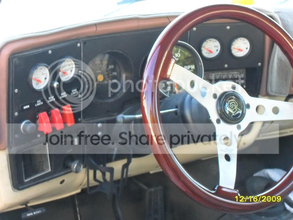

in the cab i have added autometer gauges to the dash. (oil pressure, water temp, voltage, tach, fuel level) a wide band O2 sensor/gauge is ready to go in as soon as the new exhaust system is built.

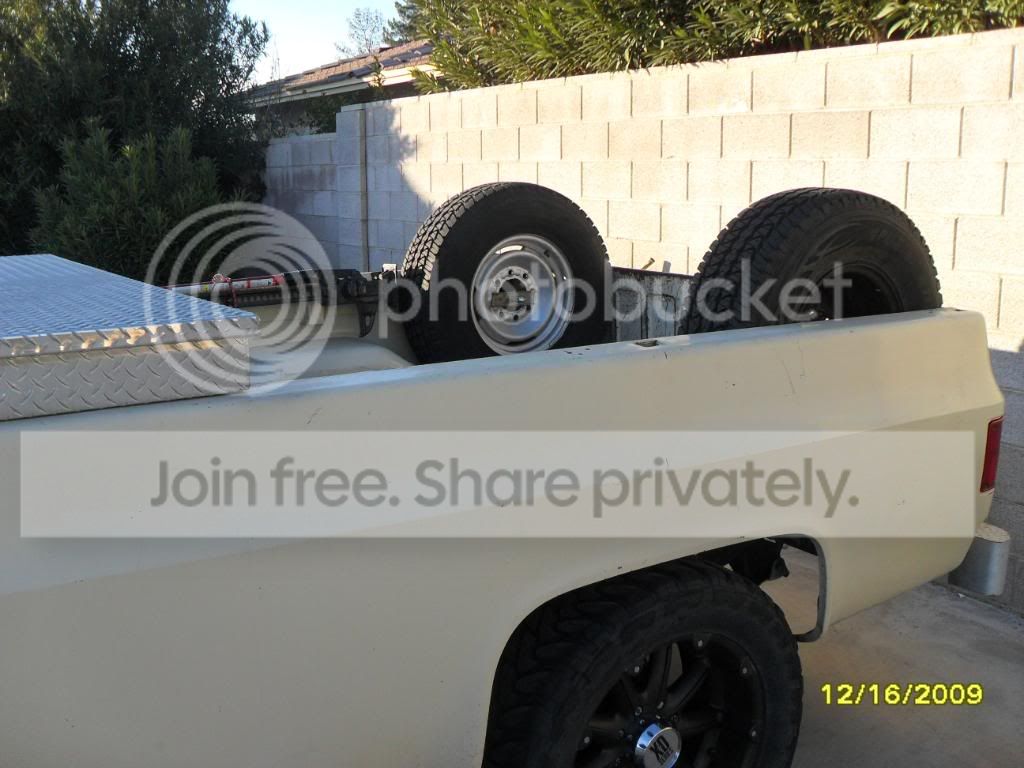

in the bed i have a standard aluminum tool box that i am setting up for expedition type of travel. i have two yellow top batteries, jumper cables, two 800w inverters and plans to mount my hi-lift jack and shovel to the box. i will add an air compressor system in there as well as some way to charge the system via solar and the alternator off the motor. also i have two spare tire mounts (but only one is being used right now)

i have a tube bender and two welders so tube bumpers and brush guards will be fabricated along with a chase truck rack going over the cab and front part of the bed area. my dream would be to retrofit a 6.0 and a matching transmission but budget will have to catch up after the suspension as it gets priority.
