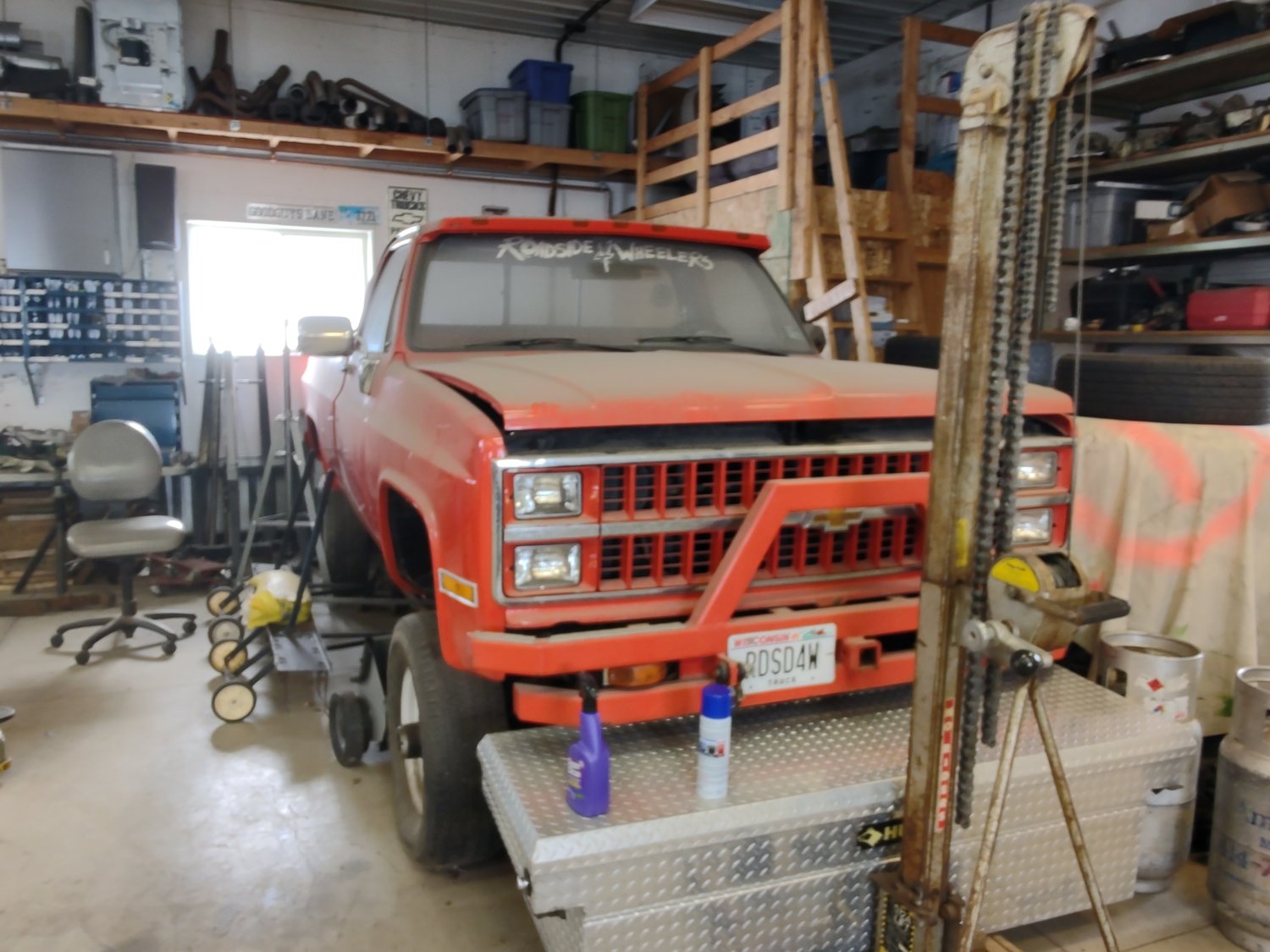

Just trying to get my 79 back on the road.

Back to the 79 K-30. I should explain a little about it. I bought it from my uncle when I was 19 as best as I can remember. That would of been 1992 It only had 60,000 some miles on it but was very rusty due to it being a plow truck here in Wisconsin. It was a factory k-30 4speed 350 small block truck with 4.10 gears. I bought it for $1800 with the plow. 1st thing I did was sell the plow for $1000 and I had my dream 1 ton to build up.
I started out with a 2" body lift and then followed with what we're called 6" mudbogger springs made by Rancho. I don't think they were ever a very popular spring. They have like 9 leafs and aren't overly flexible. And I think they go more than 6" of lift because I bought 4" skyjack softride rear springs but needed about a 3.5" block in the rear to get the ride height right. I fabbed the bumpers that are still on it now and ran 35" bfg mts on the street/trail and 35 buckshots for mud drags. I had a lot of fun mud racing it and eventually decided to fix up the body and paint it that would of been like 94-95? It started out with a newer southern cab, box and front clip all from different trucks. I also switched it to a 400 auto. I was going to blast the frame but came across a sweet deal on a powder coated 81+ frame that was also a k-30 frame. Only problem was that it was a light gray color. So I scuffed it and sprayed it with a gloss black urethane paint. The frame turned out so good that I spent more time and money on the body than I'd planned. The truck turned out very nice. I did some truck shows and Jamborees in the mid 90s then got back into some mud races and trail rides. Because after all that's what I built it for. It started to get some scratches and dings in it.

This got way longer of a post than I thought it would but having never done a build post I think I screwed up the set up and entering of info and pics. I'll work on getting some pictures posted.
Because pictures are good right?
I don't really have many digital pictures of this truck because the last time it was in use was before cell phones
