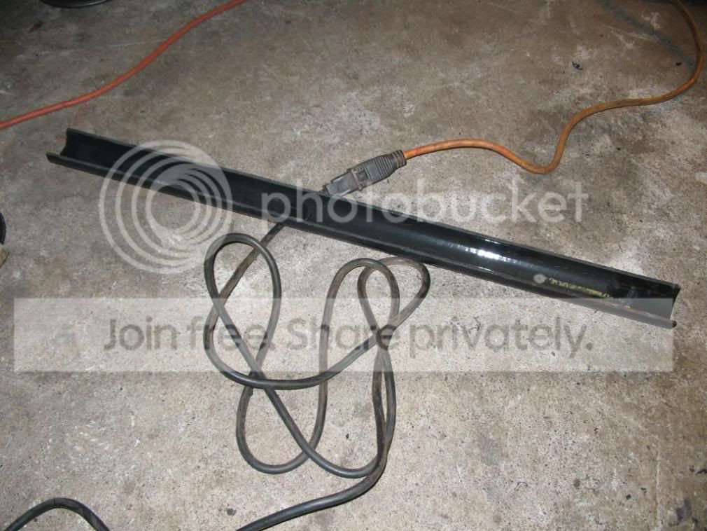

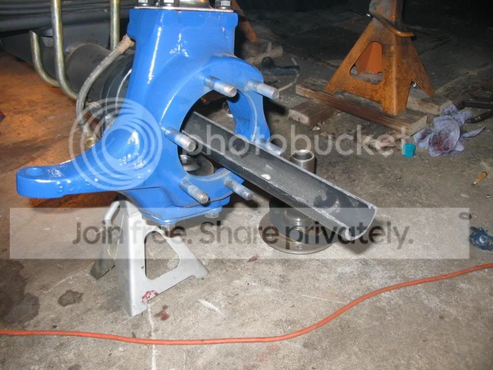

I did the PVC pipe trick before i reinstalled my axles too because those tubes will get dirty again.
Find a piece of PVC that will fit into your axle tube. Cut it in half long ways and trim the length to fit inside the tube. When you are ready to slide your spare inner/outer assembly in you slide out the piece of pipe first and clean the grime out of it and reinstall it. That way when you slide the axle in it doesn’t push all the mud/dirt into your front diff.
