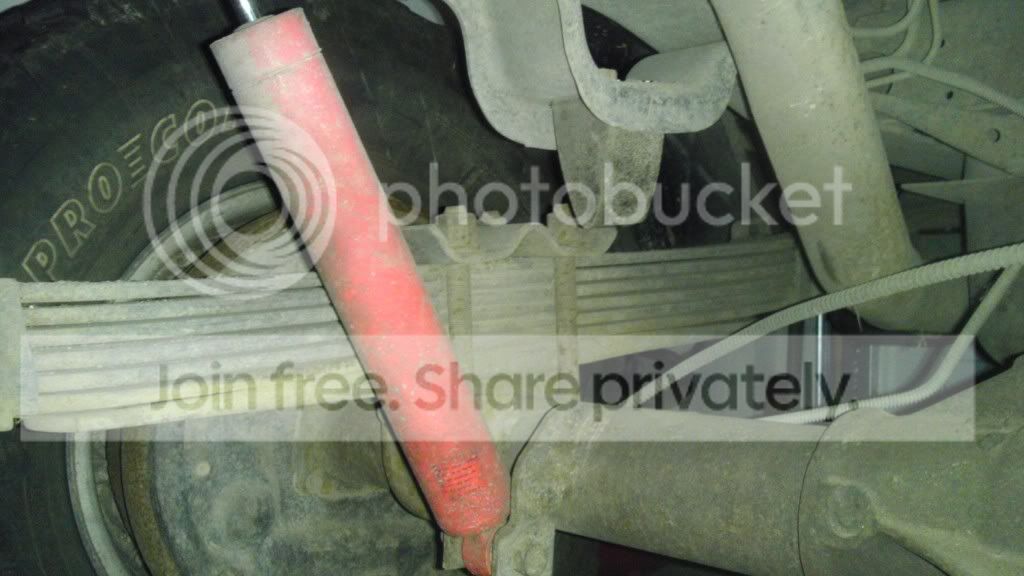

This is my rear pack in my 90 burb. Its stock and they are what i would consider soft. The front is way rougher than the rear. Speed bumps in parking lots can be taken at any speed with the rear end but the front will bounce you.
i see you have 6 leafs in the back plus overload, I have 9 leafs plus overload, so you have 3 less leafs. Definitely why mine probably feels so stiff. Bouncing my 300 pound body on the rear bumper I get 1/2" of travel
well dropped it to the same setup that you have and what an improvement! lol
