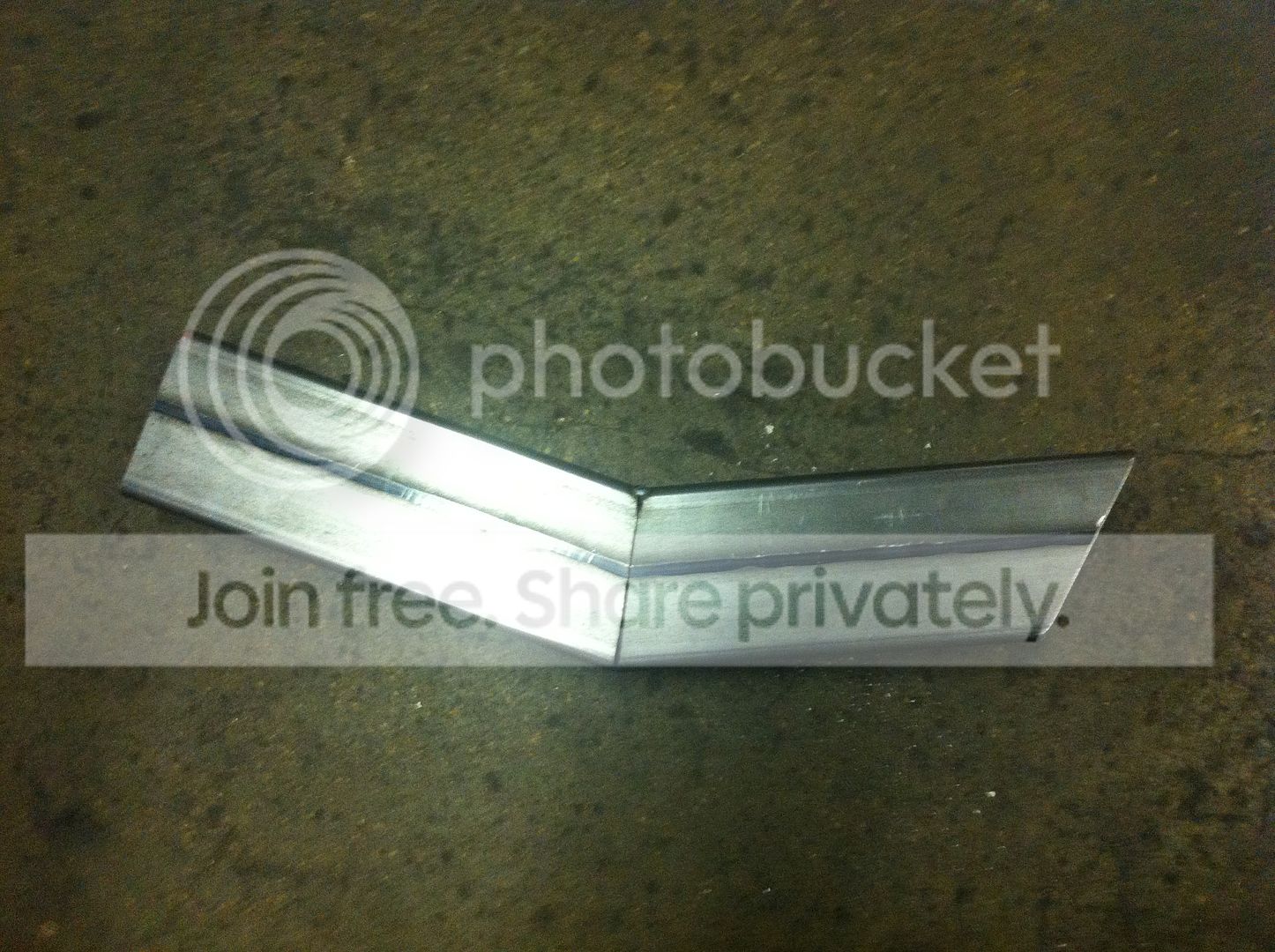

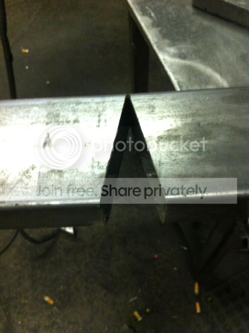

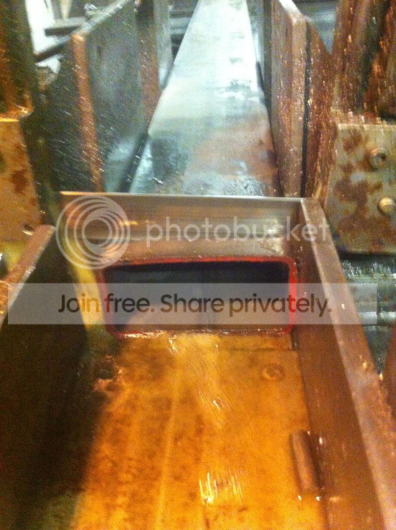

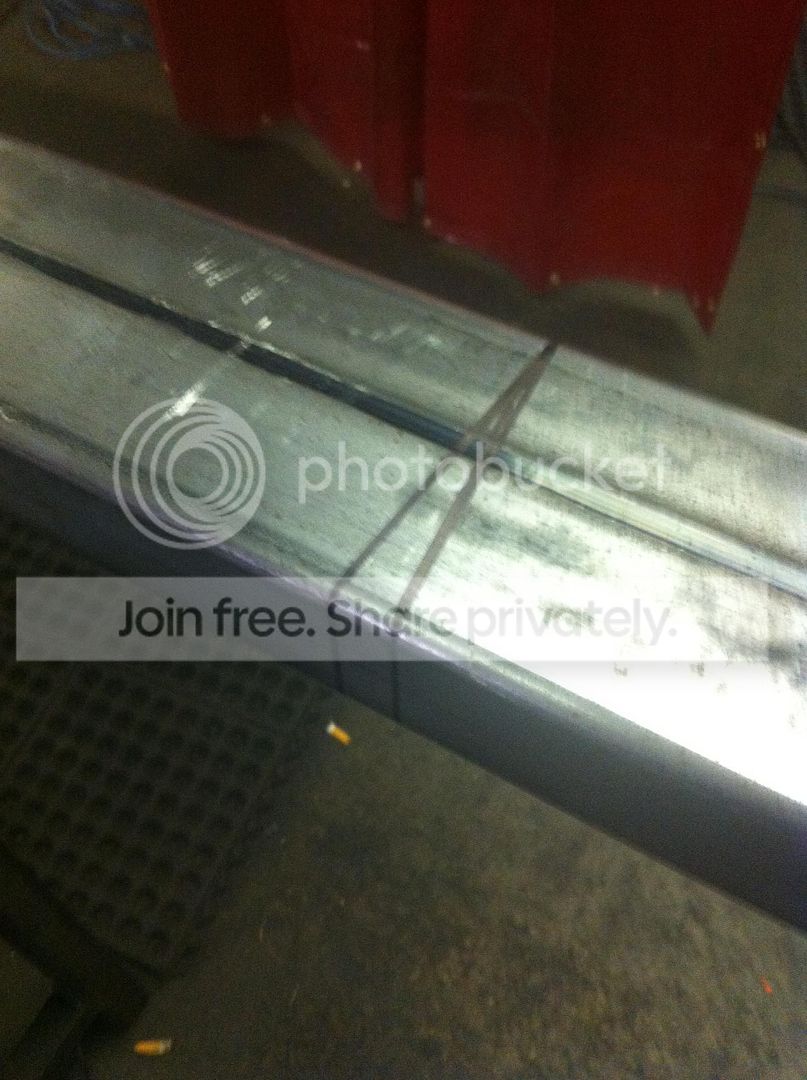

4" rectangular tubing meets the ban saw for the first cuts.

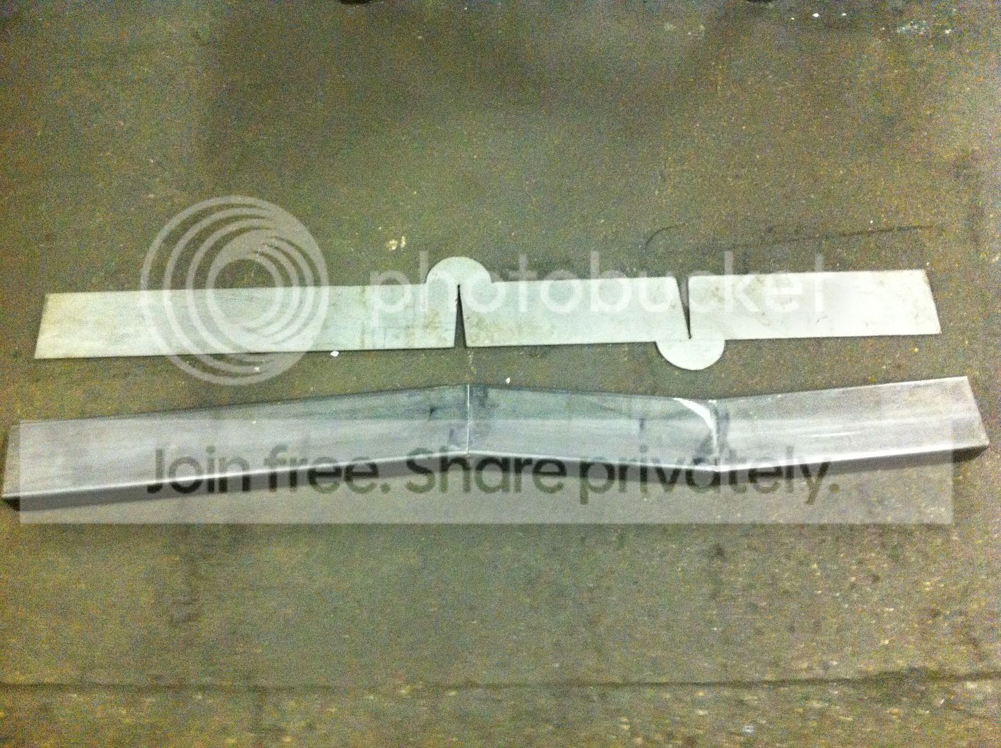

Some layout work,

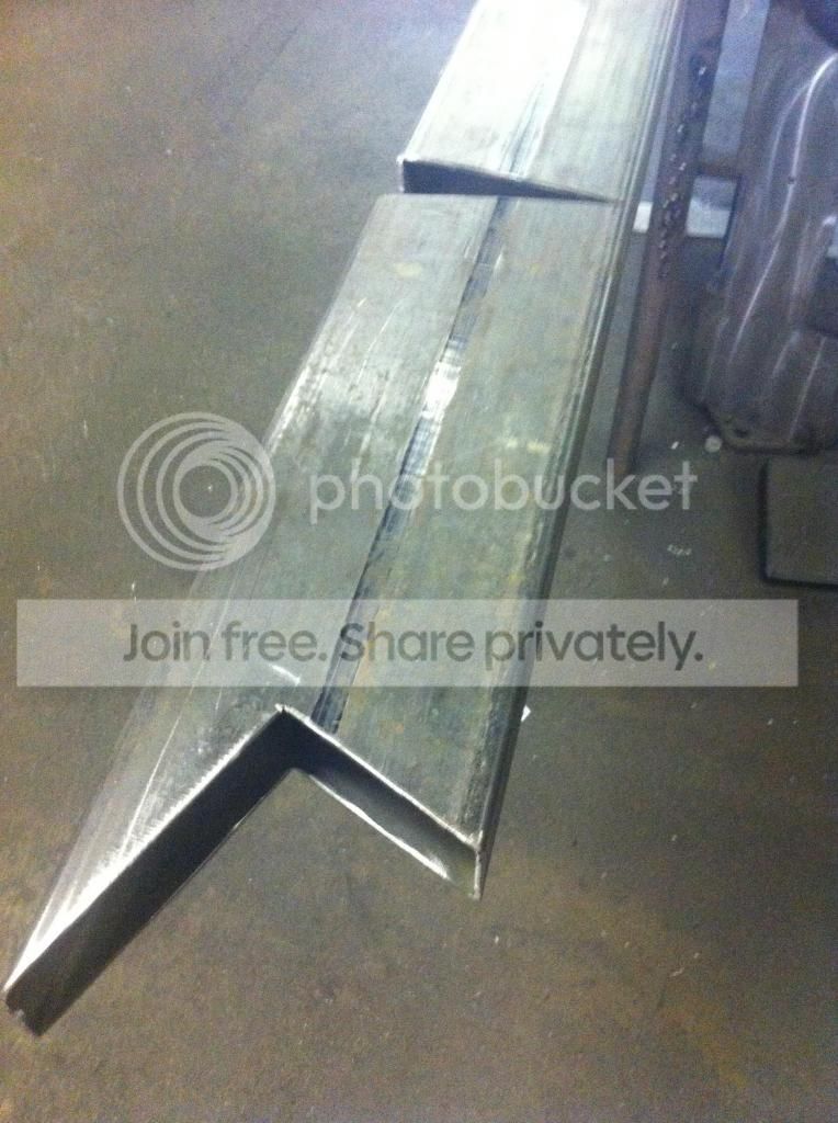

Starting to make some bends.

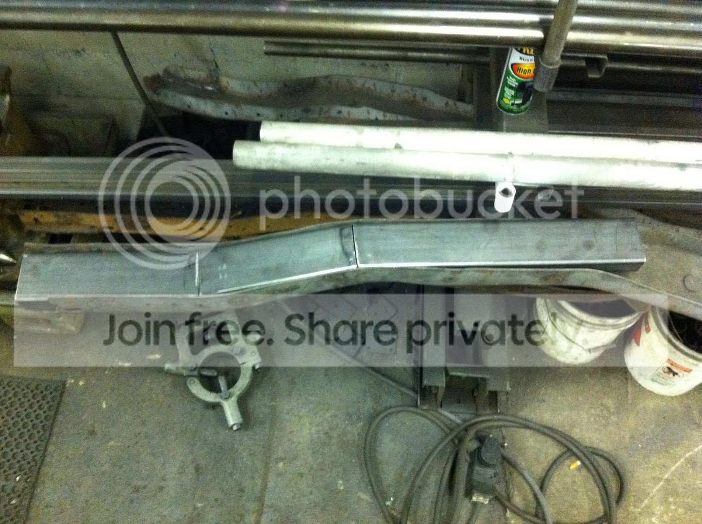

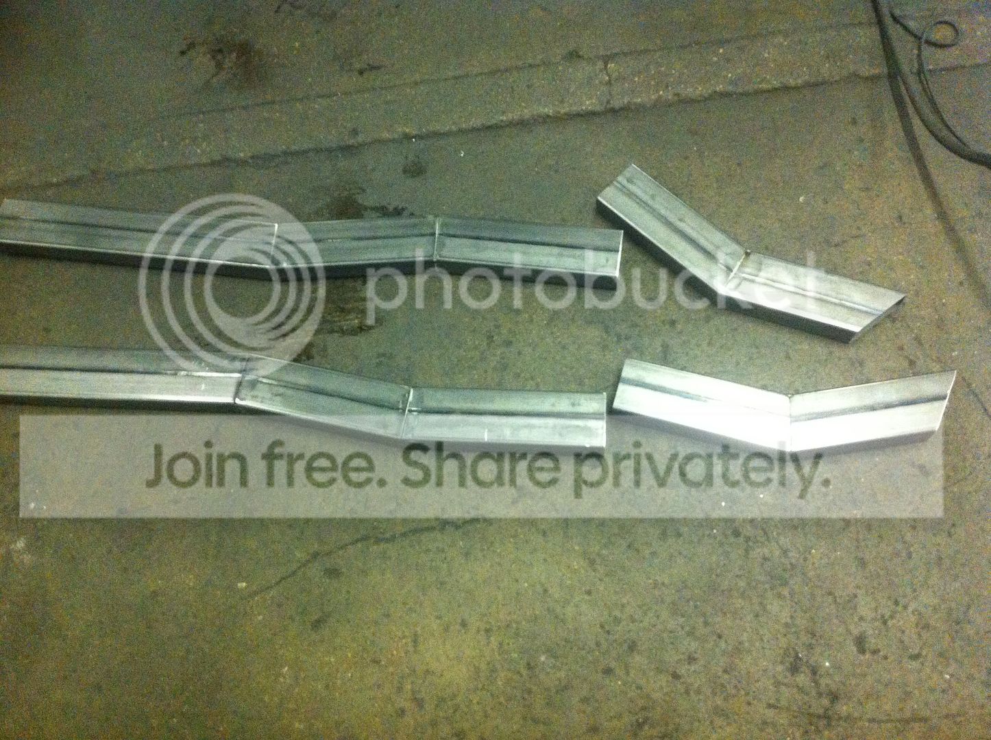

Some pieces ready for welding.

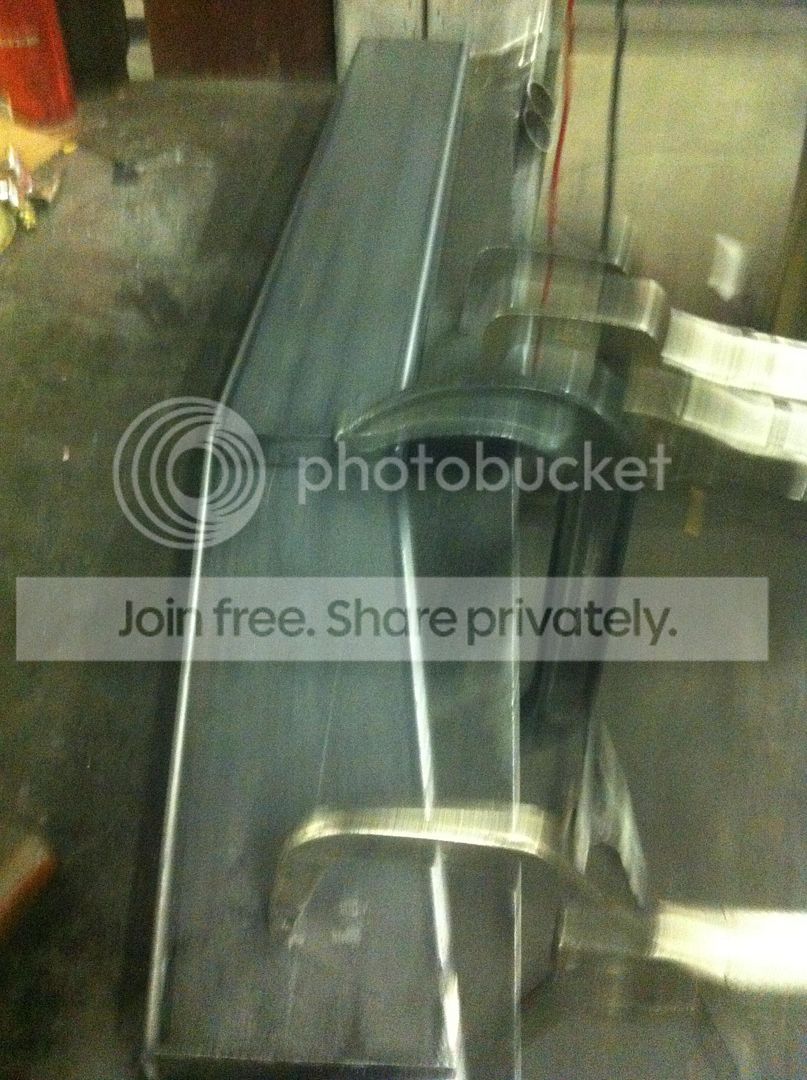

First comparison to the factory piece.
Templates for the layout.

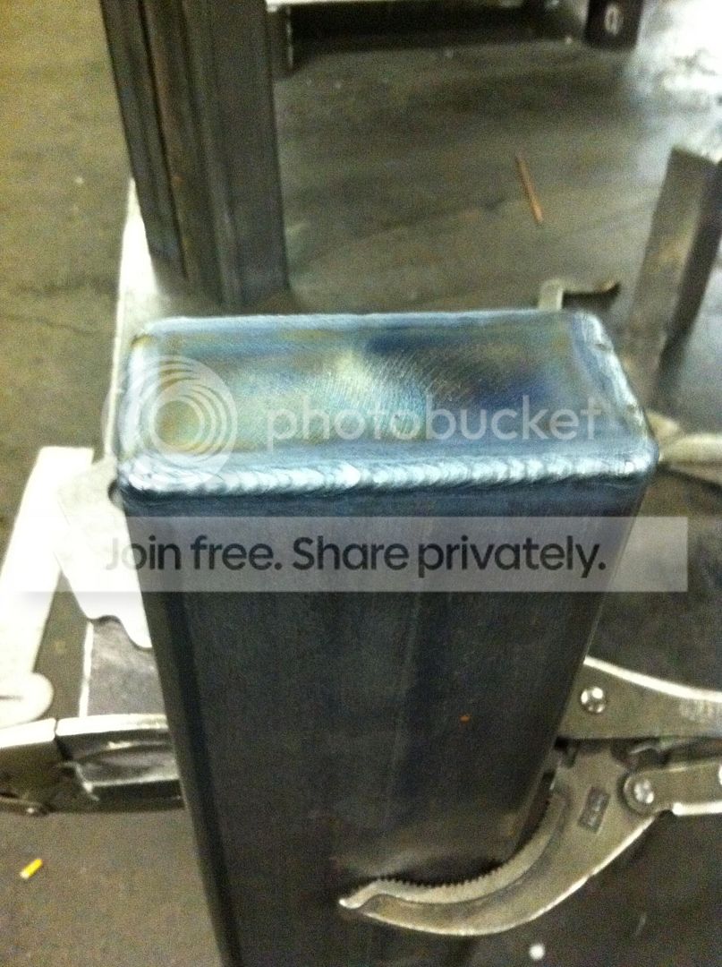

One end capped.

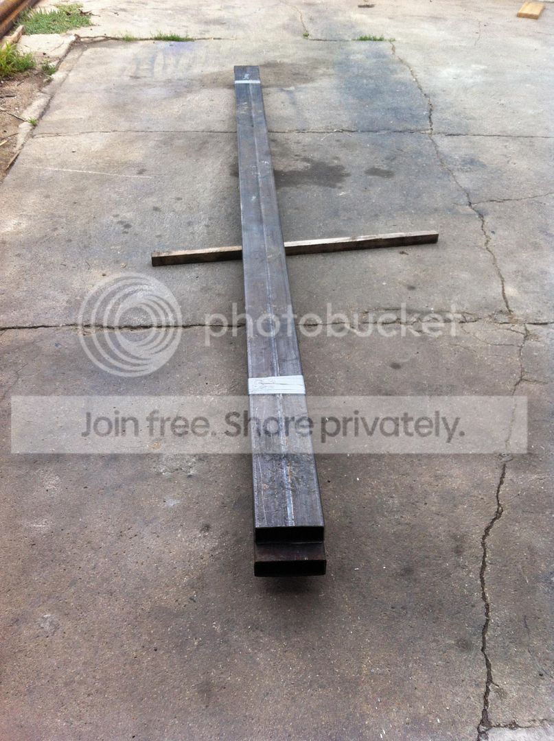

6" tubing arrived.
first cuts into the 6" tubing.

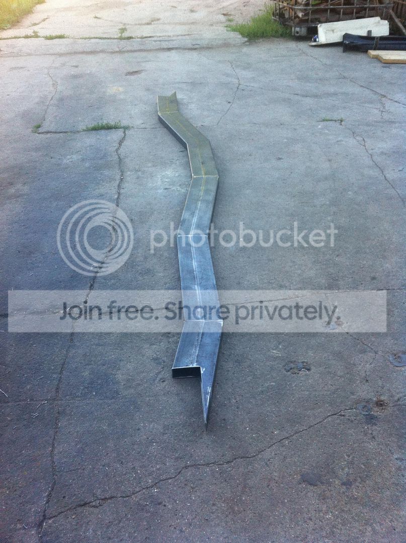

Center piece of frame rail.

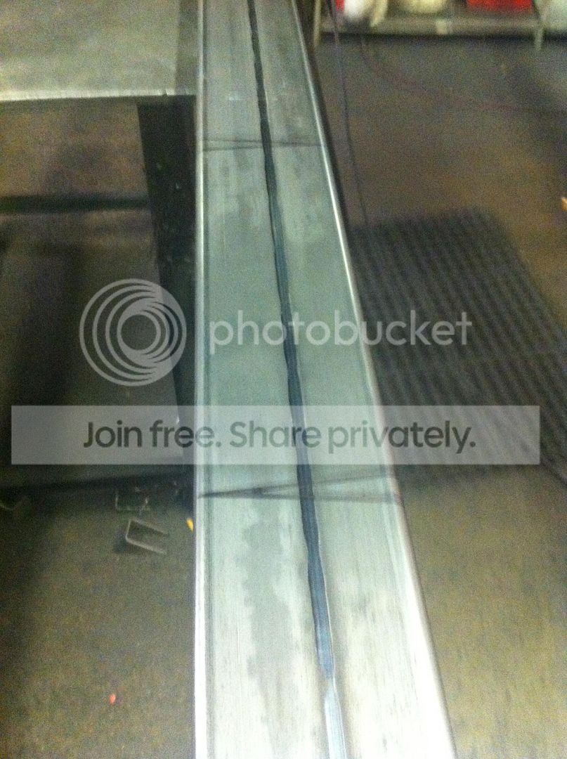

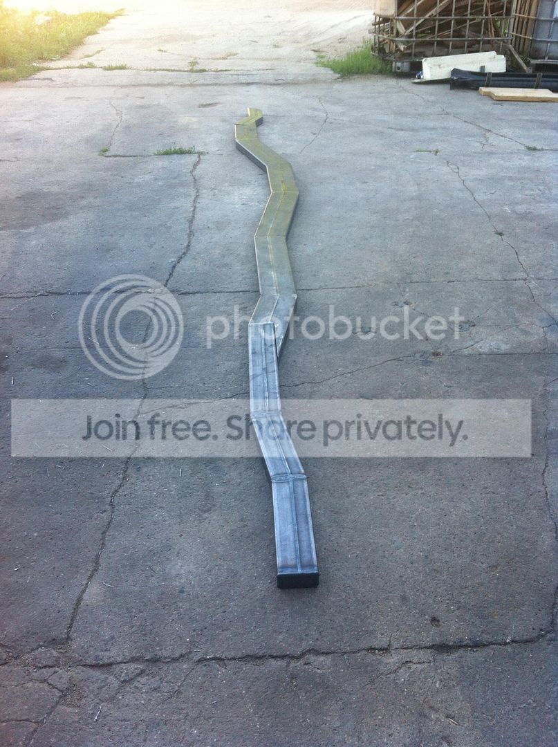

One complete rail.

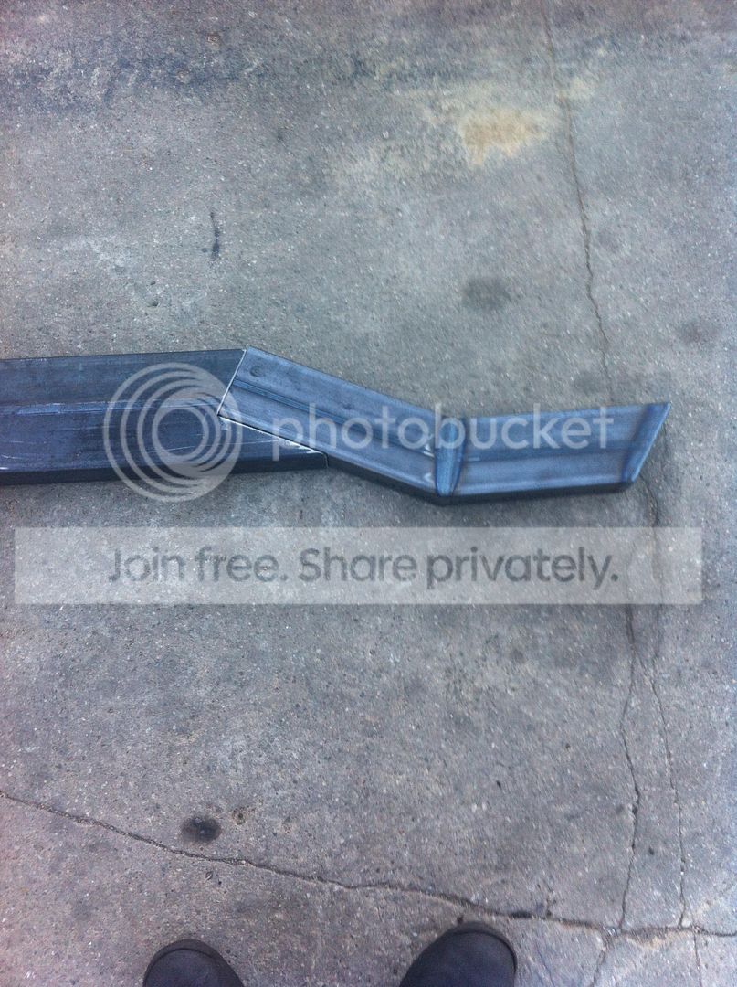

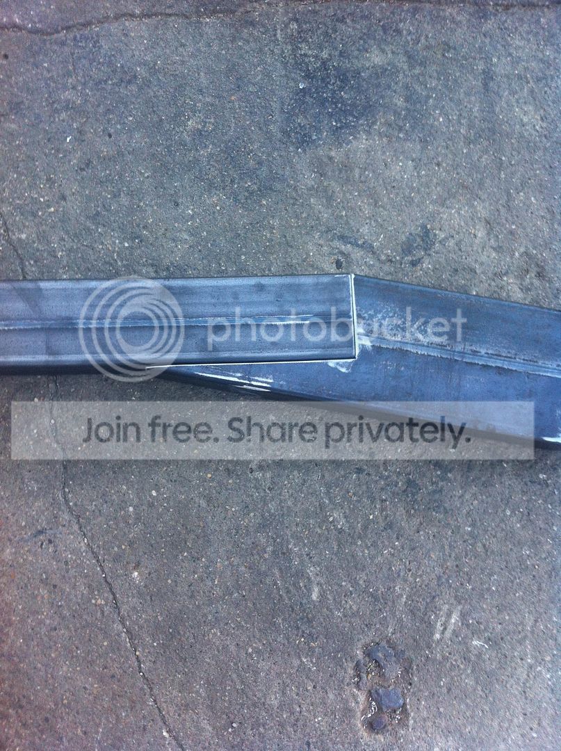

Detail of the 4" to 6" transition.

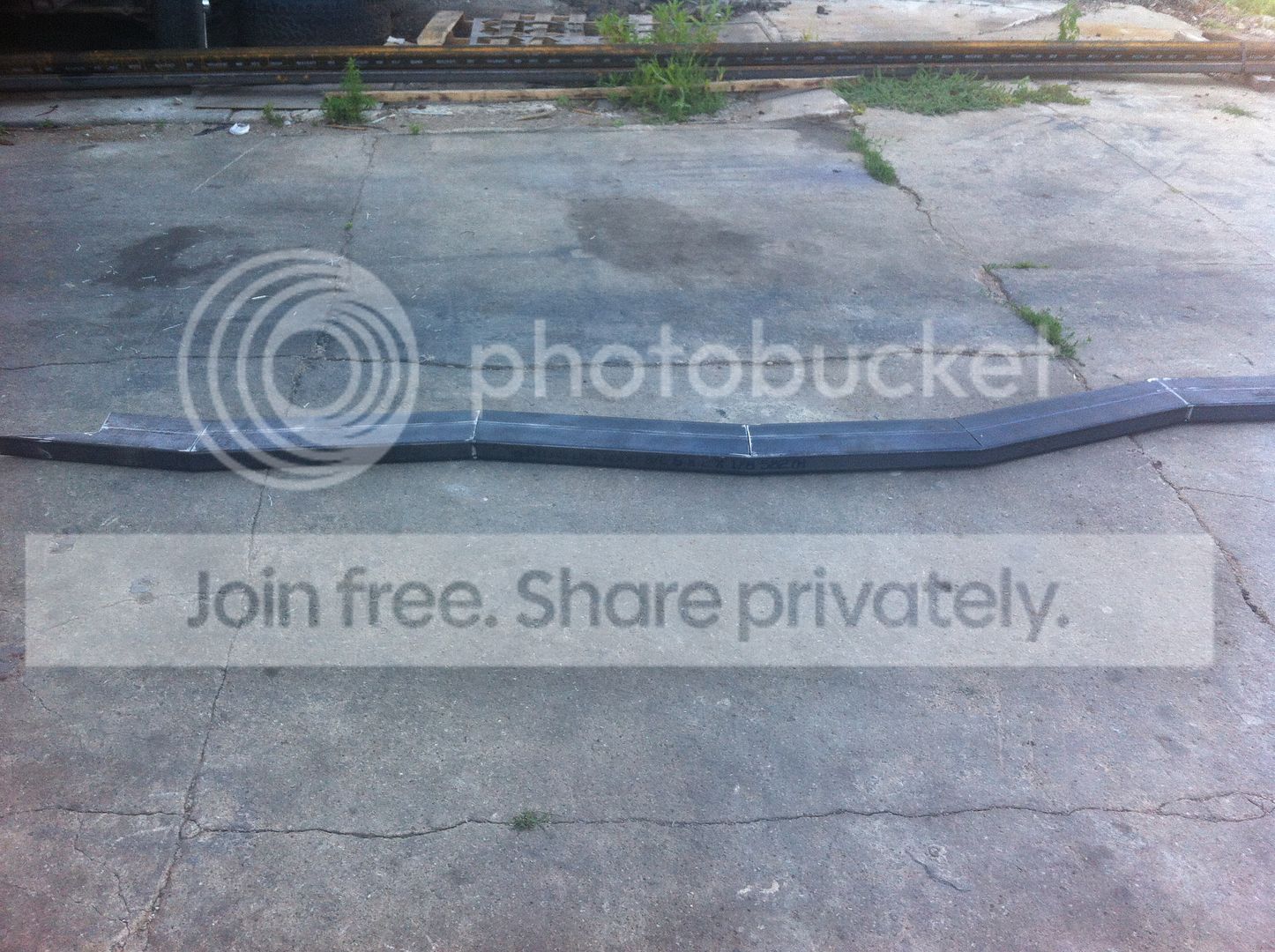

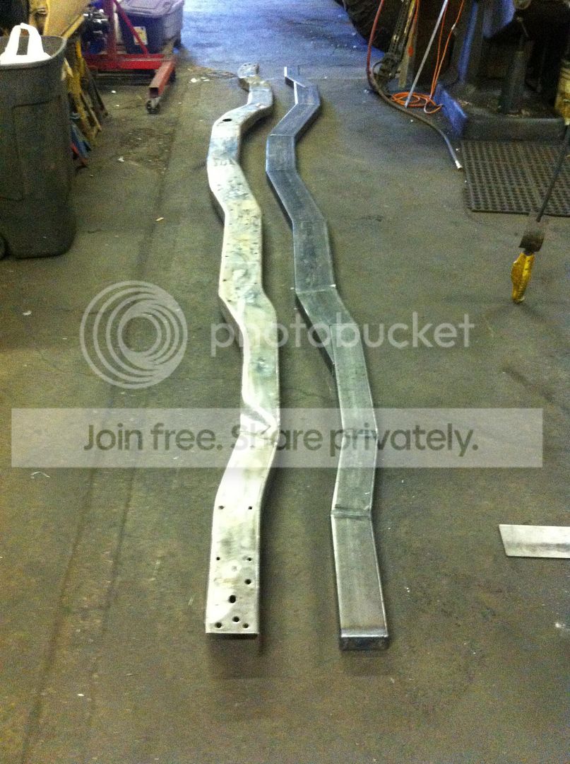

Factory rail compared to full new rail.
Lots of welding to do!

Do you know what the weight difference is (just with the one rail) oe v. square?
I'll try and weigh one today/tonight.
