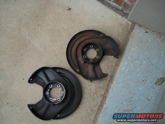

you did swap the backing plates also right? they are different.
here is a pic of the brackets i am using.
i cant figure out whats wrong.
