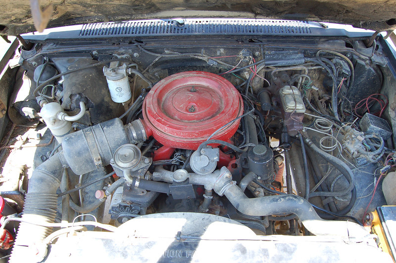

Finlay i can post pics.. here is what there is under the hood the rest of it is in tact.
Yes i know i need to clean it up and there is other work but my wife only has a week to 3 weeks left at her job and she drives a company car so i am going to loose mine to her and have to drive this.

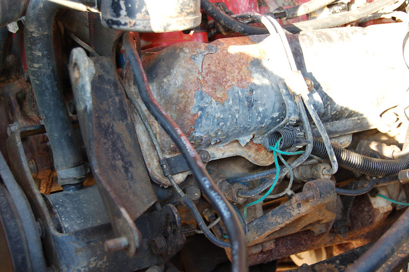

Okay so i got all the parts.. or so i thought.. i can not find the brackets. i thought i had them but cant make heads or tails of how it mounts up i think i am missing something.. Could someone snap a photo of there set up so i can see what it should look like....

Darn, I have a log and they mount differently otherwise I would post pics. I think they switched to the pancake around 82 so really anything in the generation with a small block and AC should have the brackets you need. I found mine at the JY after months of searching but the newer trucks should be more plentiful.
Ya problem is i can find any..... :dunno::dunno::dunno: Now i dont care if its the big or the small as long as i can find mounts to get it on..
So here is whats under the hood....
What more do i need... the parts i have that i thought would work dont..
I know it looks dirty.. this is a rebuild that got pushed up on the plans. Wife is with-out a ride so i need to get this one cooled off.

All of the mounts and hoses are different between the gas and diesel engines, so you'll need to get them off another 6.2 truck. It looks like a new evap box is in order, too.
