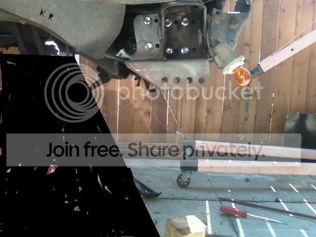

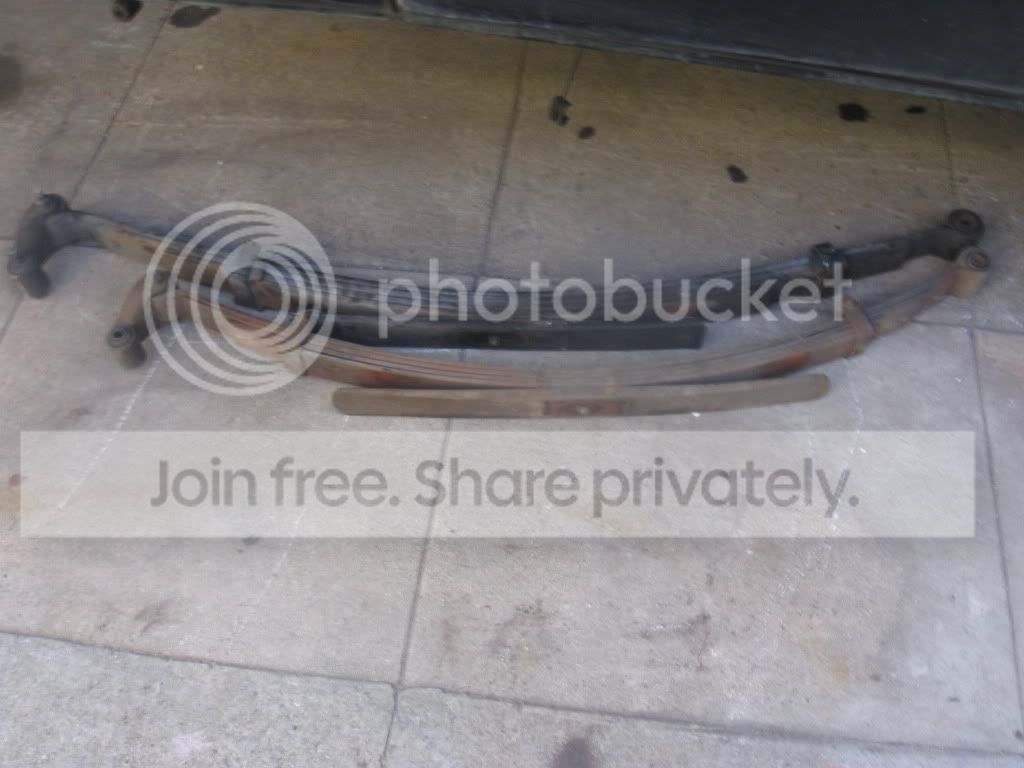

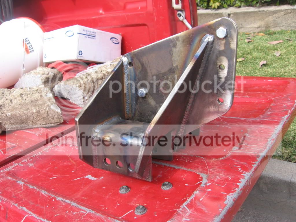

first on the list was to pick the k5 up a little, after much debate with myself I decided to not go with an off the shelf lift, so I planned for a 64" spring with a flip in the rear and b52 set up in the front.... I went to pick a part and yanked some rear springs off a later mid 90's burb, turns out they are 60" but I decided to go with them anyhow. I was going to leave the hanger in place and move the axle back, but it would hit the tank so I decided against that idea and figured I'd just move the hanger, after taking a better look at moving the front hanger of the rear spring forward, I didn't want to move or fool around with the body mount so I ended up making my own hanger which bolted directly in place of the original, I made it with options of moving the spring forward or back or I guess I could put the 64"s if I wanted later

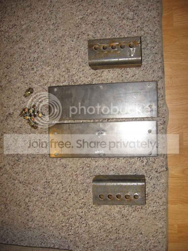

the plate that bolts to the frame
the bracket welded up

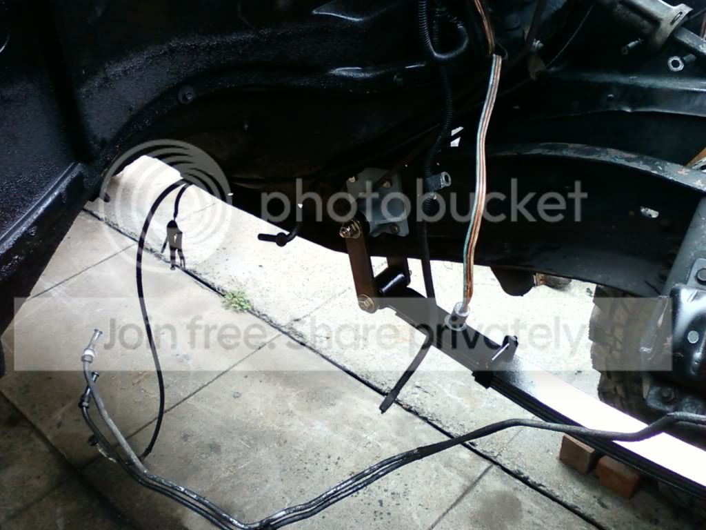

the last k5 I had about 10 years ago I did a down and dirty shackle flip where you torch out the bottom of the stock bracket flip the shackle and weld in a flat bar with a gusset, I liked it, but I did not like how squishy it was on the street. for this build I was planning on just buying a flip and switch, but I wanted options, I figured if I could get good angle to stiffen up the ride for street and hwy (maybe even towing...we'll see) and then get angle the other way to get good flex thats what I wanted, so I figured I'd make something like I did for the front hanger, I forgot to mention I did not want to weld to the frame so I wanted to utilize the holes for the original bracket, I still had to drill some extra holes though
I utilized some plates at work that were cut out for making a hitch ( saved on some cutting) I didn't take any pics in between but here it is painted and installed
heres the burb springs next to the 52"
heres the burb spring installed on the stock bracket, you can see where I was planning to cut the sheet metal

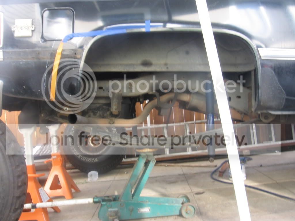

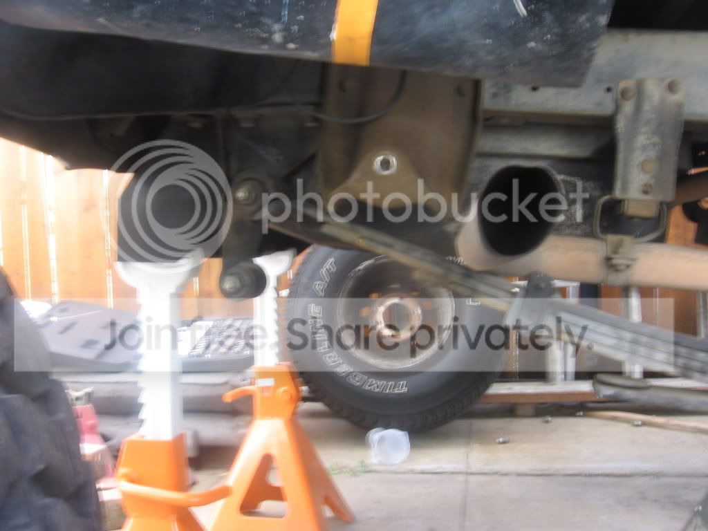

the rear of the blazer sitting on the ground with the 14 bolt
when I made the flip brackets I was in a rush, after all this I measured from one side to the other and I made them too close to the frame in relation to the front hangers, so the springs aren't parrallel to eachother, they are about an 1" closer to eachother in the rear....I posted the issue on here and after some good input from ck5ers I decided to leave it alone...turns out toyota tundras do this but to a more extreme degree, I guess it helps with stability....so my screw up might help me out (I'll find out for sure once I get driven it)

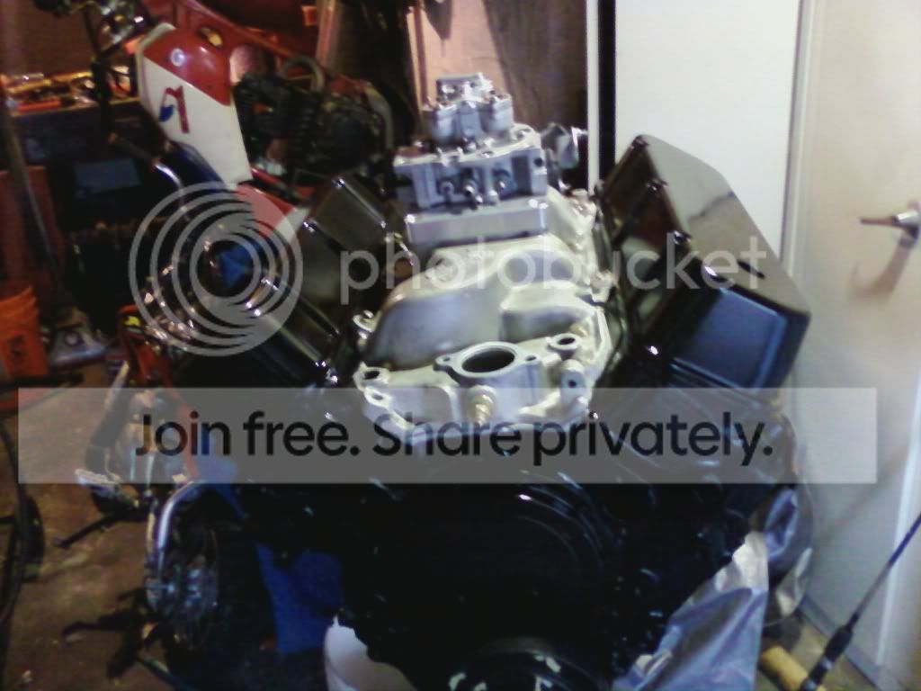

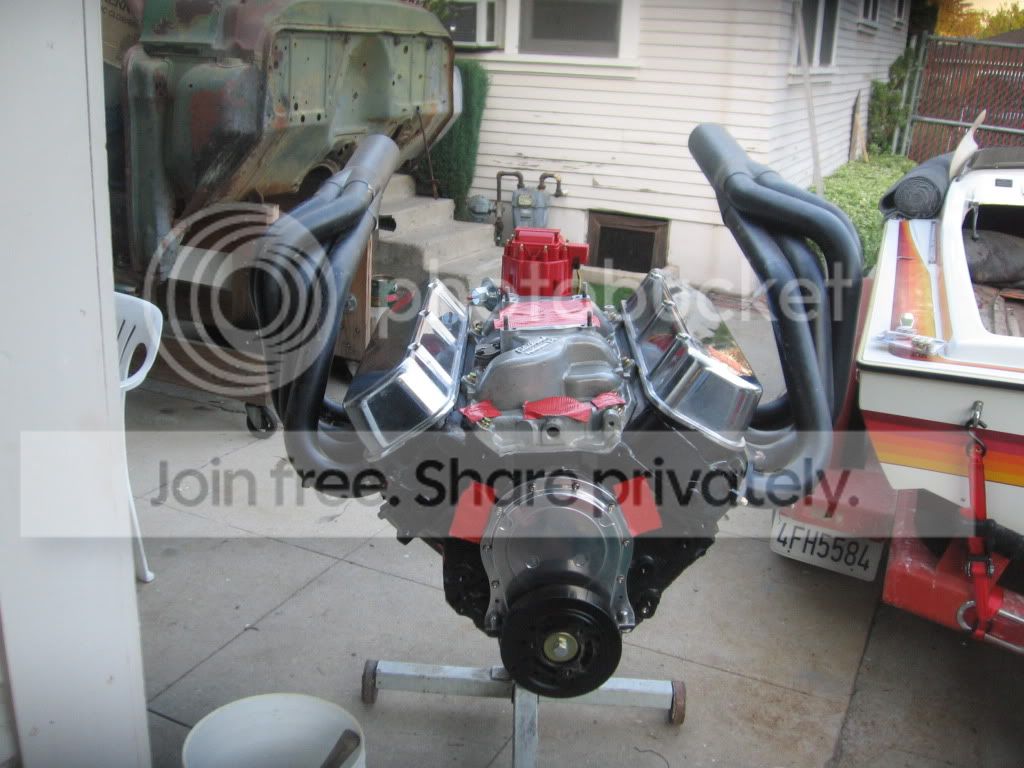

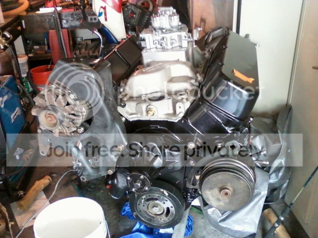

I was working on a boat before I took this on which I ended up selling, but I kept the 396 I built for it, originally I was going to use the 454 from the k30, but I figured after all the work I might as well use the 396 since it was fresh, all forged internals and balanced
woh, deja vu.. it's the motor out of my Chevelle.. same timing chain chain cover... don't tell me it has 427 heads... :haha:

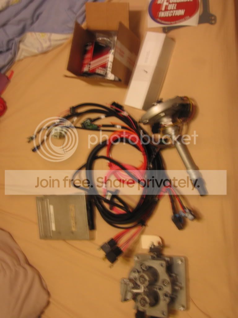

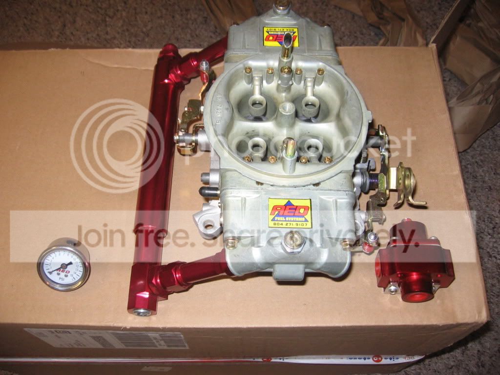

I had a bad ass carb (aed) that was for the boat, I spent some good coin on it, I was going to send it back to aed so they could rework it for the blazer, after debate about spending more money on it, and remembering how my last blazer ran (on inclines) a buddy of mine put a tbi on his jeep and was happy with that, I talked to him about the swap and he convinced me it would save a lot of headache and probably money in the long run to just buy the system from affordable fuel injection. he did his piecing it together and he ended up getting a harness and some other stuff from them so I decide to sell the carb to help pay for the TBI set up
the carb (I ended up selling it on ebay)
the tbi set up from afi
close it's a 396 from a 1969 "pass hi perf"
it's a 2 bolt though and had a cast crank probably 275 hp or 325 hp motor, when the guy who built the motor ground the crank he had to go 30/30, I told him to throw that bitch in the trash, I found a forged crank, forgot the number on it, I think it was 6223 or something like that paid 50 bucks for it cleaned up 10/10
heads came with that motor closed chamber oval ports...nothing special
yeah, my 396 had a 10/10 forged and 2 bolt too.. 427 closed chambered heads, solids, fun...

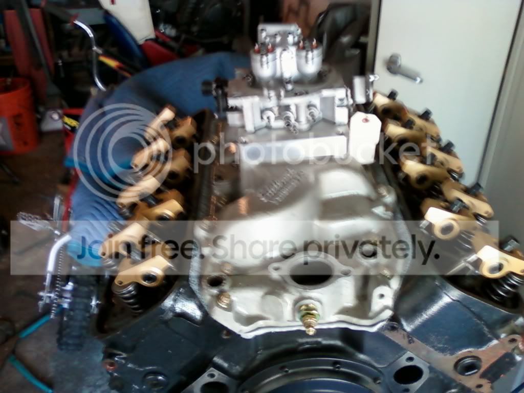

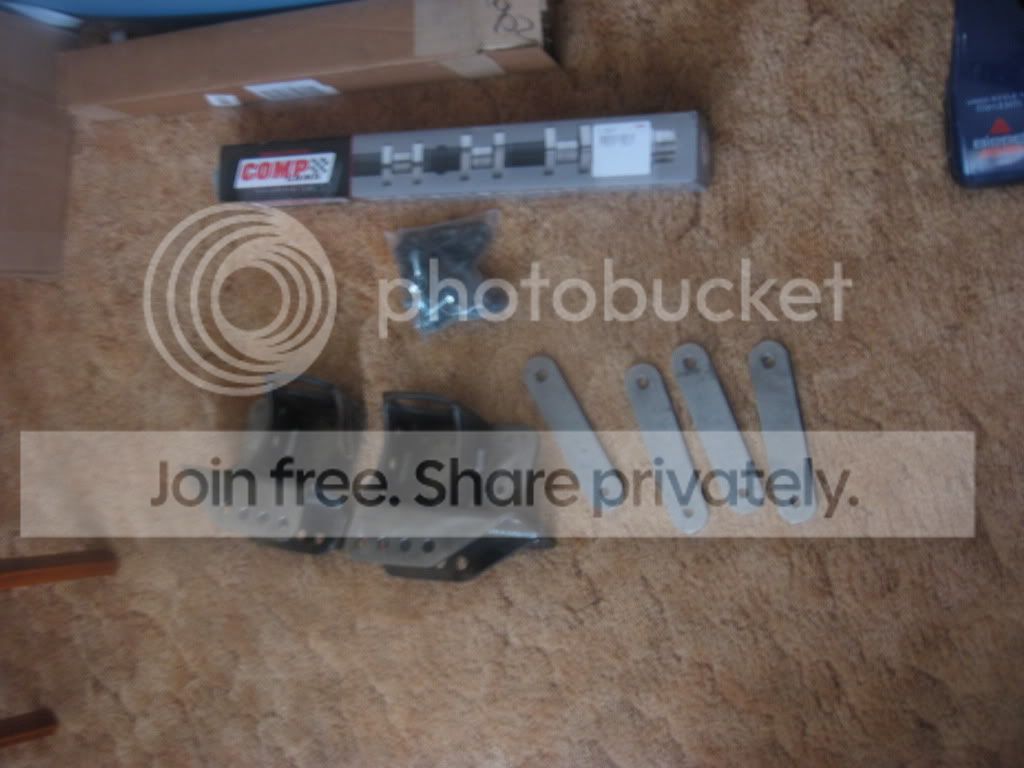

the cam in the motor was not going to happen with the tbi, so with afi's recommendation I bought a comp 255 deh, I also got the b52 brackets at the same time

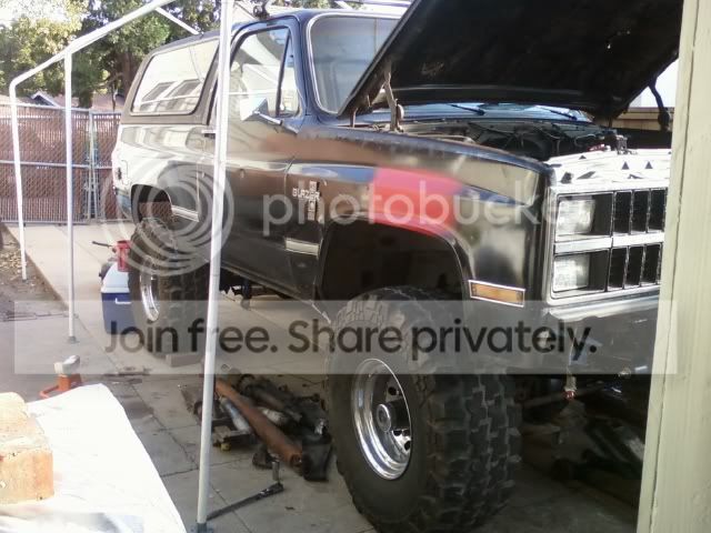

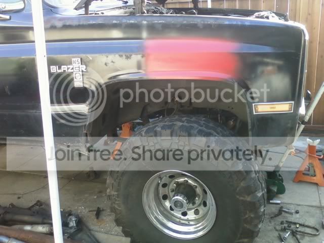

here's the front end, I forgot to mention I put in some ez inch blocks with it set 1" forward...not sur if I like it, I have the spring in the furthest forward hole on the b52 bracket with the ez inch... the tire is right up on the front of the fender
the shackle hanger brackets on the front suck so I got new ones from diy4x, some say to move the hange forward for more shackle angle and flex, but I intend to drive this truck to the desert as well as driving it in the desert so that extreme angle isn't really practical for me...at least from what I think, later I might put longer springs as well so I might scrap the b52 brackets and fab the front of the frame to accept 64" springs...but that later, oh yeah I need to get some spacers or offset shackles because they aren't perfect inline, but thats minor details

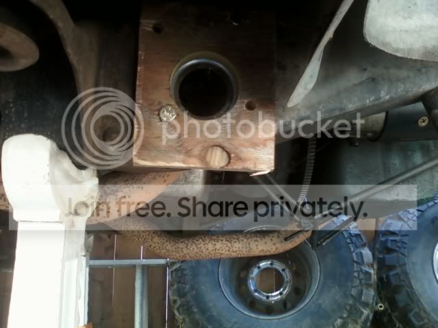

heres a template I made out of wood for opening up the hole in the frame with a hole saw
heres a shot from inside the engine compartment
this weekend I finished swapping the cam out
decided to paint the valve covers and timing cover...I like it better
