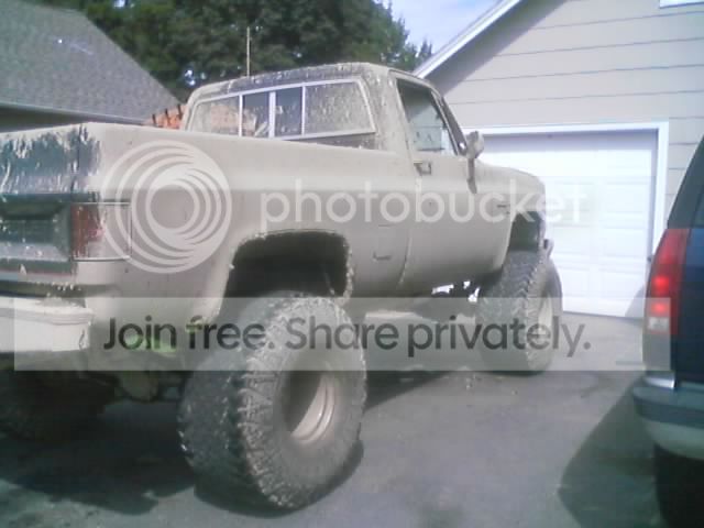

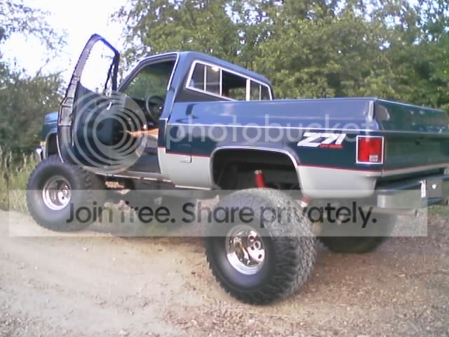

I bought it in 2006 with 32K miles and how it is in this pic for 900 bucks from a cop in my town! Iv kept my eye on this truck for about two years, i guess he didnt want to sell it to anyone but i was a good kid and his wife wanted it gone he let it go for me right before i turned 16, Its a 82 on a 76 chassis, it Came with a 6 inch superlift kit with blocks in the rear, 3 inch body lift, crate 350 motor and a semi built th350, dana 44 front, 12 bolt rear, both stuffed with 4.56 gears, and some 39 worn out/dryrotted mickey thompsons baja belted
After some hours wet sanding and buffing it, the paint turned out pretty good for its original paint
and a poser shot

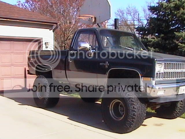

That summer i mudded the crap out of it and drove it as my daily driver and ended up with a blown trans, i thought it was the pump seal because it was pissing fluid out the front seal, so i dropped the heavy ass 205, and the 350 myself at the age of 16 and replaced the seal and put it back together, but after running it for a few min it started pissing out the seal again...
Time to pull her out again.
sitting with a blown trans...
I ended up getting it rebuilt but some trans place and installed it back in with a shiftkit and drove it everywhere after that.

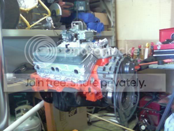

Well my buddy lended me some cash and i had some saved up from selling my hydrolocked shortblock with a bent rod and some heads and intake i got for free for 200 bucks. I started building another 350 and has more plans for power in this one.
I installed a comp cam extreme 4x4 cam in there, slapped my vortec heads on and ported and polished them and gasketmatched the ports, installed my old intake and holly truck advenger.
I installed that motor and got it running a week before our tripp to badlands to offroad.
Heres the motor installed

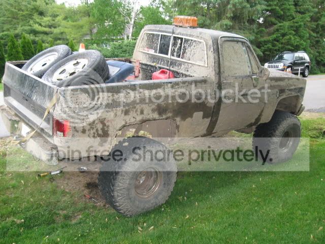

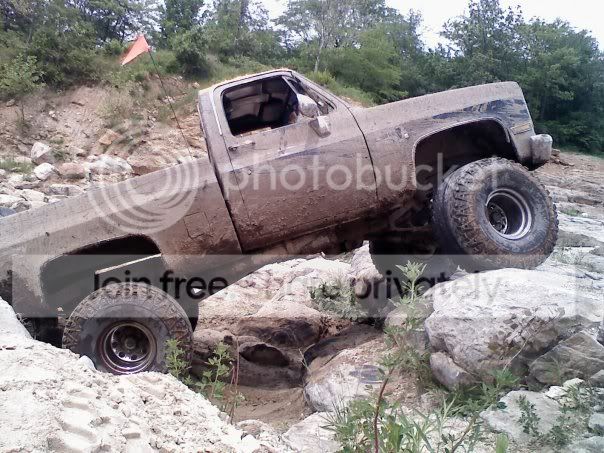

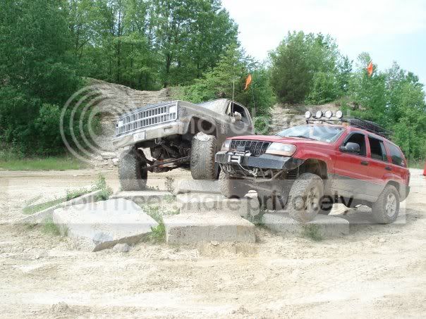

well i had a blast memorial weekend at badlands, my truck did amazing and i was surprized on how well it did in everything, mudd boggs, rock climbing, trails and how it made it there and back on the ****ty tires.
My buddy and i built the front bumper on his WJ before badlands also.

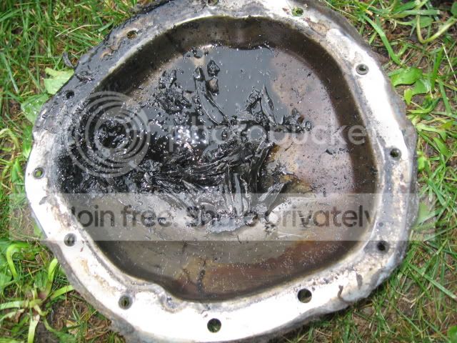

It got some trail damage but about ten miles leaving out campsite on the freeway my rpm's just shot out the roof. I thought i blew my trans or something so i check my gear and its in gear, i knew once we stoped and i tried to put it in park and heard the grinding and the truck still rolled, i got out and what do you know some holes in my diff cover, i pulled the rear driveshaft and drove home i front wheel drive, it got my home but i hated doing it. It made a two hour tripp last 6 hours.
pulled the cover and i had a stripped pinion gear and it was low on fluid so i guess i ran it low on fluid and overheated it.

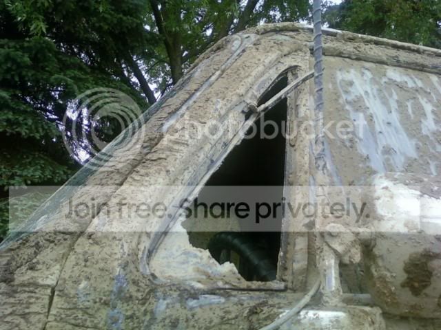

broken wing window from backing up and a tree cought it.

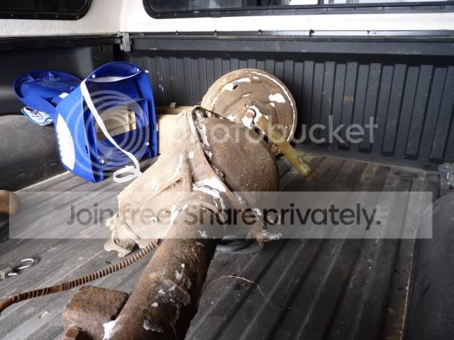

The truck sat all of 09 summer and i finally got a job and saved my money and found a set of axles with 4.56 gears and detroit truetracs front and rear, dana 44 and 12 bolt, so i bought those for 675 bucks for both and got to work cleaning and painting them and installed them fall of 09.
Axle removed
Buddy of mine doing some of the Bi*** workk on my old axle removing stuff
installed pics are soon to come...

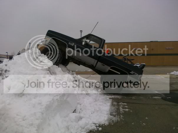

I got that installed and finally was able to drive it again and had some fun on some snow banks

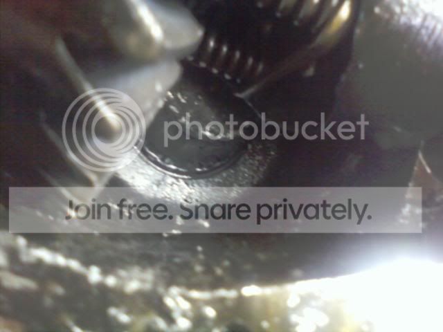

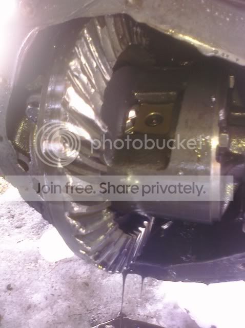

Well about two months on that 12 bolt i hit my shifter into reverse on accident and bye bye 12 bolt #2. This time i stripped my ring gear...time for a 14 bolt, had to source down some tires and rims and front end parts
Ring gear

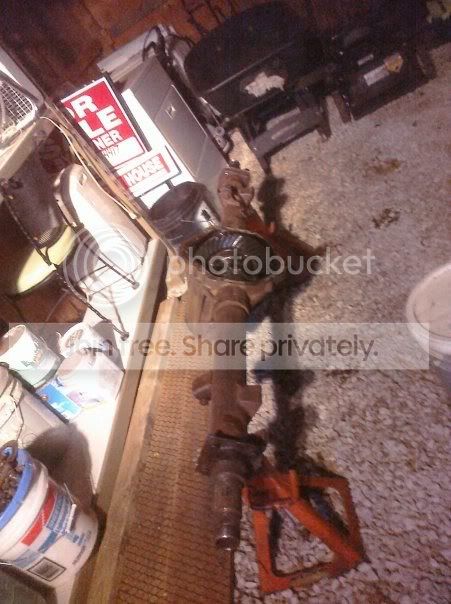

truck sat for about a month then i found a guy on craigslist that was looking for a dana 44 with 4.56 gears and i had my old one laying around so i traded him the axle and he gave me a 14 bolt ff he had laying around with some good rotors that needed to be turned and $100 bucks.

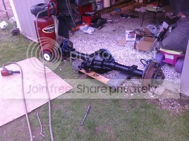

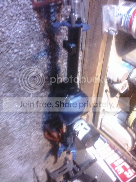

I got started on stripping the 14 bolt and prepping and cleaning it and painting it
it being delivered
cleaning it
and it painted

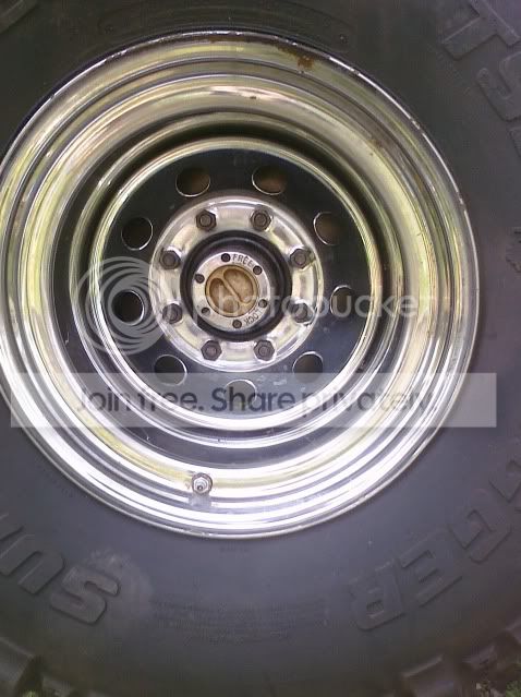

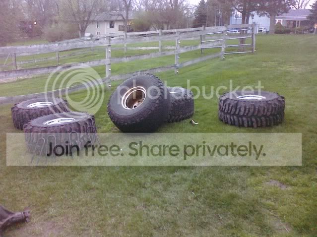

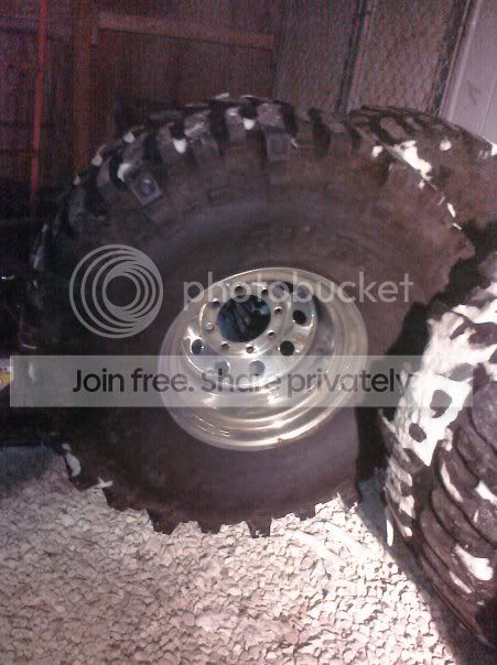

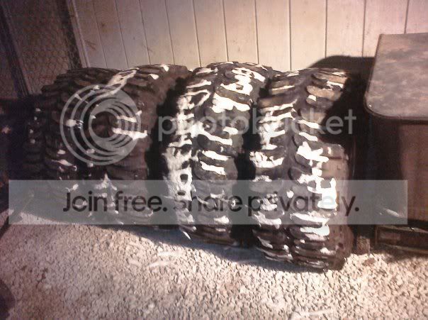

While im building the axle i found a good deal on some 39.5-18-16.5 boggers on 8 lug rims and decent tread for 400 bucks.
im gonna run those those till i can get some rims for the toyo's i also got a good deal on (225 for all 4), 4 toyo open country mud terrains 37-13.5-18. still deciding on what rims to get, possibly rockstars or the hoss's

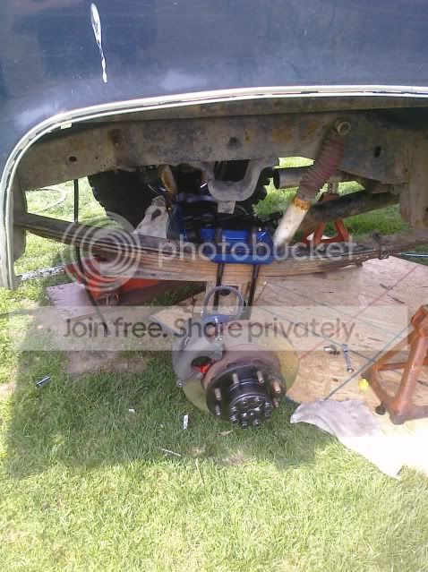

I got my rear hubs on with the rotor and went to slide the caliper onto the disk bracket with the pads in it and the inner pad is a tad too thick, im not too sure if its the pad, the rotor, or the caliper, i used the bigger 3in piston in the caliper if thats gonna change it? anyone?
Im still waiting on my timken bearings for the carrier and my front timken seals for the front hubs and new wheel stud's, hopefully i can get this axle installed this week

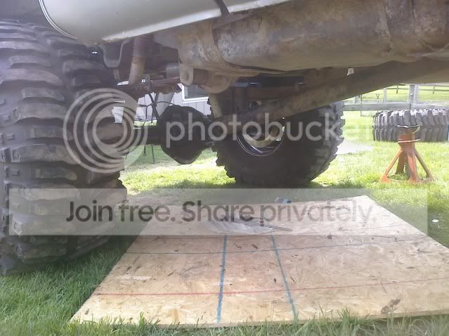

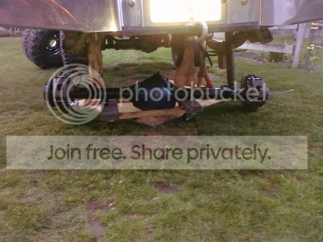

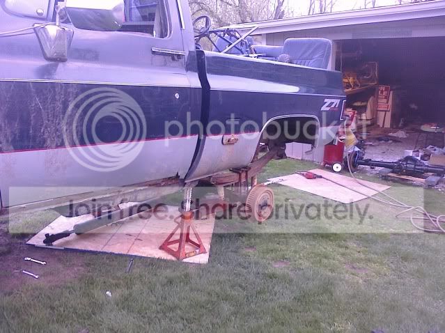

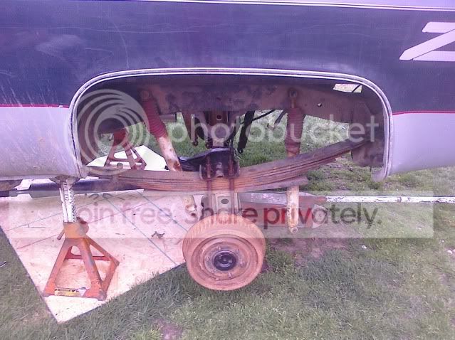

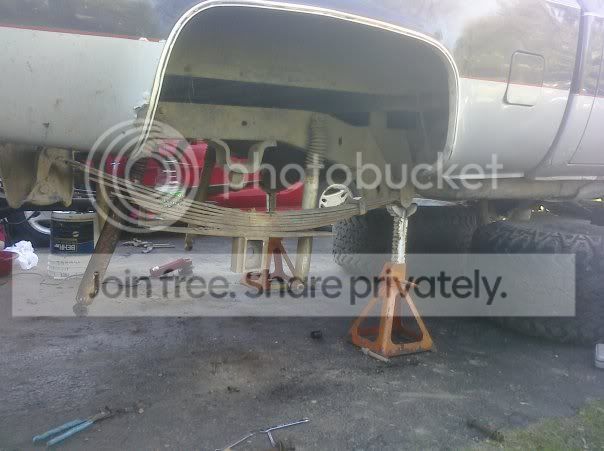

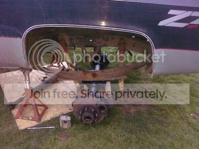

Well heres some updates on what i have got done. I got the axle installed and the truck going in a few days i had to work on it in the daylight.

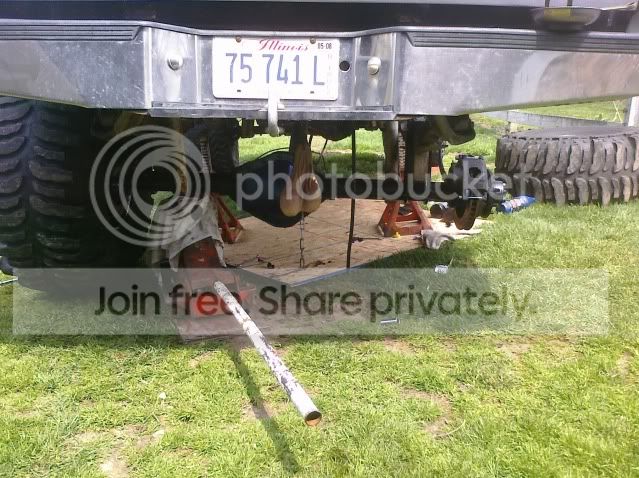

Heres the old 12 bolt getting ready to be removed

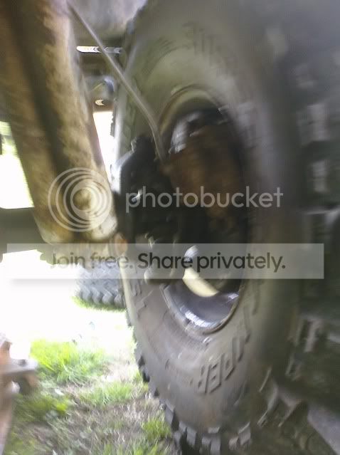

The 14 bolt ff ready to be installed and it being installed, The damn thing is heavy and a pain to hassle around. I got the brakes stuff all sorted out and going. Im using the stock proportioning valve and stock master cylinder and it seems to work pretty good, if i tap the brakes once before i stop and press them again they work like a charm, wayy better then drums.
It all bolted up

Tires laying around the yard

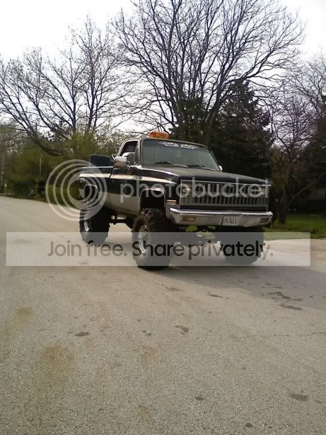

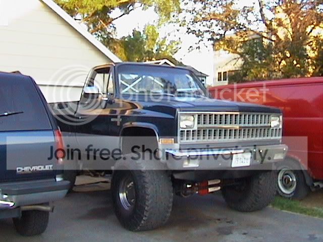

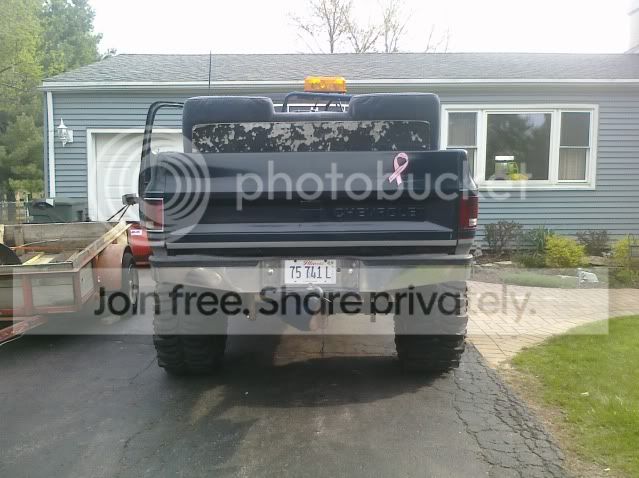

Heres the truck all done
I love the stance the boggers give it.
Still gotta finsh a few things and wrap it up, but im able to drive it :)
