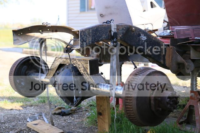

Had this for along time did lots of wheeling. Mild lift 63" rear springs. Parts from a 89 tbi truck.
Then got married kinda lost interest almost sold her but didnt.

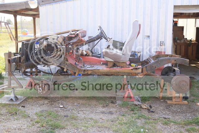

Then one day I'm looking at the battery body and soon a grinder and Sawzall within reach.
Currently like this.

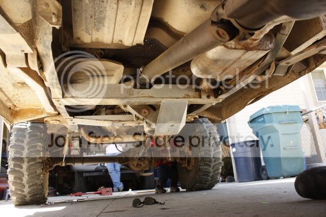

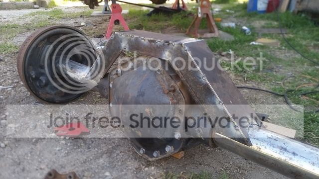

Double triangulate the front and rear.
Was going to order tube for suspension links but I'm stuck deciding on 2" Dom or 2"square tube. Square 2"x.25 wall is a fraction of the cost.
Suspension links will be 40" or so probbly have to redo my crossmembers.
Also want to get rid of the boat anchor transfer case

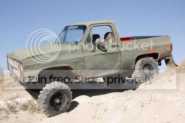

What escalated?
This.
To this.
Martin
Ohhhh it was a 6 year process. The shell got so beat up in the rocks it was no good doors wouldn't shut anymore.
I half thought about doing a 4 door cab but the fenders to take up to much realistate. Not to mention I was stuck wedged in rocks because sheet metal was contacting before rubber

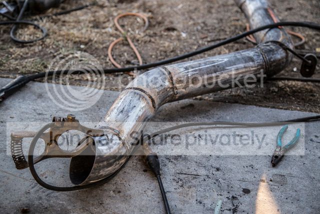

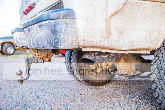

My cummins exhaust I fabbed from down pipe to the exit.
Sorry I'm bored. Egt still run high so thinking to go 5"
