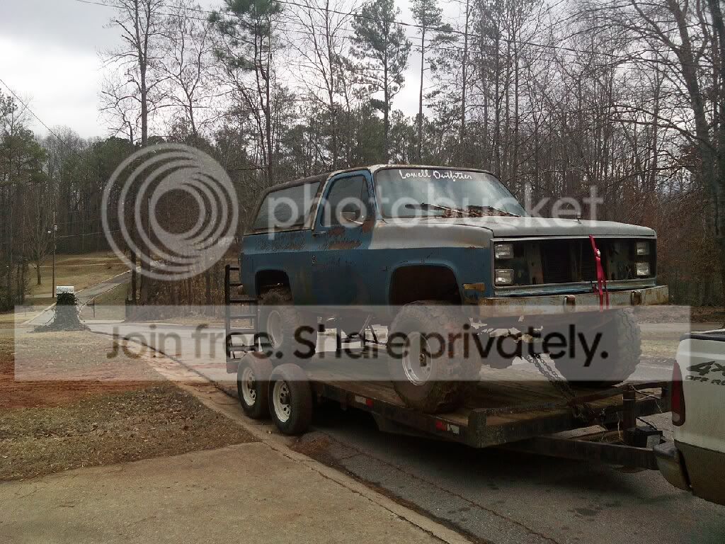

im budget building a 83 diesel blazer with a 6.2. i wanna use a manual instead of the 700 but im not sure where to start. will a gasser trans work with the diesel and does the diesel starter still work with the gas transmission? a gas starter wont have the power to turn the higher compression diesel. and will the transmission have any issues with not being street drivable? i dont wanna top out at like 35 lol
