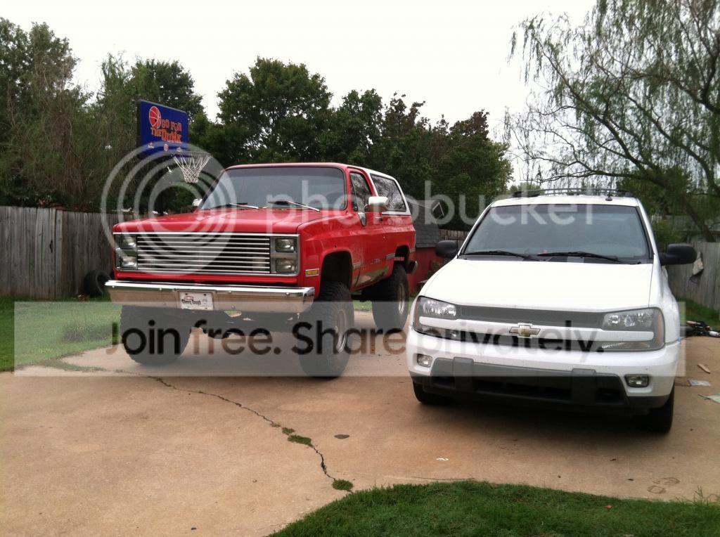

This the earliest photo I have, sitting next to it's younger cousin, the 04 Trailblazer.
1983 K5 Blazer
Strong 350 with TH350, NP208, two 6 lug -10 bolt axles, rear Gov Lok, 37x12.50x15 Good Year tires, 4 lift springs in front, 4" cast + angle blocks in the rear, 3" body lift.

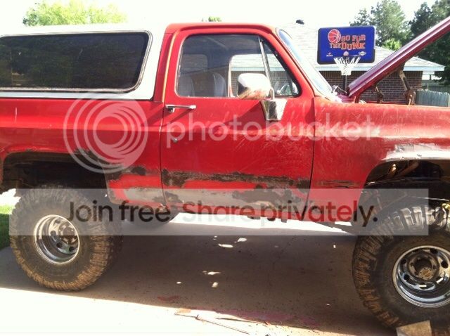

This is what I found when I removed all of the stick on chrome. A rusty water trap.
