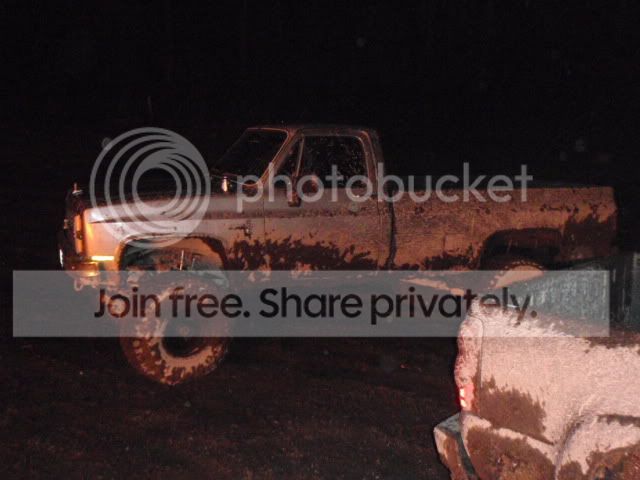

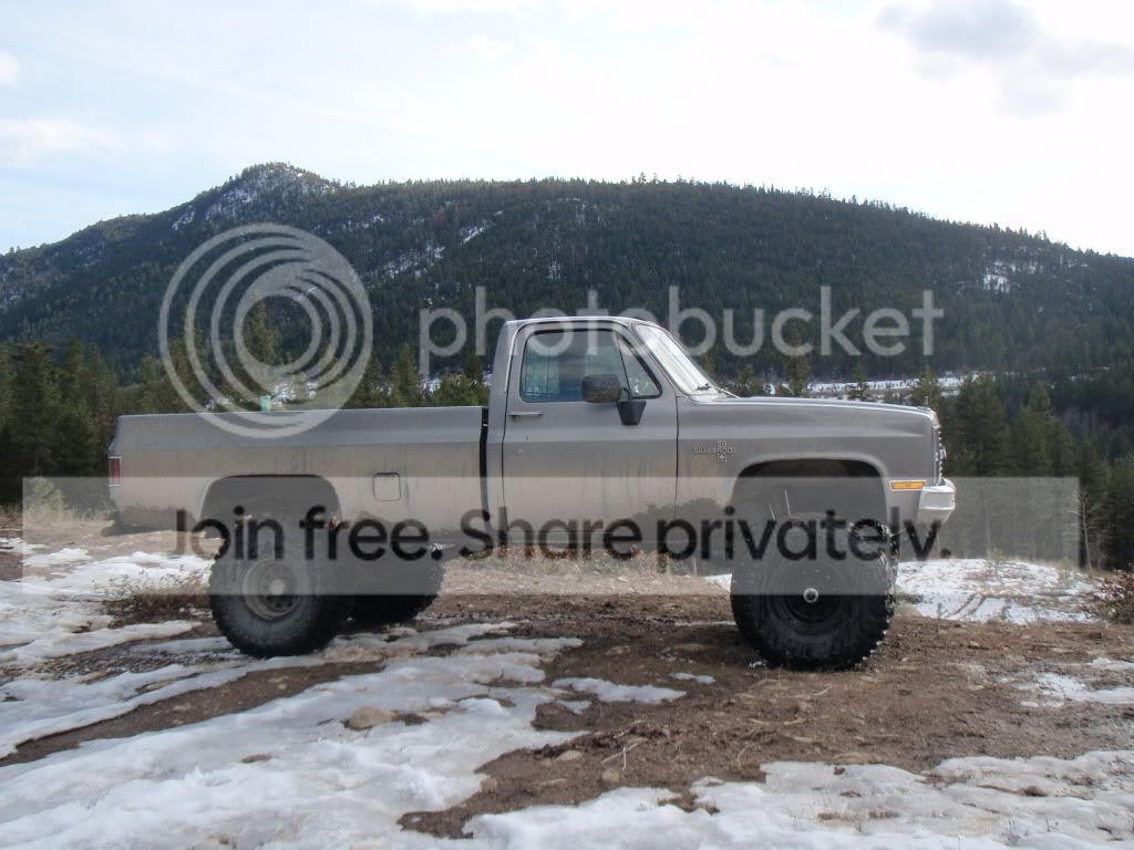

Here it sits a bone stock '83 silverado k10

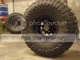

8" Lift Springs & Some 37"x14.5" Toyo MTs

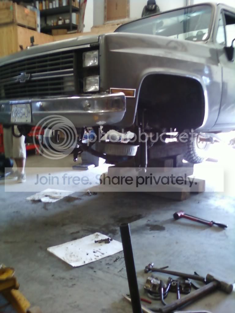

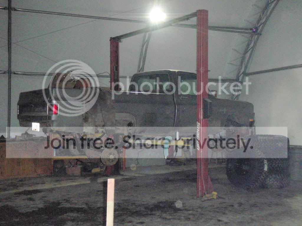

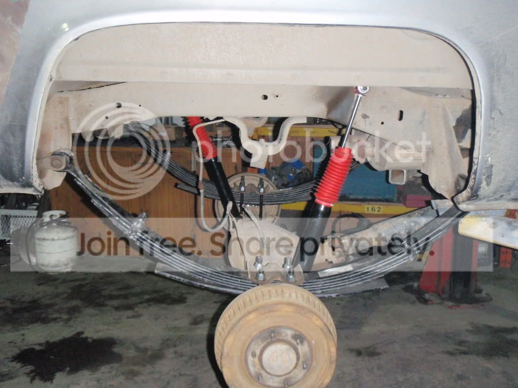

A few pics of the lift going in.

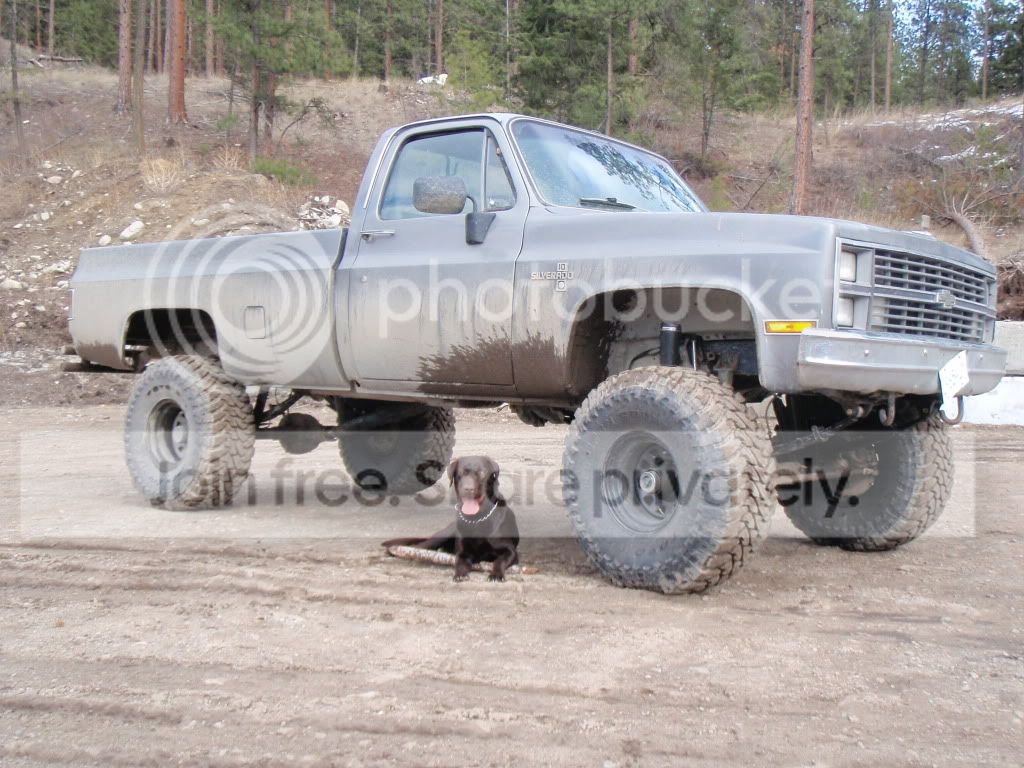

Lift in and sittin nice.

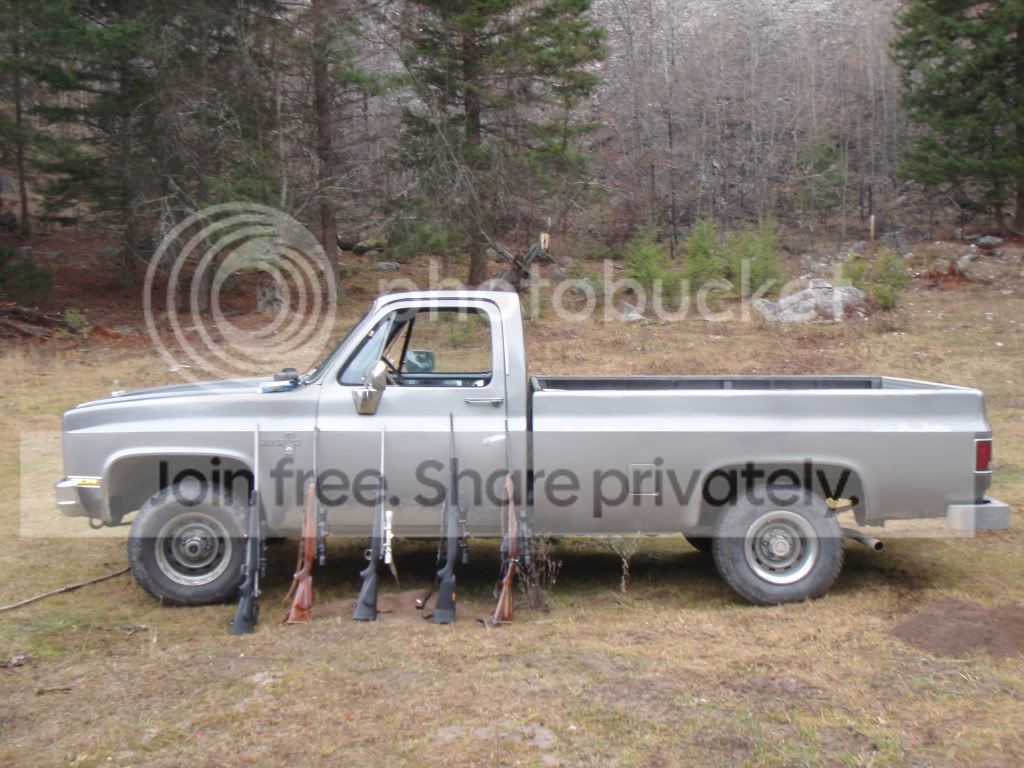

good looking truck. I had a 79 that was very similar to that color, I kinda miss the thing but there wasnt much left under the nice appearing chinese replacement panels.

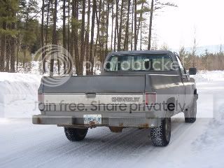

Broken rear springs or is it parked weird?

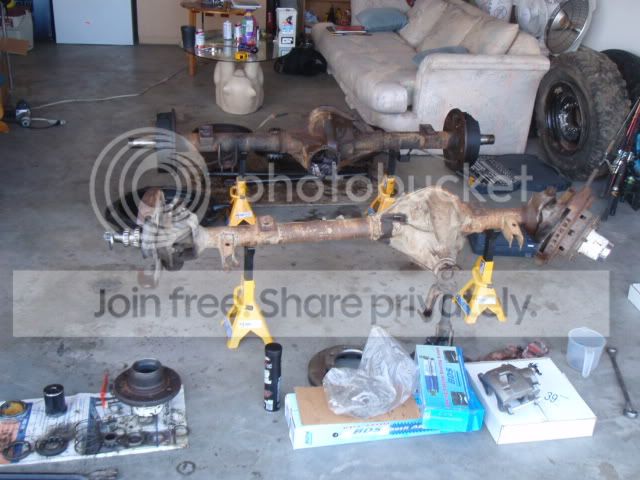

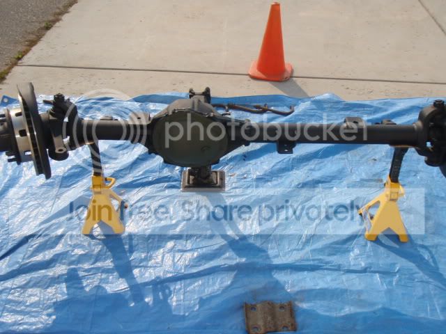

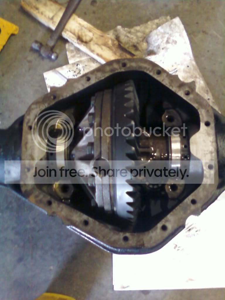

Some picks of my axle built for my ff14 bolt, 4.10 gear, detroit locker, 3/4 ton axle swap.
Recon:
Thanx mann MANY SLEEPLESS NIGHTS of jones'n and wrench'n!

The 8" lift springs and components are from skyjacker, and i used BDS shocks!!
Any issues or problems come up with the 8" lift such as drivelines, steering etc ?
Nice truck by the way
twojoints44, like the long bed reminds me of the first ones I had, truck looks real good.
I have 8" skyjacker springs on my blazer. Just had to grind the tabs on the front CV, lowered the transfer case for the back. I built crossover steering for mine (some 20 yrs ago before you could buy a kit), but did have a steering block and arm on there before that.
