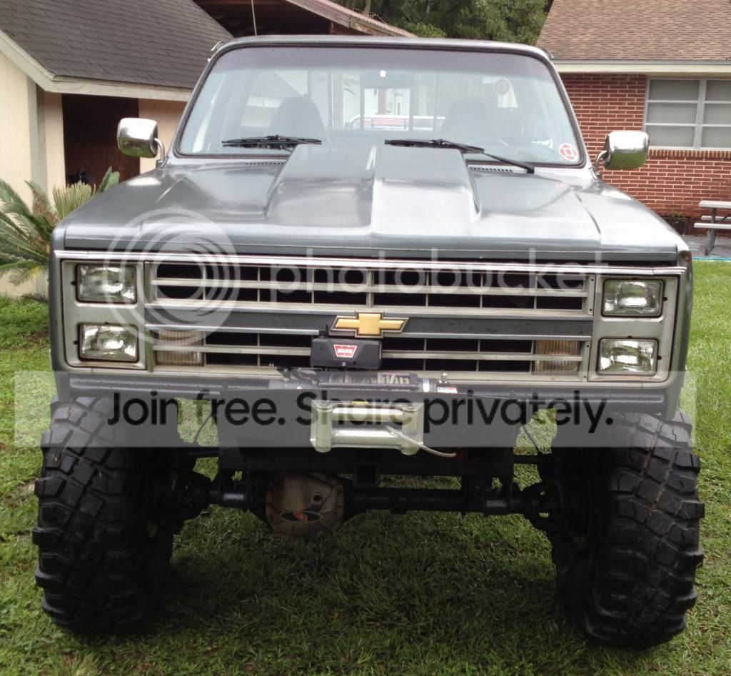

I bought this truck from a friend fairly built so I cant take credit for the base build but the finishing touches will complete a already capable truck.For starters:
1984 K10 stepside
2001 5.3 Vortec v8
-Mild port/polish on heads
-Thunder Racing cam
-Cts Insight monitor
- mild programming
- Headers
- duals running into Flowmaster 40 series mufflers
4L60E tranny/NP208 case
-2500 stall TC
-Red Alto clutches
-5-planetaries
Dana 60 front end with 35 spline outers
-premium hubs
-crossover steering
-Eaton E-locker and 51.3 gears
Corp. 14Bolt rear
- discs
-Detroit
-5.13 gears
Suspension:
52" 5.5" front springs
56" 4" rear springs with shackle flip
- no blocks and no Body lift
Tires:
325/85r/16 Michelin XML's
16x10 ION wheels
Warn VR 10,000 winch
damn! you got an already LS swapped, lifted, 'tons, clean paint step side? what else is there to do to it?
Got a few dents to fix,get ac up and running,add a rear gas tank,only have a single 14 gallon right now.just a few odds and ends.always wanted a step side,now I got one.

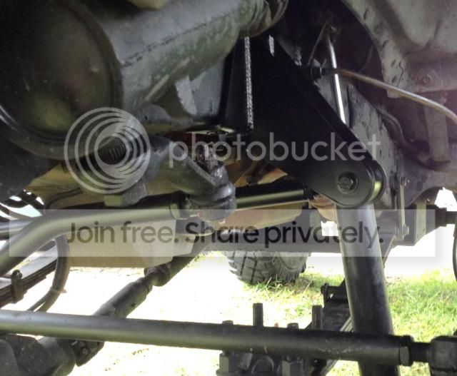

I know its a mixed opinion but Im putting a Sky Panhard bar kit on tonight to see if it helps with my on road manners
got the Sky panhard bar installed,drives much better,no leaning around corners,zero bump steer and no frame flex and shackle flex when turning while driving slow.Everything lined up and am dead on the same degrees as my drag link.
That things beautiful! Good information on the panhard, I may have to see if they have one for my setup. I want some of those little XML's so bad.
If that had a manual transmission in it, it would be pretty close to perfect.
Martin
Nice to cruise with a cup of coffee ,but some days it would be nice to row through some gears :thumb:
