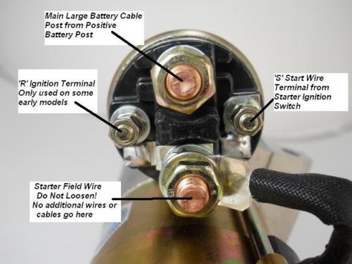

A while back I had a similar issue. I had a high torque starter from summit that had electrical prongs for different applications. Make sure that even though you jumped it while under the truck, the terminals have the correct polarity

Start at the starter, make sure the connections are good. Use a test light and work your way back until you find the issue
Found out the problem, the ignition switch was broken something must have happened when I took it out to do the swap. Took it apart and cleaned it and it still didn't try to start so I bought a new one and it worked. Thanks for the advice.
