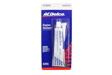

I think I found a sealant that might actually work, so far no leaks. I went to the GM dealer and talked to the service dept.
They recommended this on everything. So far so good. It sets up fast though. And not cheap.
