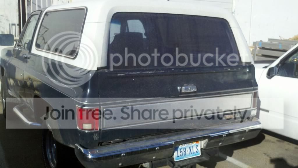

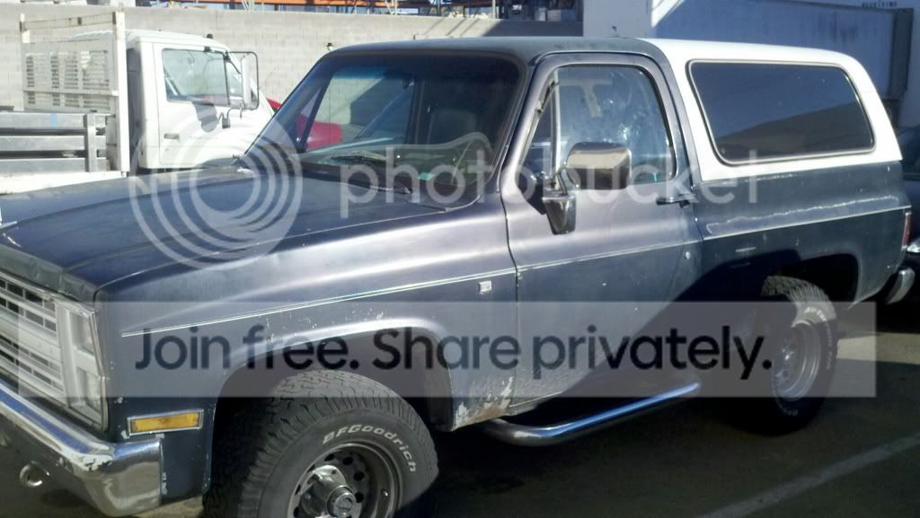

I have wanted a diesel K5 ever since I had my old K5 in high school and last December I found one. I picked it up for $1500 and have been working on it since. Here are the only pics of I have it before I started on it.
The main thing this is going to be used for is a daily driver everyday to and from work. It is also my hunting truck and for towing my 6x12 enclosed trailer and quads to the sand dunes.
It came with no lift, 32" tires, 6.2 detroit diesel (naturally aspirated), 700R4, 10 bolts front and rear, NP208.

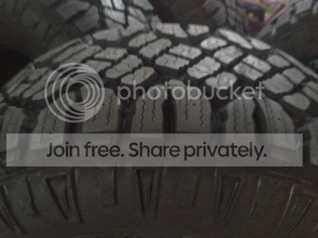

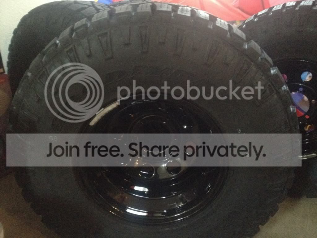

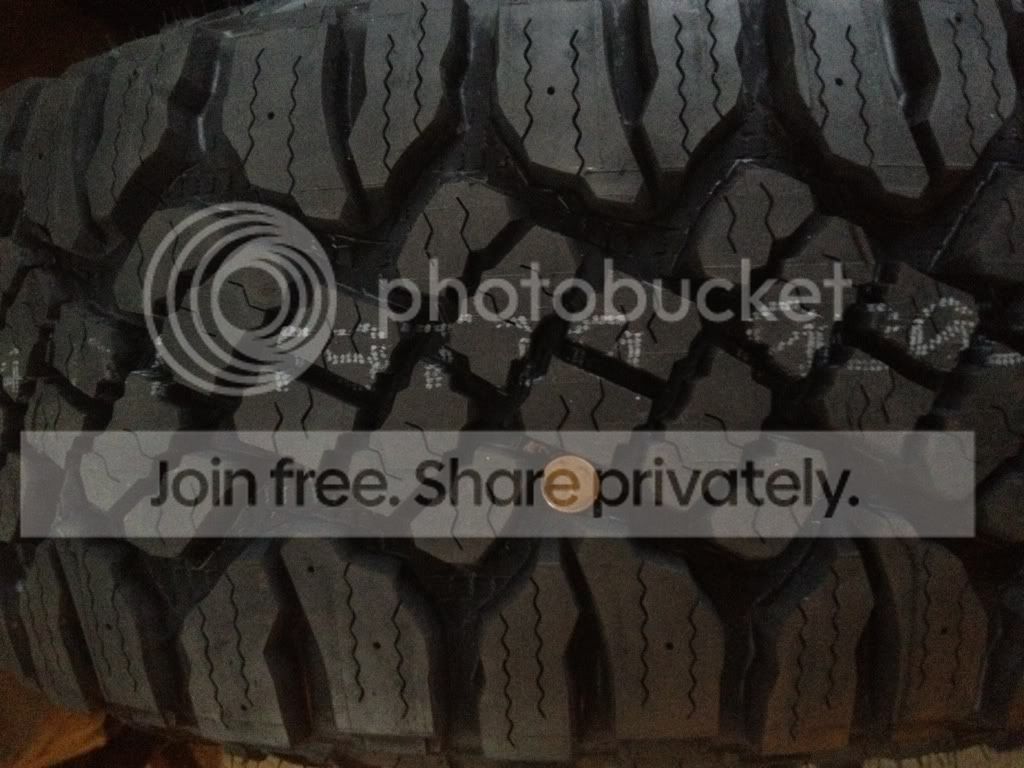

Right off the bat I put in a new radiator and started fixing all the leaks. Git leak free pretty quickly. The tires aside from being too small were badly worn and dried and cracking. I went with 33x12.5 Goodyear Wrangler Duratraks mounted on some 15x10 Procomp black steel wheels.

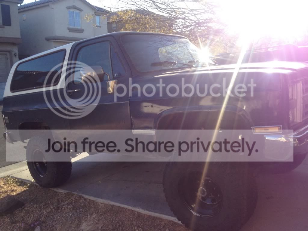

I figured they would fit on the truck alright for a little bit before I ordered my lift so I went ahead and bolted them up in the garage, it looked great but when I went to back out and turn out of the driveway the tire got stuck so bad in the fender that I had to jack up the truck a bit so that I could turn the wheels straight without tearing the tire. Pulled it straight back into the garage, put on my old tires and ordered the lift kit. I just got the Rough Country 4" with blocks in the rear as I was and am on a bit of a budget.

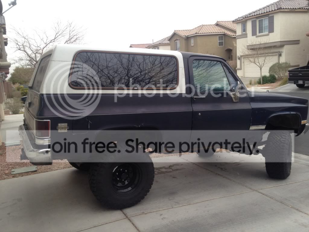

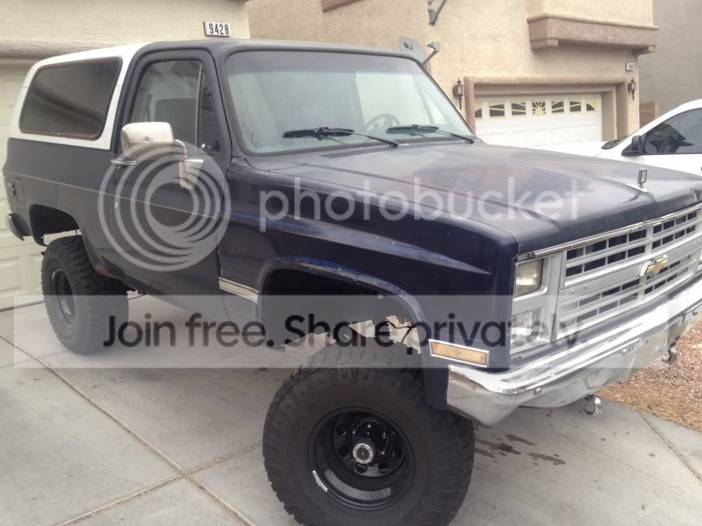

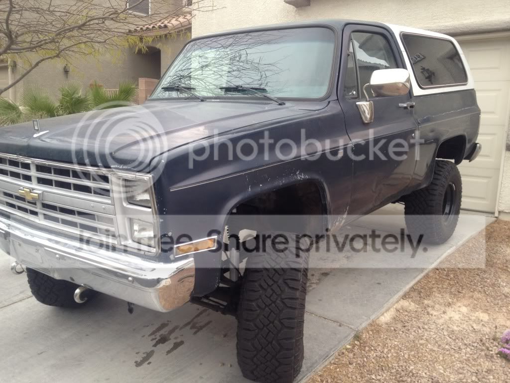

Lift kit went on with no issues aside from the broken rear driver side shock mount. I had been driving around with the shock flopping around and didn't even notice. Here are a couple pics post lift.

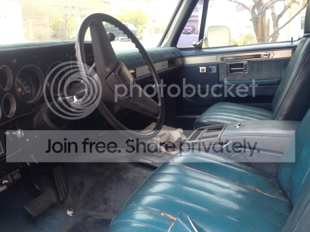

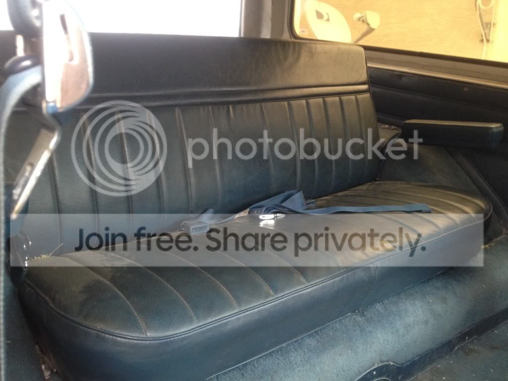

In the middle of tying up loose ends with completing the motor I am also redoing my interior. I have all the seats except for the driver ripped out, as well as all the carpet and padding. I am going to be bedlining the floor, inner fender wells, the new side panels I making, the tailgate and probably the inside of the shell. I am going to probably go with liner xtreeme http://www.sprayonbedliners.info/home.html in the desert tan. I am also mounting a bench seat from a newer Silverado with integrated seat belts into the front and a 3rd row bench seat out of a newer Suburban with integrated seat belts for the kids. I will be beefing up the floors accordingly.
The old interior:
