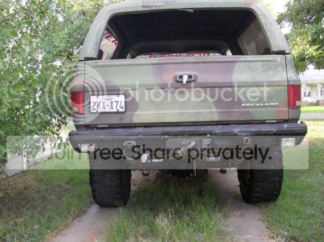

Safe and sound in the driveway in Angelo...replaced a rubber fuel line, a little gas and new battery and drove it off the trailer...shoulda thought of that before! 31's on the front and my newly acquired H2 rims with 37" Mud Grapplers...picked up some 37" boggers last weekend that will be going on after I paint the H2's black

I've gotten quite a bit done on it the past couple weeks...heres some crappy cell phone pics:
Rims and Boggers painted up ready to go...H2 rims on my '85 K5...I'm formal, but I like to party too.

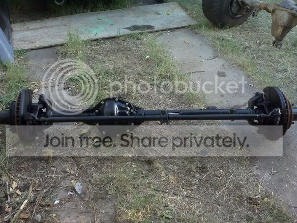

Front 44 w/4.56 gears/spool cleaned up ready to go in:
d44 in, tires mounted...still need to install new brakelines, and swap rear axle for the one with the detroit in it.
