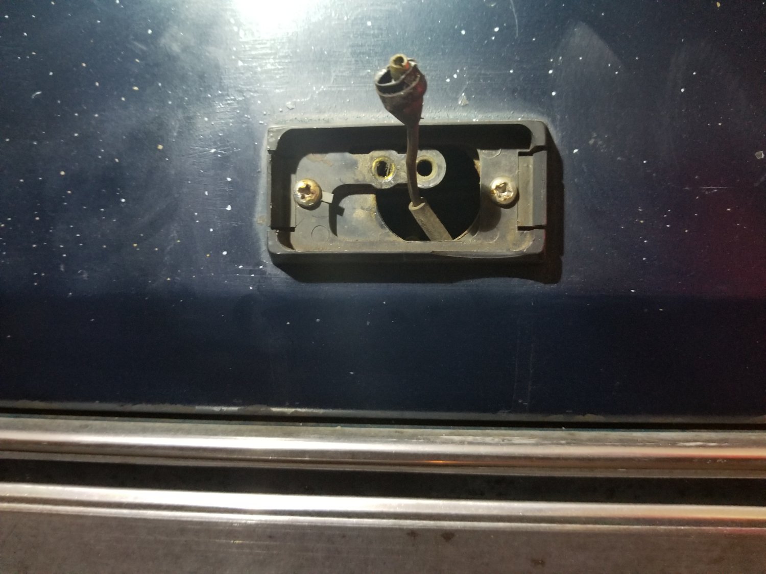

Hey so im in search of another tailgate light, its an odd one to me, has a ground in those 2 holes, so the one i found on ebay doesnt work... any one got one or a set?
I ended up using a set of 5 like you have pictured. These are the common style/size that are sold at Napa, advance etc. I believe the hole centers are around 2 inch and they also come in led.
The factory original I found only one of on ebay at one point had hole centers of 2.5".this is what my original gate was drilled for. After not finding anything I used the smaller lights and redrilled them.
Trucklite 15 series and 15200R should be number for red incandescent. LED will stand out in a row of OEM with dull lenses.
