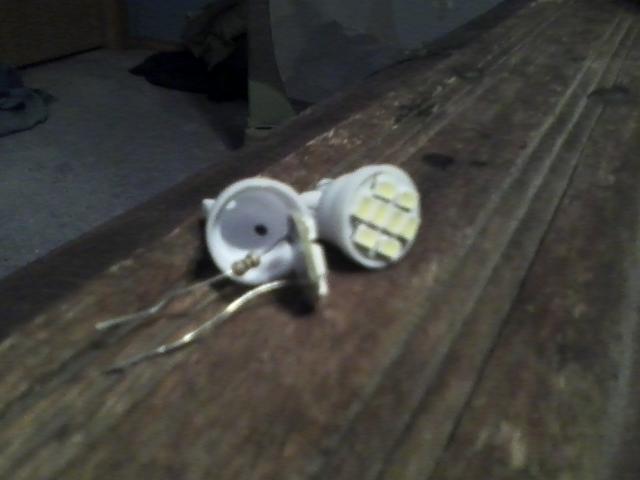

those positions require bulbs that are not polarity specific, unlike 99.9% of LED's.
Are any of these the kind of thing you could open up and solder a full-wave rectifier in there?
Here's what one style of the LED 194 looks like. Pretty small to be doing a lot of soldering on, and not much space, but I was able to get wires soldered to the leads, so its possible, depending what size the rectifier is.
full
The aftermarket is able to fit the necessary components inside that form factor, but the cost is so high, either demand is very low, components are really expensive, manufacture is tough, or its a combo of any of those.
It must be low demand. Probably most cars don't need bidirectional lights. Diodes are pretty cheap. A full bridge rectifier is really just 4 diodes.
