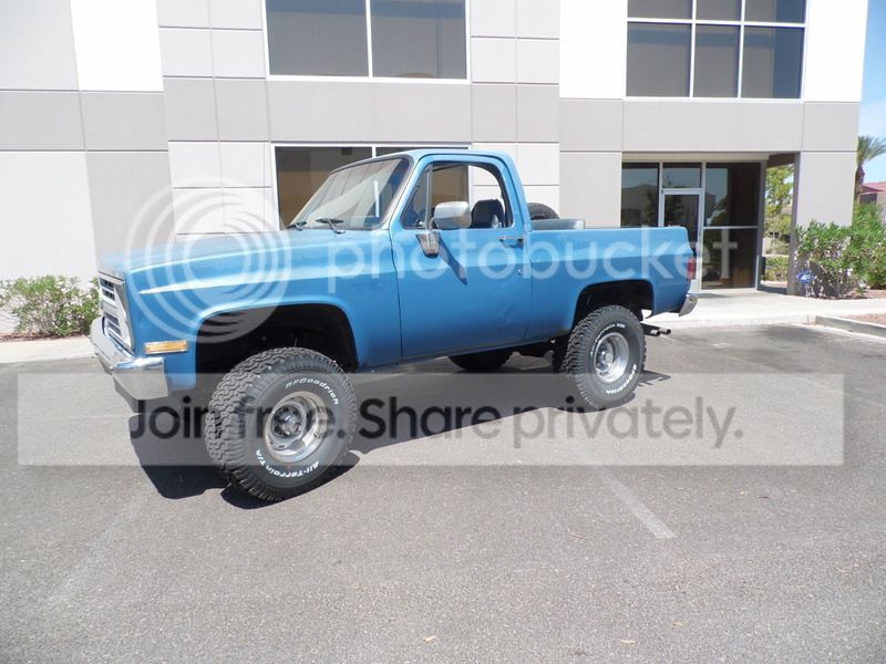

Sure do appreciate all of your responses. Since you are in the voting mood, have narrowed the new tire choices down to two on 15 x 8 stock rally wheels:
1. BFG KO2 33 x 12.5 x 15
or
2. BFG 32 x 11.5 x 15
80% highway use 20% off road
if you ever have a tire problem the 33x12.50 will be so much faster to find a replacement for . much more common size.
I want to make sure I don't end up with too much blurb with the 33x12.5x15 on the 15x8 rally wheels which is why i'm considering the smaller size. My tire dealer has agreed to mount each and let me take a look, just wondering what ya'll think
the 33X12.50 will look just fine. This is 35X12.50 on stock wheels.
