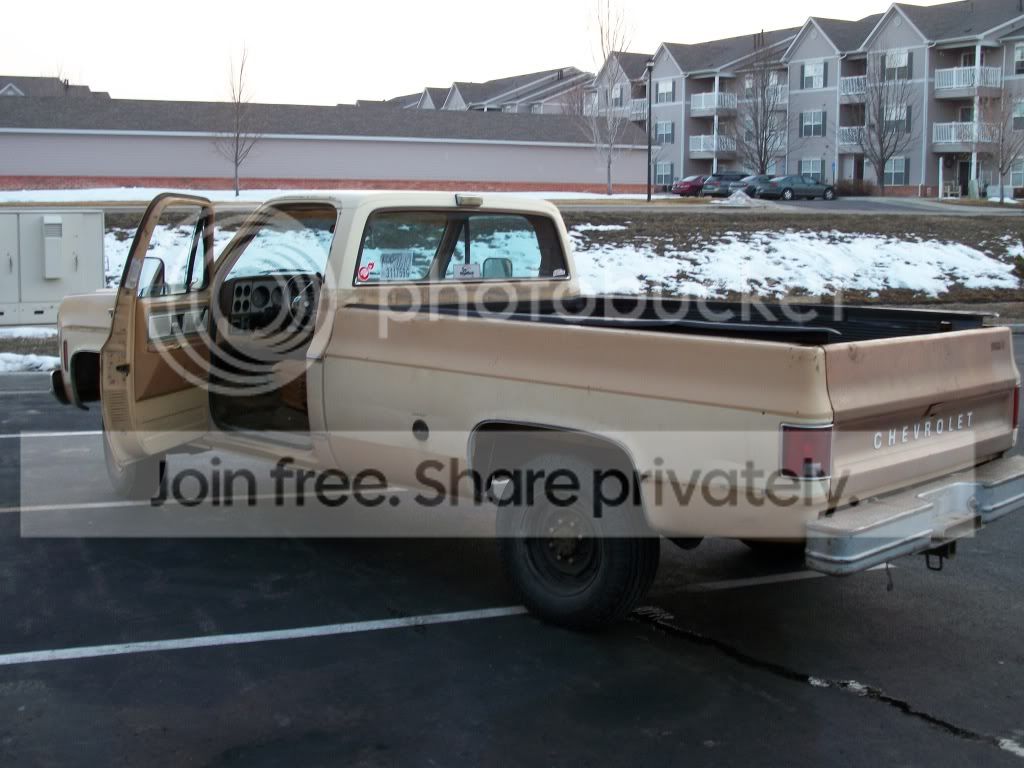

$600 78' c20 4x2 3/4 ton donor truck w/454/TH400 (for sale once pulled!)

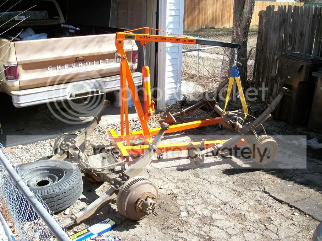

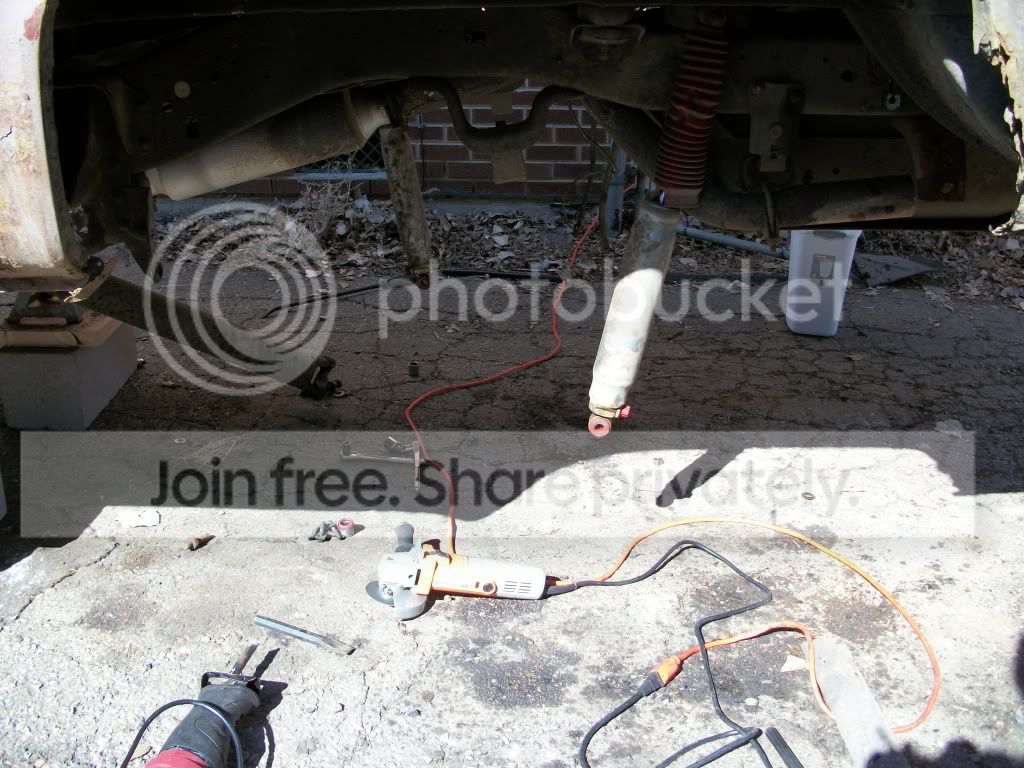

Rear axle out end of night one. Didn't really get started until 4pm in the afternoon. Not bad time with sh** tools and workspace...it's about 830pm here.
And the next day!
14 vs. 10 bolt? I think we have a winner.....

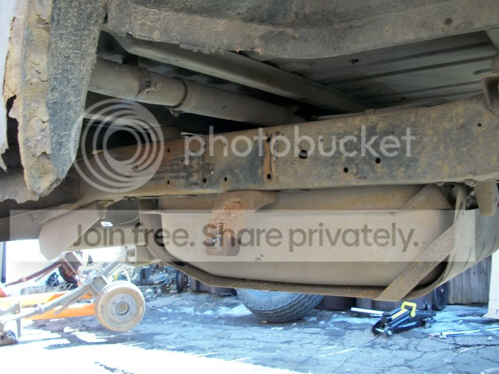

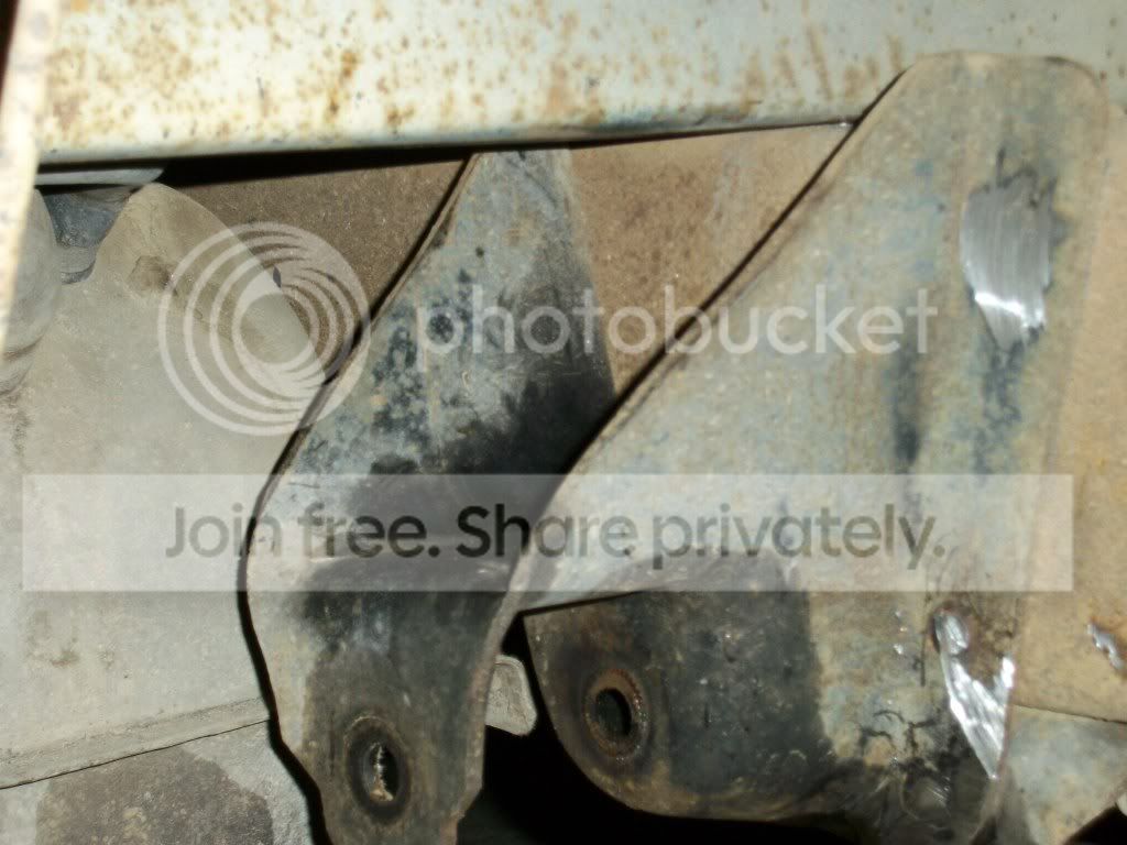

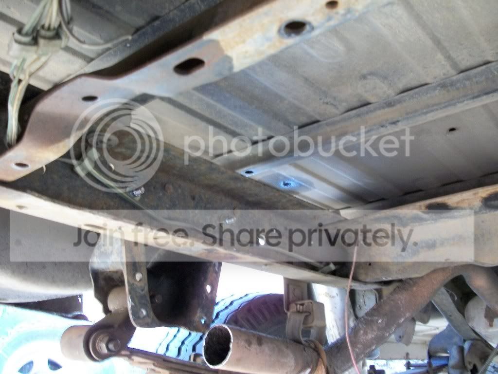

This is one of the front mounts on the C20 that will be used in the rear position on the burb. I was able to get at the rivets near the gas tank by grinding off the very bottom one, sawzall on the 2nd one up, and drill/cold chisel on the backside of the top one. Thanks to the posts here on how to remove rivets I didn't really have too much trouble.
I'm curious how much lift I can achieve in the rear with this bracket and the stock shackle. I'm hoping I can get over 4" but I have to see how much bracket comes in contact with the frame to achieve it. I can always box it in and reinforce the backside I suppose.

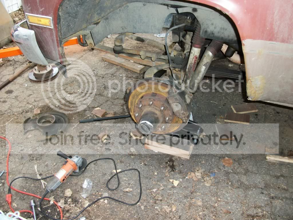

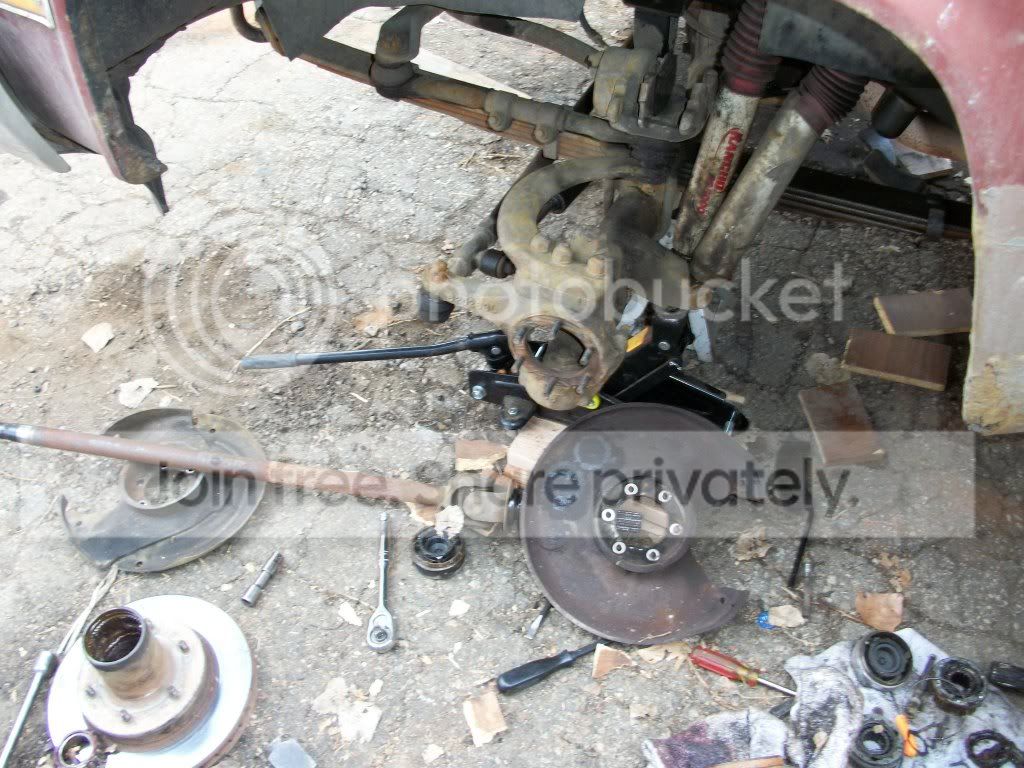

Thats it for day .5 and day 2......hope to finish the rear suspension mockup and bolt in tomorrow. Brake bleed and a few other loose ends and the burb should be driveable again. Friday I'll switch over the front to 8 lug with new bearings/seals/etc and the premium warn hubs I got for $15 at the yard. And then the caliper grind......:doah:

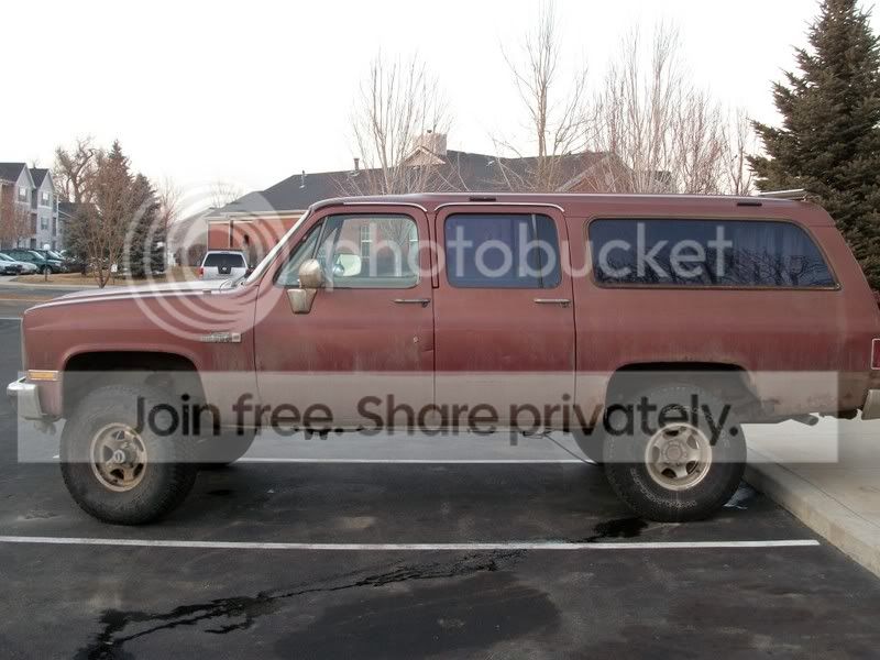

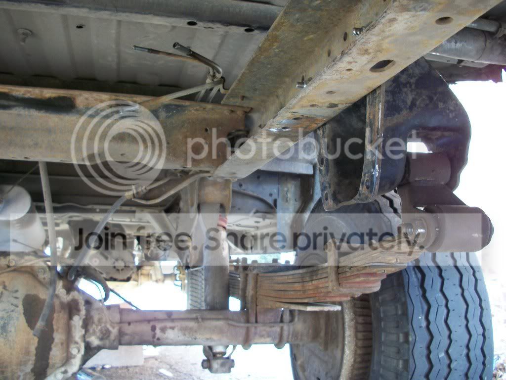

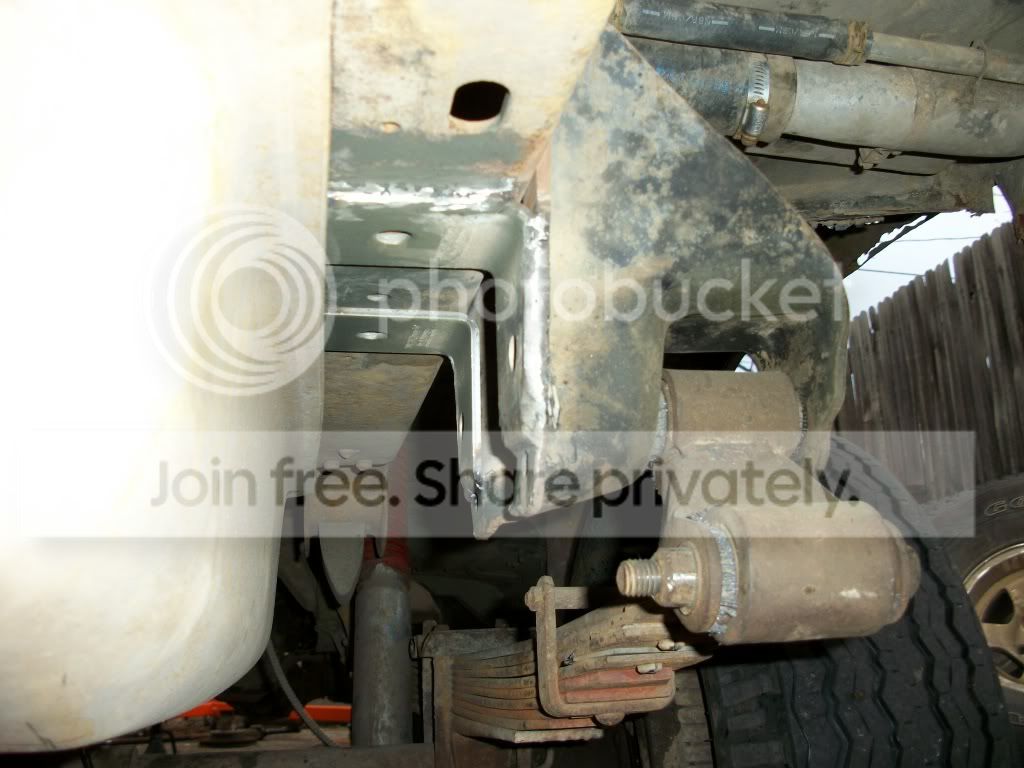

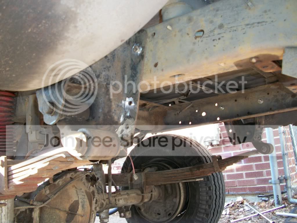

More pictures....I'm happy with the shackle angle. Of course the tank had to come out. tomorrow I'm going to bolt in some braces behind the rear shackle mount and maybe get the front started.
Yeah the bolts are holding it in for mock up purposes only. I wanted to put the weight on the springs so I could see what my pinion angle and net lift looked like. Seems like it will be pretty close to what I wanted. Next step is to weld in the reinforcements.

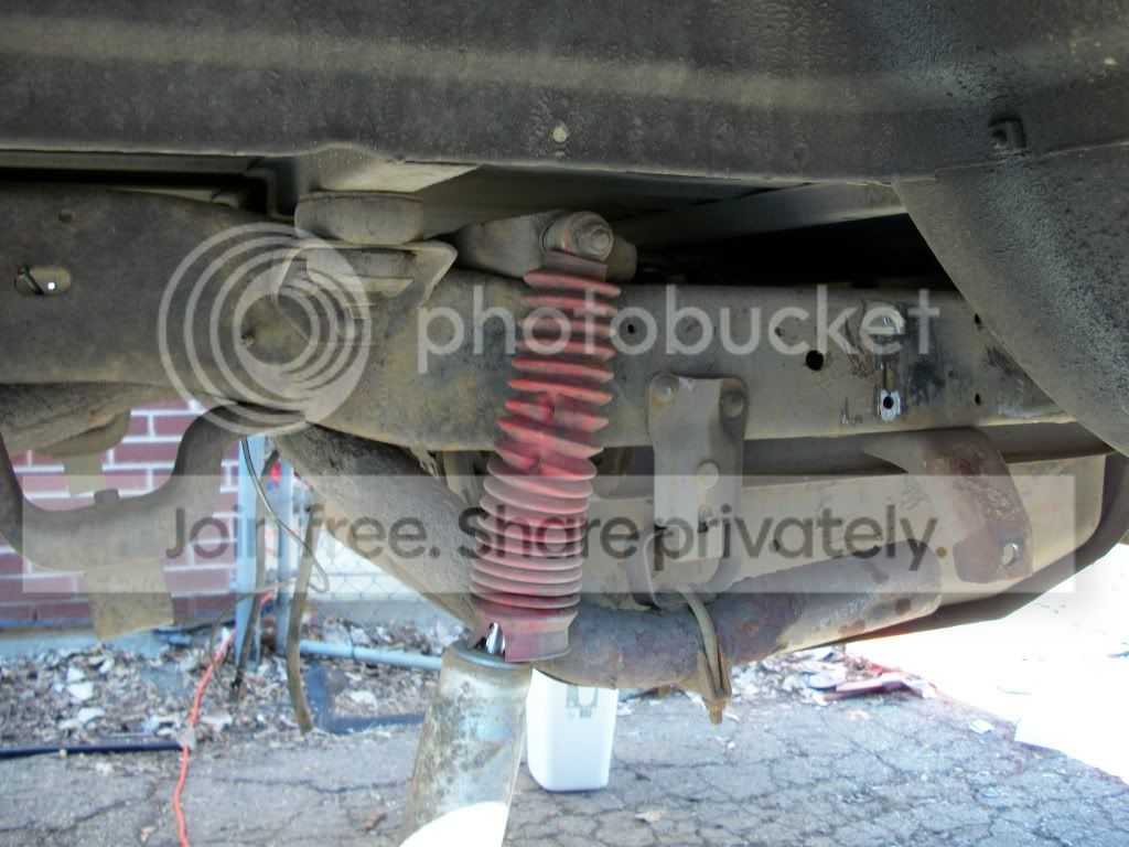

One thing I did notice: The rancho 9000 shock I have will not fit on the drivers side. The gas charged tube portion hits the axle. I think this is due to my pinion being rotated slightly and moving the mount under the axle too far. shim time!
Flip the shock over. Run the body high. You can flip 9000's over and they still work correctly.
Sweet, thanks for the tip. I have it that way for the mock up and I was wondering if that was cool or not. I know they are positive pressure shocks so I didn't think it would be a big deal. Thanks!

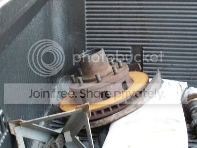

8 lug / warn premium hub conversion on the front

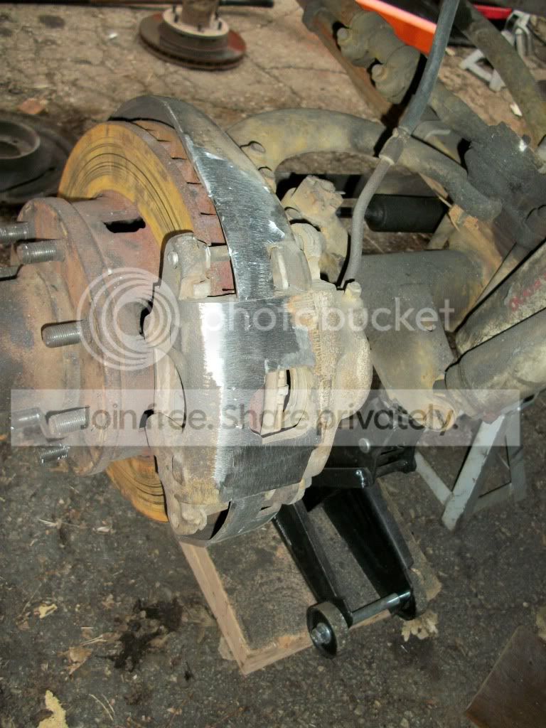

Caliper grind

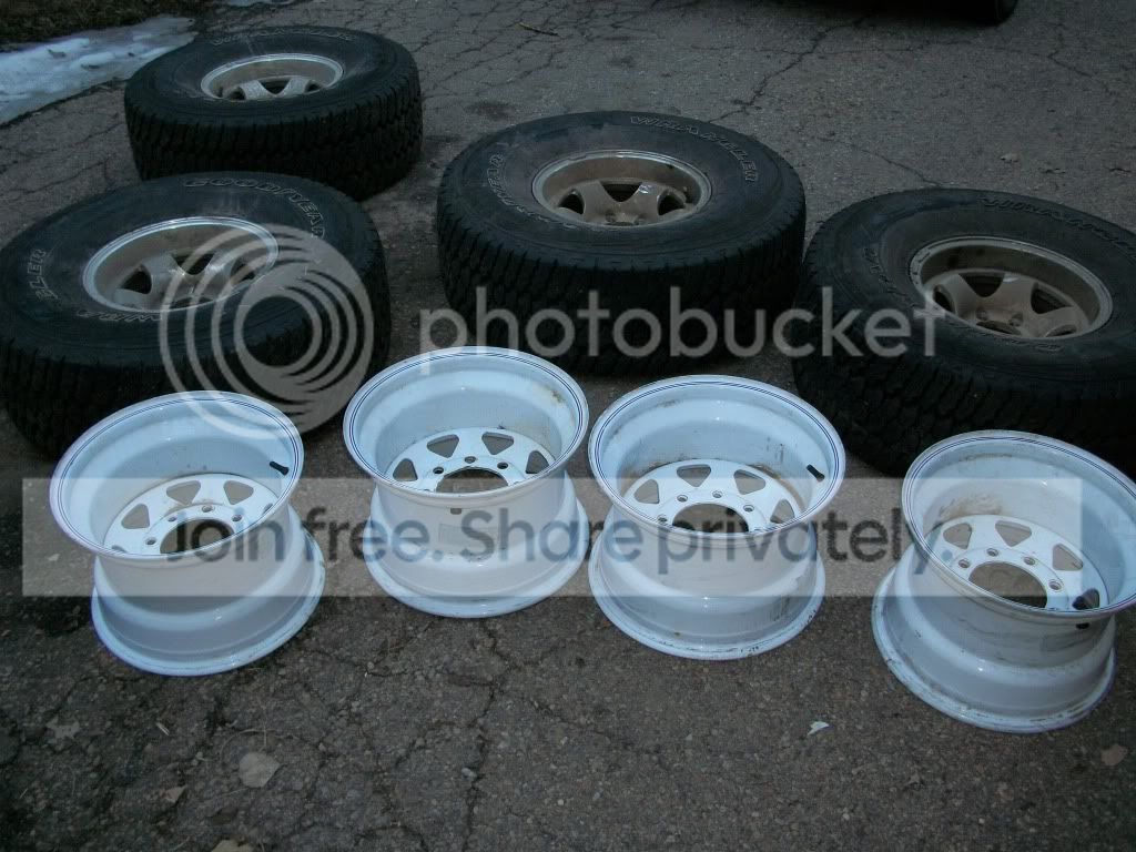

Move wranglers over to $40 craigslist 8 lug 15x10 rims....

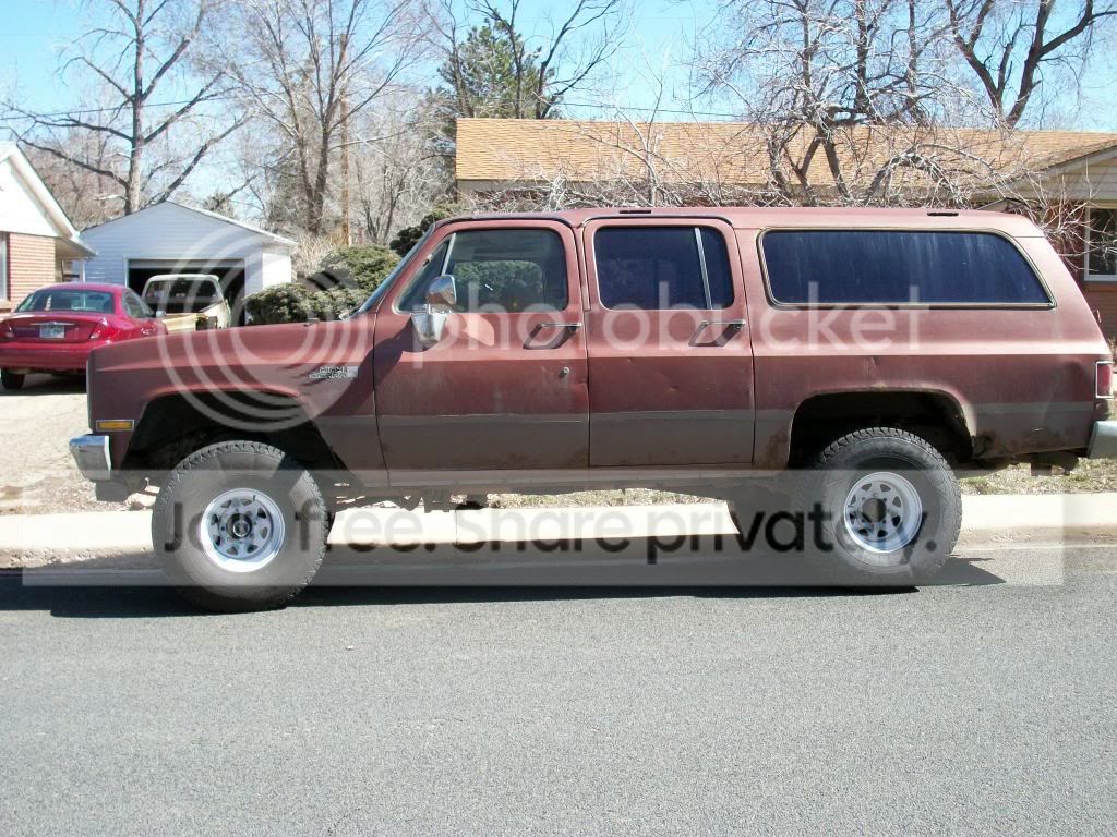

finished product for now,
Simpson string tie H33 welded in for the flip bracing. yeah....my welding sucks!
SCORE! $40 set of 8 lug steelies from craigslist. Guy used them for 2 wks

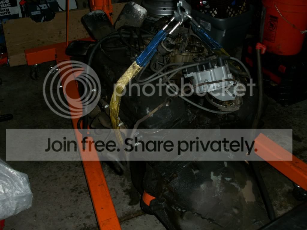

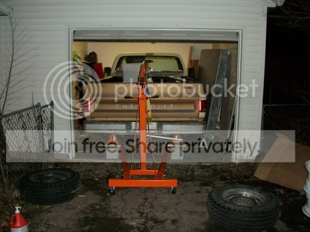

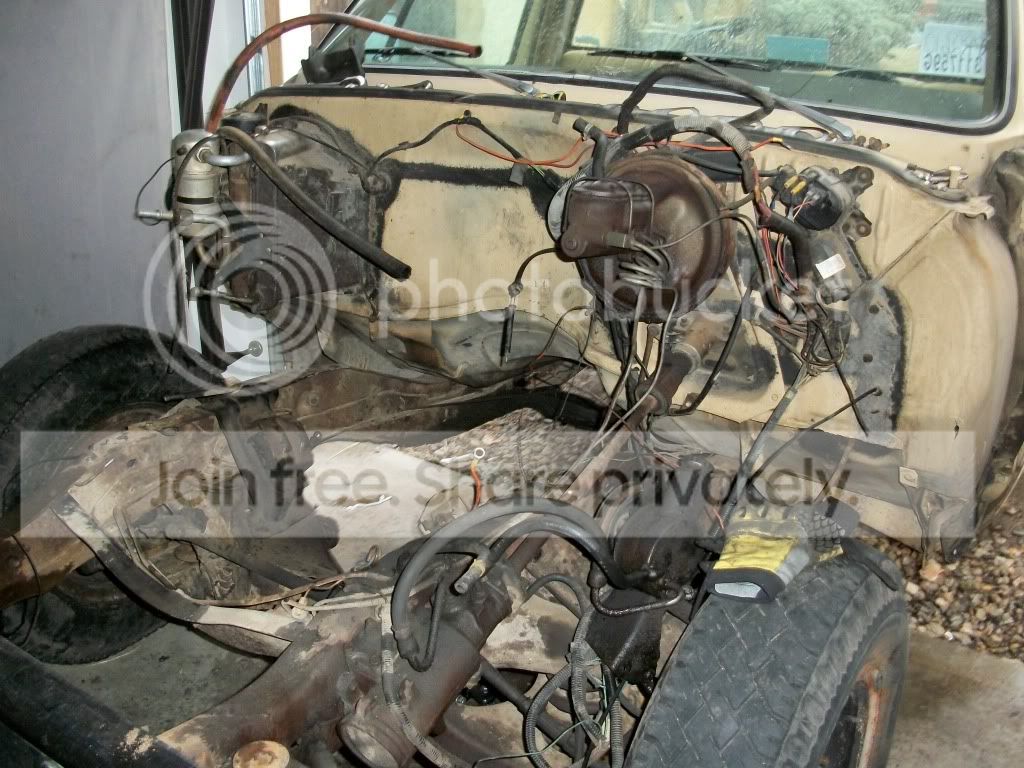

454!
The donor truck looks a little different now.....
Back to work!
Those simpson string ties wont give any more support unless you gusset them. :wink1:. Lookin good so far tho.
