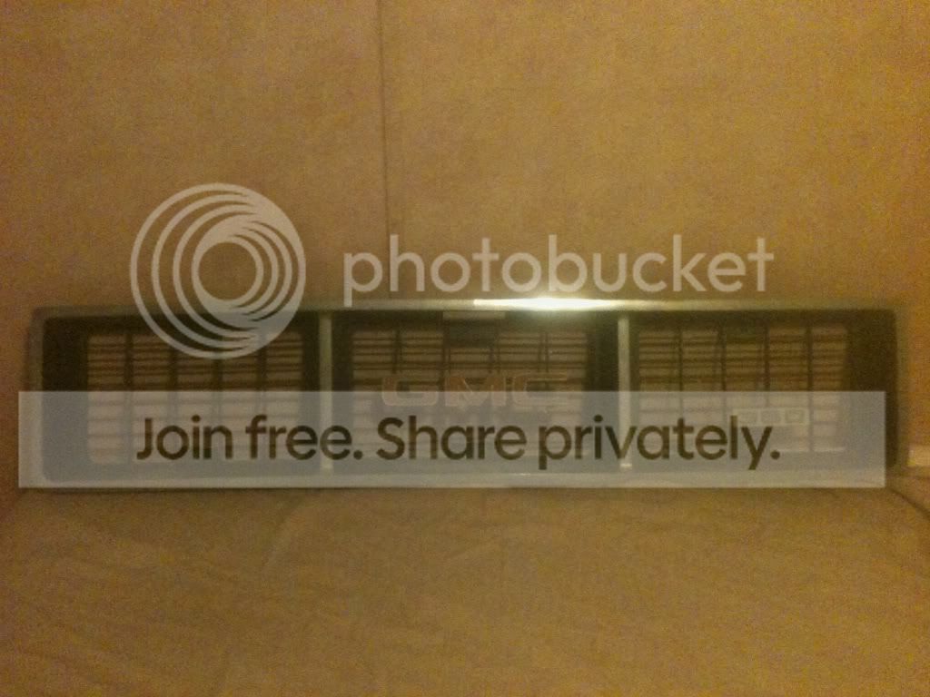

I got a 74 GMC grill from Airemdwn today and I'm thinking very hard about swapping to the old style frontend on my mud truck so I can put the grill to good use.
Here is the grill I've got
You will need the core support, headlights, the grill obviously, headlight bezels, and associated wiring for running lights and headlights, but im fairly certain you will have to use the front fenders as well, maybe not but its a possibility
Yeah, you have to swap fenders as well, and there are some firewall modifications for the hinges along with the windshield wipers. That grille would look good on the wall in your garage.
