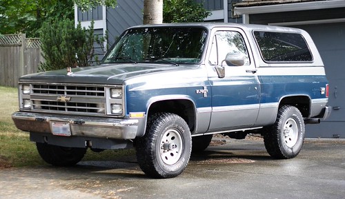

New Blazer owner here. Been lurking for the past couple weeks.
The transfer case is leaking, and I'm wondering how difficult it is to pull it and put new gaskets on it? Any recommendations for a place to get the gasket kit? I tried ATP AT-205 Gasket Re-Seal which is supposed to recondition old gaskets. It helped, but didn't stop the leak.
The seats don't seem to lock back very well. The driver's seat does lock a little bit, but the passenger's seat doesn't at all. Any ideas on how to fix that?
Here's a picture of it:
The passenger seat if it islike an 1989 has a little black plastic part on the out side edge inder the gurd on side. when the seat is flopped down it pushes the thing down and lets the seat slide forwerd. Look and see if it is stuck down. I ont know about drivers seat mines all welded the PO broked it. He was a lard ass.
