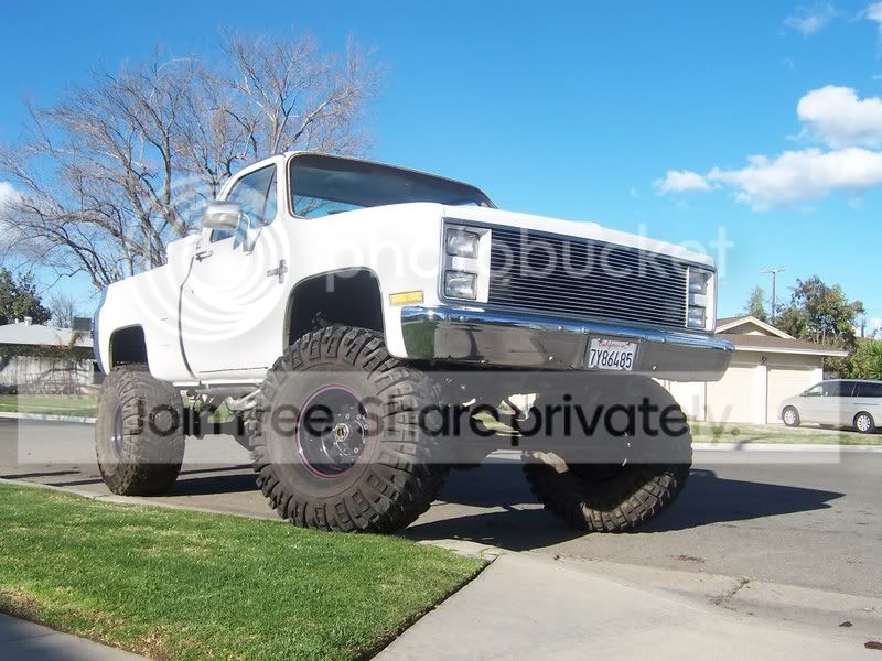

I started this buildup in the fall with an 87 K30. Its got a 454 with TBI, TH400, NP205, D60 front and 14b rear. Truck was incredibly clean when i bought it and i have bene making modifications to it since while keeping it as clean as possible.
That is the truck how i bought it.
First thing i did was pick up a set of steel wheels and some 37" SSRs.
Next the rear blocks came out and were replaced with ORDs 4" shackle flip. A couple of the leaf springs were taken out too, made for a much softer ride and also leveled the truck out a little.
Also did a Ubolt reverse kit and the greasable bushings.
After a couple weeks running around i upgraded to 35 spline outers in the front, added a Powertrax and new greasable ujoints and some tera locking hubs.
On my next trip with the truck, the exhaust came out of one of the manifolds and i decided to go ahead and replace it. Got some hedman headers and a box of stainless 3" and a magnaflow dual 3" inlet, single 4" outlet muffler.
You can also see the detroit about to go in the 14 bolt.
Can see where the transfer case support was in the way coming out of the header, had to make about 6 or 7 bends in abaout 8 inches of 3" pipe to get around it.
Everything got tucked up high and there is little chance of it getting ripped out.
While doing the exhaust also pulled off all the california emissions controls that were on the truck. With the headers, better flowing exhaust and minus the emissions controls, truck got a pretty noticable power boost. Muffler works great, can barely hear it idle from inside the cab at a light, but on the throttle it sounds great.
Had to pull the PTO winch off because of interference with the headers. Also took off the front bumper and trimmed the front a little to clear the tires a little better. Replaced the trim and is hardly noticable.
Also installed the ORD steering box brace.
I have a 12000lb milemarker hydraulic winch to replace the PTO one with and am looking into a PTO driven hydraulic pump to run it instead of using the steering pump.
Detroit is installed in the rear.
After i got both lockers installed i was heading to a trail and lost 3rd gear in the transmission. Got back home and after a little research and ordering some parts pulled the transmission and rebuilt it. Made a few upgrades like a transgo shift kit and was going to install a 34 element sprag but someone had beaten me to it in the transmission, so i left it. Truck shifts great now cause of the transgo kit. Can hardly feel it cruising and under throttle the shifts are firm. New clutches and seals and everything, transmission should last a while now. In the mail right now are some ORD crossover steering parts and im also looking around for tube so i can start on some sliders and bumpers.
This is about where the truck is right now.
