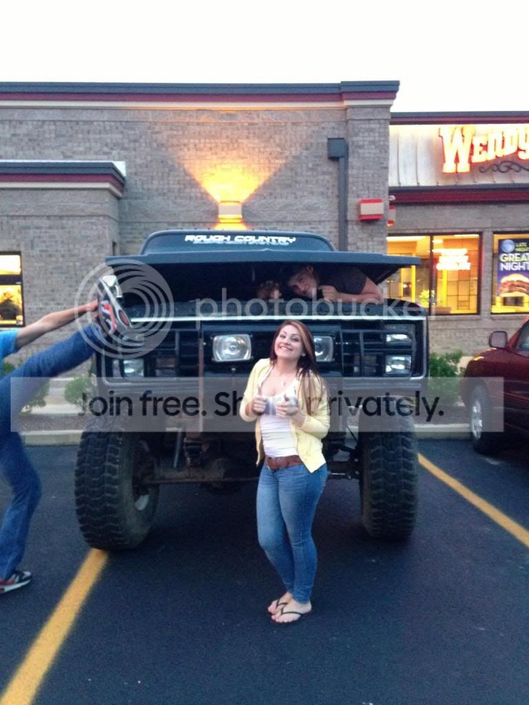

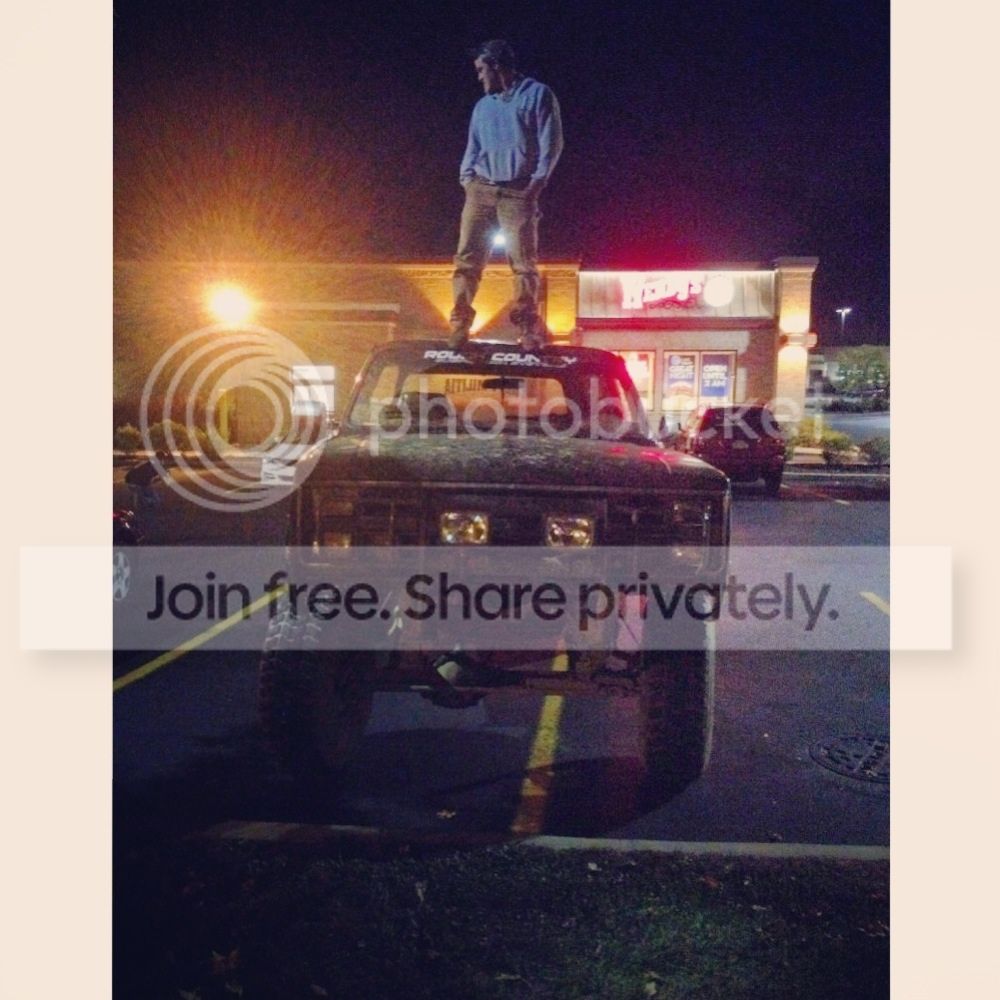

I love the look of the truck, and I'm not verry fond of the trimmed look on the blazers. I've asked on other forums and all I get is rude comments on how stupid I am and that I should just Trim. What are some company's that will make costom leafsprings? And yes ORD does sell the 8" with the shackle flip but all together it's verry pricey and is only a 12. This is the way the truck sits as of now with the 37's and the 9" of combined lift.

Can't see the images you embedded??
That's a hell of a lot of lift. How are your fabrication skills?

Pics posted and they are decent I have a full shop at my house with all most every tool you could want and 2 car lifts

You do realize with a 15 inch lift and 44 inch boggers you will not be able to go into Drive-thru's right? Your best off going with rock wells for that size tire. This is what a mud hole and 39.5 Boggers does to a 60 stub shaft. I have a tired 350.
