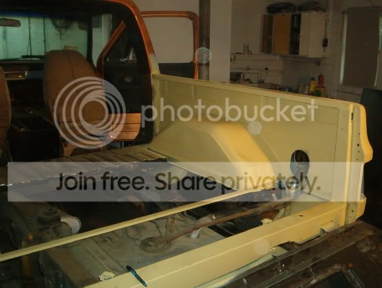

It's all pretty straight forward... I undo all the bolts (varies depending on year), air hammer with a ripper bit and cut it all the way vertically a couple inches behind the b-pillar and in front of the back post. this allows 95% of the qrter to just fall off.. use the ripper bit and a chisel bit to final trim the front.. the back post is bolted to the tailpan, as well as fillet welded where the post meets the tailpan.. cut off wheel works well for that... mine where so rusted back there, I pretty much just ripped the post off...
the aftermarket qrters fit pretty good, nothing out of the ordinary. execpt the tailpan bolt holes didn't line up.. i suspect the tailpan was punched incorrectly.. no biggie, just drilled new ones...
grind all weld, air hammer boogers off, surrounding area, weldthru primer..
I also douche the posts everywhere except the area I'm welding to, with black paint...
prep qrter, drill leading edge for plugwelds, grind that area and lower rear post... scuff pad and paint all difficult interior parts.. fit qrter, tucking in top forward first...
body clamps are esential for this kinda stuff.. like these...

I'm using 1" x 1" x 1/8" angle iron to frame out the floor.. There are also 2 forward running pieces that run along the inside of the wheelwells... The floor will be plug-welded to the top of the angle iron, then seam sealed around the perimeter... With the frame welded togehter, the floor welded to that, and the angle iron bolted to the qrters and wells, I maintain my ability to replace wheelwells and qrters easily....

Yeah, the 1" x 1" is working well.. Should work well with all the joints seam-sealed...
The front section of the cargo area will be done with the same construction... gonna move that leading edge of the cargo area forward 8"s, angle iron for that 90, than down to the floor, another 90, then up to the peddles...
Doing the sliders and all cab supports with 2" x 4".. funny, those cab support areas measure exactly 2"... Should trim a couple inches off the rockers and make it all pretty tough.. Not a boatside, but for a Joysey DDer should work well...
Gonna frame out and build a new removable tranny tunnel too... It's gonna come off the cargo area level... Gonna go for a stealthy f-117 look to it...
All sheetmetal is going the copper.. Gonna black Imron all interior/ floor/underside stuff.. Then when the whole floor is done, Herc everything up to the undersides of the bedrails...
Hopefully with the black softtop, black tube bumpers, black expanded steel grill, the sliders, and all black tires, it'll break up the copper well...
