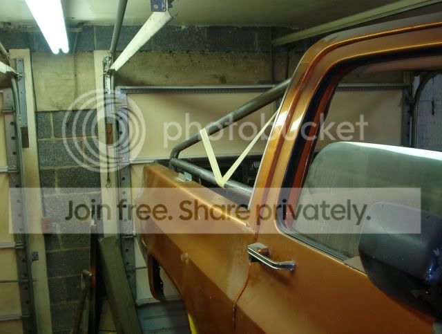

87 K5 Build...Hmmm, whats that Ryoken up to? stay tuned...
apparently I lied.. there are a couple shots on the comp from the other day... further along now...

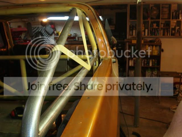

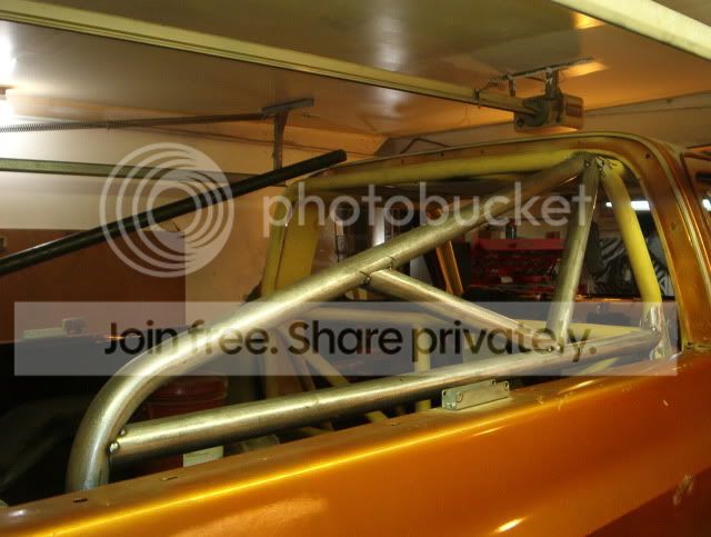

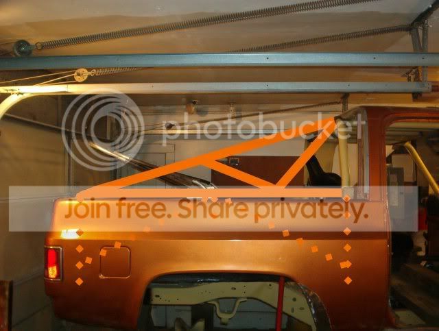

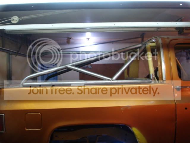

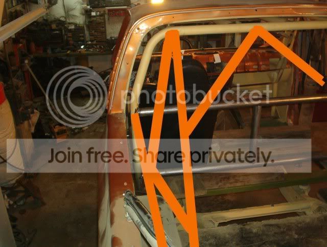

here's the other shots from that day... these show the angle better.... I've got both upper sides pretty much done now, still have the 3 lower bars and the flanges on both sides to do, final welding, etc...
here's the drawings for comparison sake......

haha, I was going for something like these kinda lines

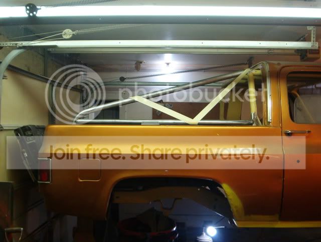

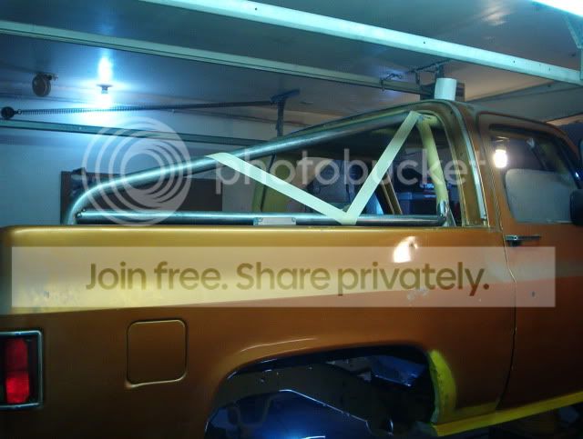

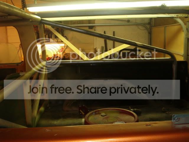

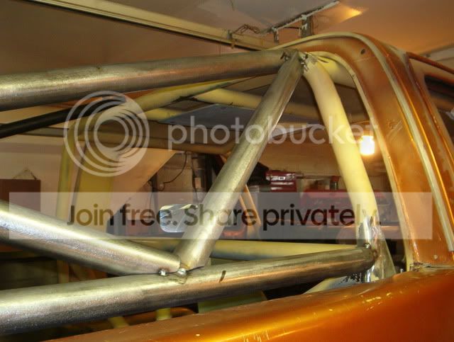

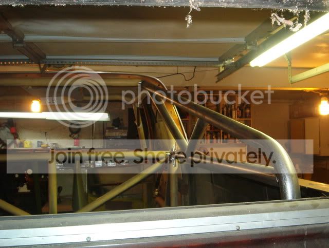

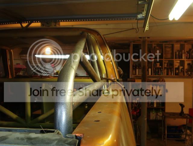

here's some shots with the passenger sidebars tacked in...
still need to work on the ds pieces a bit, should have them tacked in tomorrow..
I'm very pleased with how it's coming out..... :D
REALLY sweet Paul....I'm liking it.
what are you using to figure, and cut the fishmouth joints?
I've seen a joint jigger, is that what your using.
thanks.... :D eh, the old mark long, chop, sharpie, grind, fit, grind, fit, sharpie, carbide burr, fit, grind, rinse, repeat method... :doah::crazy::haha:
that front sidebar was probably the hardest fishmouth i've done... what a PITA.... came out good, it's just time consuming...

I'm really not sure if I've seen anything similar design-wise to what I just did... I do know how I came up with the idea, but I'm not sure if I've ever seen something like it.. Usually the angled ones go to the floor, not the bedside height...
either way, I think it's a pretty original cage....
