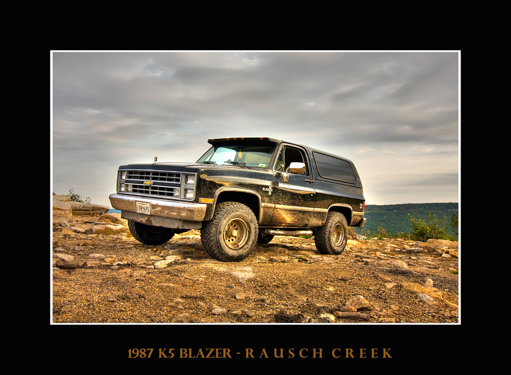

Good Evening Guys,
Just a quick background of my truck before my problem...
I have a 87 K5 Blazer with a 305 in it. Truck has about 157,000 miles. I recently changed the intake manifold gasket making sure we were careful not to get anything in the holes in the V when cleaning up. I had yet to change the oil.
I recently took a drive to Rausch Creek in Pennsylvania which is about 140 miles from my house. I ran through the trails all day and had no problems. When we were on our way home I noticed my truck was slowly loosing power. I would say the truck lost power over the course of about a half a mile. The truck finally lost all power and shut off before coming to a complete stop.
I tried to restart the truck but all I heard was a crank...Engine did not turn over.
Oil Pressure was fine...Did not overheat...The truck had oil...
I ended up having the truck towed back to my house.
