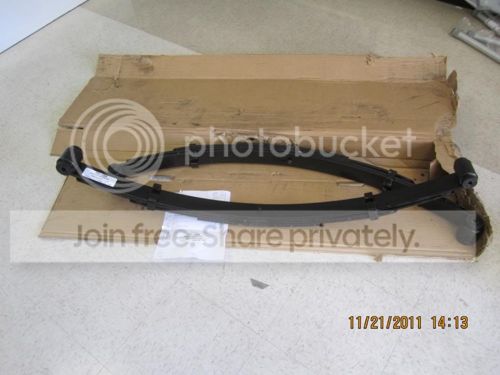

The front springs came in today.

Plans are changing. Im going with this setup. I am picking up the front 56s and 7" DIY4x shackles this weekend from a guy on Pirate. He lives in Fresno. Which is an hr and a half each way. He also has some 64" rear springs for sale also. Here is his truck on 56s/64s with 39" tires.
