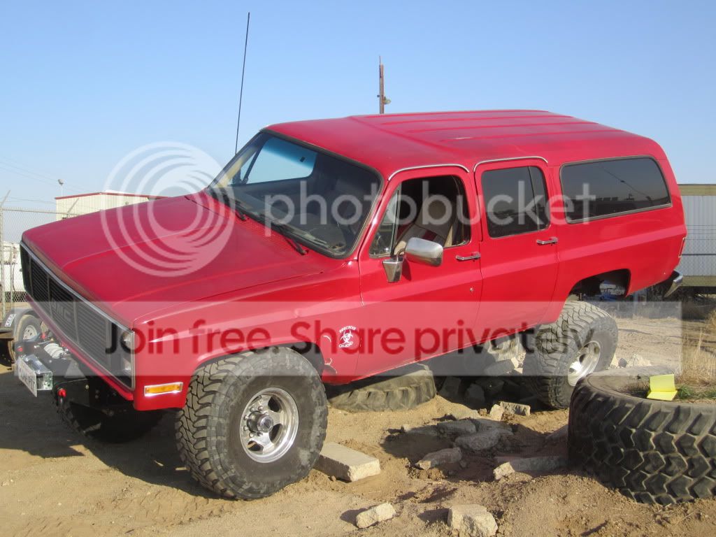

I'm kinda new to the proper spring flex and arch thing. But is this major bend at the tip of the main leaf OK?:dunno: Looks weird to me
Edit: you may have to go back to the original image to see it closer
Don't scare me like that. Just kidding. I had to run outside and check the spring. The top leaf at the eye bends down as it wraps and makes the eye. The second spring is almost the same length as the top one. It's straight all the way from eye to eye. That's another reason to limit the travel at 11". Thanks for having a sharp eye!!!!!!

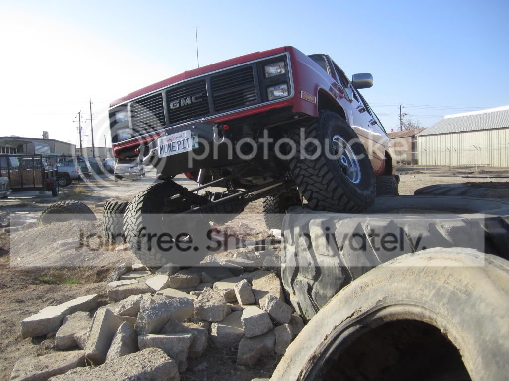

Here is a pic while taking measurements for limit straps, shocks and driveline.
Holly sheet that's rad. Sweet picture. Glad your making progress, I'm stuck for now.
Your front end is pretty much exactly how I did mine
Thanks guys. I sure wish id moved the axle forward a long time ago. It wont touch anymore with 38s. But im going bigger, not too much but some. When the shackle flip is done, the rear will flex better also.
Thanks again for the compiments!

That has to be the coolest burb in CA.
Does your tire look like it will rub the inner front of the wheel well? Mine rubs on compression.
Well crap. Mine are shaped like a W. Mine are shot! I am going outside to measure. Thanks
Wow, that's a he'll of a complament! Thanks man!
No rubbing at all. My fenders would have been smashed for sure before the 52 swap. Although, I need to adjust my fenders. I had to get out the back doors on the tire. That was fun! My front doors would open at all.
