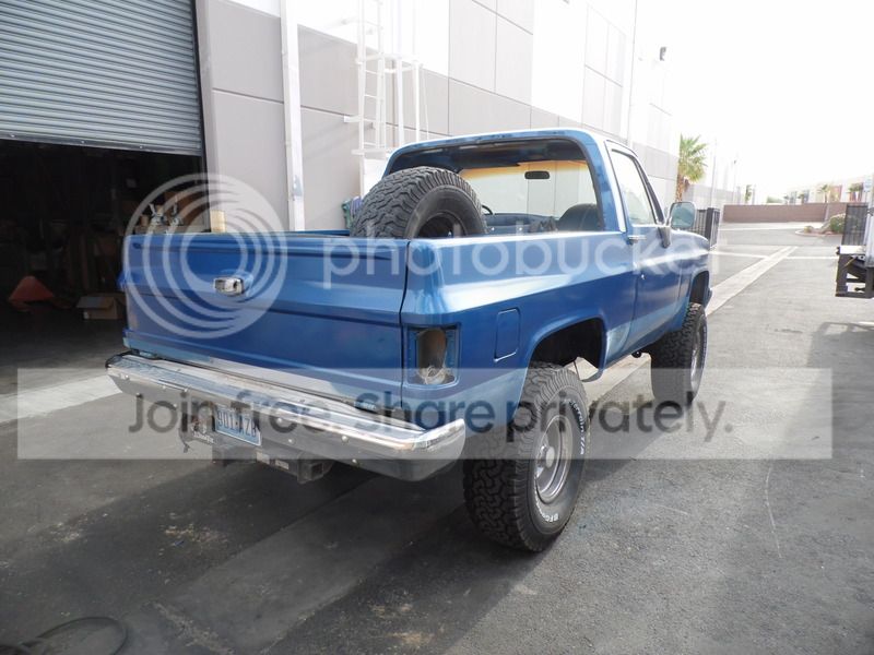

To answer your question, the rear bumper will fit. You can use the outer K5/suburban brackets but you will have to buy truck inner brackets, LMC truck has them. The rear hitch I am not sure. Here is mine with the blazer style bumper with truck brackets.

Frame ends totally different on the K5's and trucks. Hitch will not work because the rear bolt pads of the K5 frame/mount is angled downward (there are four bolt pads on the hitch), the truck frame/mounts are both flat.

These bumpers really don't hang any higher or lower than the OEM step bumper, with that said Curt, Valley and Drawtite all still make hitches for the 73-87 trucks, the receiver tube will be just below the license plate box
