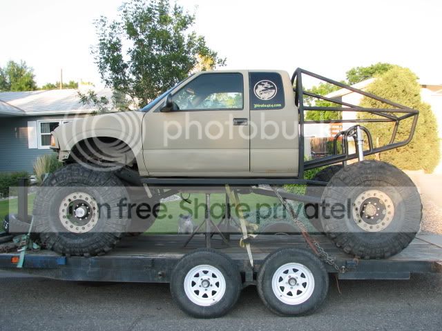

Looking for a fullsize later model body, thought about putting an s-10 body on it but the extended cab on them doesn't have any room for anyone to ride in. They did make those s-10 crew cabs for a while but they look kinda gay though. Want to keep the truggy theme so no blazer for me.
ive seen it done before, they welded mounts to the ouside of frame rails, seems to work good and the frames are wider on the newer trucks. they guy who did that around here said the only part was making the mounts fo the cab it self, he used a one inch body lift... i did the bed change to the stepside, i thought about changing the cab but im not motivated enuff....
Really its not much different than my s10 build. Make body mounts and hook up body controls. Pretty basic.
