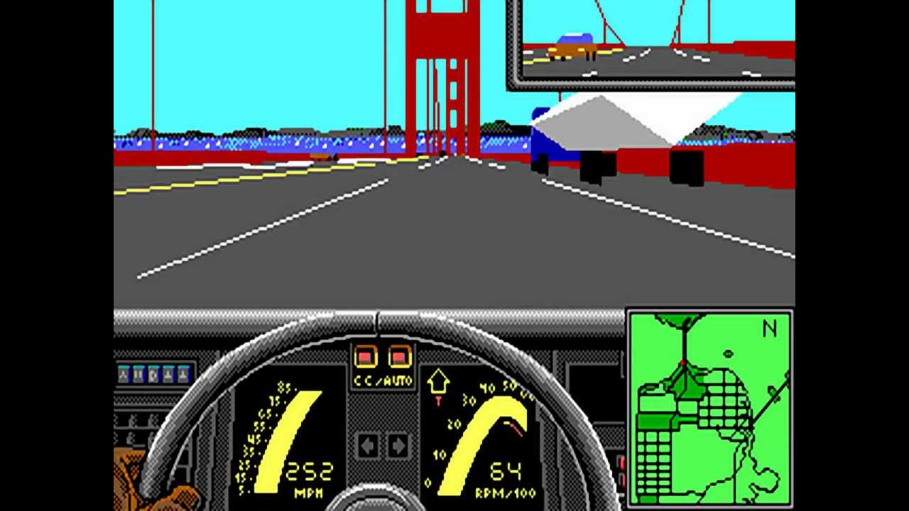

Being a kid in the 80's I lusted for that generation of Corvette. I had posters, built multiple models, and even have a handful of GM promo-models from the dealer. The instrument cluster is wacky but for the time was incredibly high tech. If it all works he got a gem. I had a computer game on my PC when I was in middle school that was all Corvette, specifically the C4's. They had that dash replicated perfectly in 16bit greatness.
The name of the game was Vette!, you could even drive Calloway's and the Sledgehammer version. I wasted many hours lighting up the streets of San Fransisco on that game.
