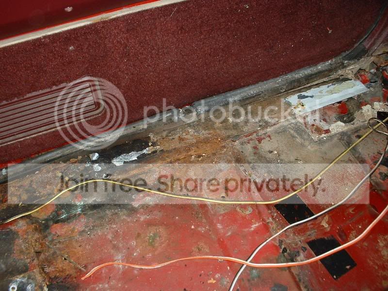

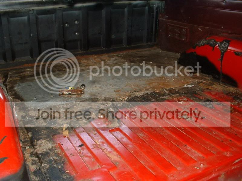

So I decided to tear up the carpet good thing to it was like a sponge all covered in mold not to mention I found this.

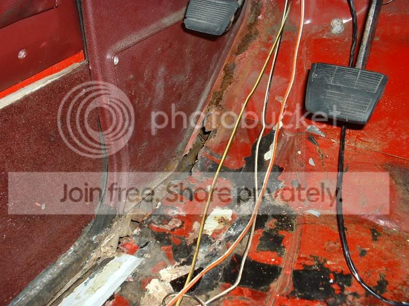

The passenger side isn't to horrible but there is a crack in the passenger seat mount.
This area is going to suck to patch

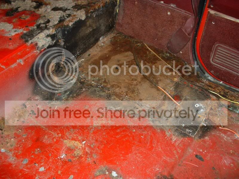

Who the hell uses tin to patch holes?

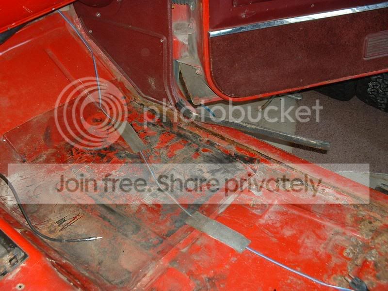

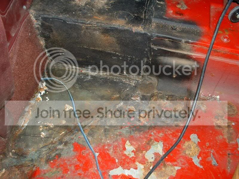

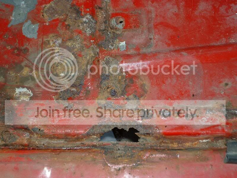

Some more of the PO handy work
Looks like I have my work cut out for me. any sugestions for the rust repair if I dont own a welder?
Current plans scrape all loose debris and clean the tub. Cut out what I can of the damaged areas. Zinc the remaining areas and patch the areas, then cover the entire tub with fiberglass and 6oz cloth then bed line it.
