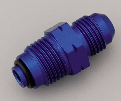

You can change to a -AN fitting adapter at the TBI and also at the fuel line on the frame and then high pressure fuel injection hose in between.
This fitting should be the one used at the TBI. Earls #991955ERL

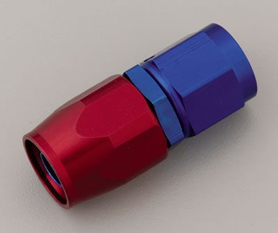

Ok, just went and checked and you would need Earls #9894DBJERL at the frame end.
You would need Earls #809106ERL off the TBI adapter.

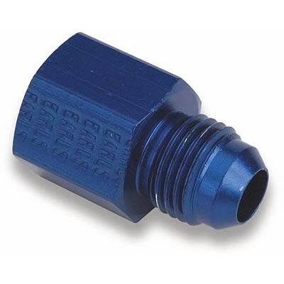

Then you would need Earls #800106ERL at the frame adapter.
Now you just need the proper length of -6 braided hose.
