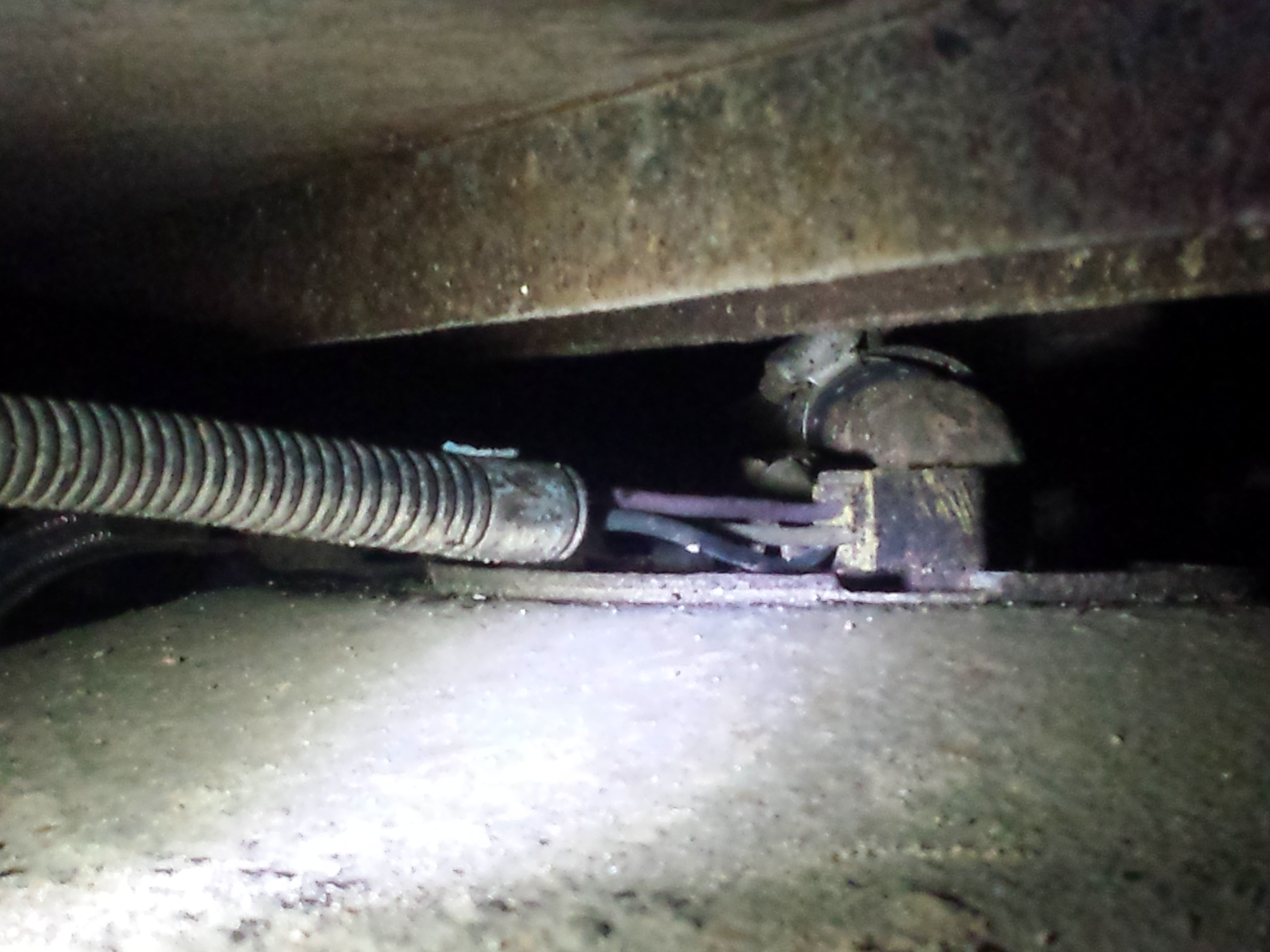

So what I just recently noticed by someone sending me a picture of there tank is my tank doesn't have a group wire coming from the sending unit i looked underneath and it got ripped out. So with it not being grounded why would it come on when I run a wire from the relay to the battery? I'm guessing I need a new sending unit now cause of the ground wire not being there.
I suspect the pump is grounded to the sending unit, and the sending unit ground wire is redundant....sending unit lock ring locks into the metal fitting on the fuel tank, so the sender is grounded to the tank. The tank is grounded through any portion of the metal strap that touches it, and the straps are bolted to the frame. That would make sense as to why it runs.
Obviously, with corrosion, that ground path could be compromised, so I can see GM running a redundant ground to ensure long-term function.
Will it run when it's bypassed? Cause u don't have the ground wire it broke off but when I bypass it through the fuel pump relay switch to the battery the pump kicks on but still not getting fuel
I didn't try bypassing it because i immediately saw the broken wire. I wouldn't think it would run without that ground. iirc the pump doesn't ground to the sending unit either. It has a plastic bushing at the intake end of the pump and the output on top is connected by the rubber hose. So there is no path for the pump to ground to the sending unit. So it will not ground correctly through the gas tank because it is not bolted to the frame. It is suspended on the straps which i use to have plastic strips between the strap and tank(no longer).
I would get your wires repaired first and see what happens.

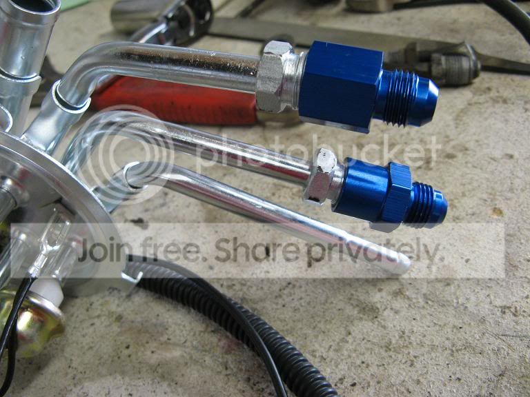

This is the top of my tank. Three wires. Fuel level, pump power and ground.
I don't know if there are differences, but this appears to be a TBI sender, the ground wire is clipped to the sender body
Correct on the straps though. AFAIK all of them used the felt-type material between the straps and tanks, pretty hard to get a ground through those. If the tank shifts over a bit though, the straps can contact the tank as the straps sit in a depression. Also forgot the top of the tank had insulating-type material where it contacts the frame crossmembers.
